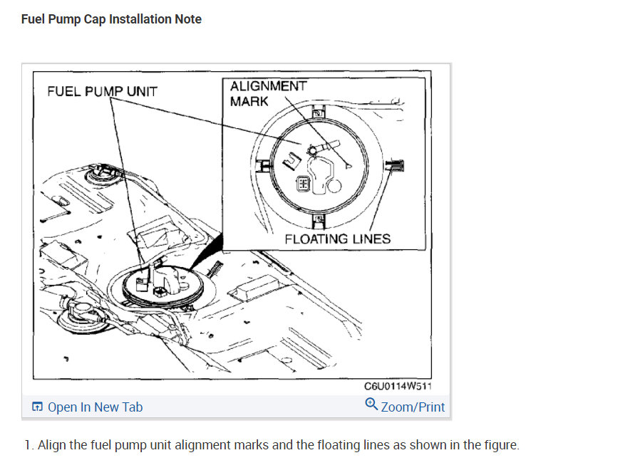

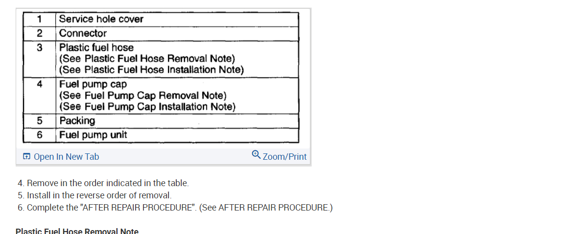

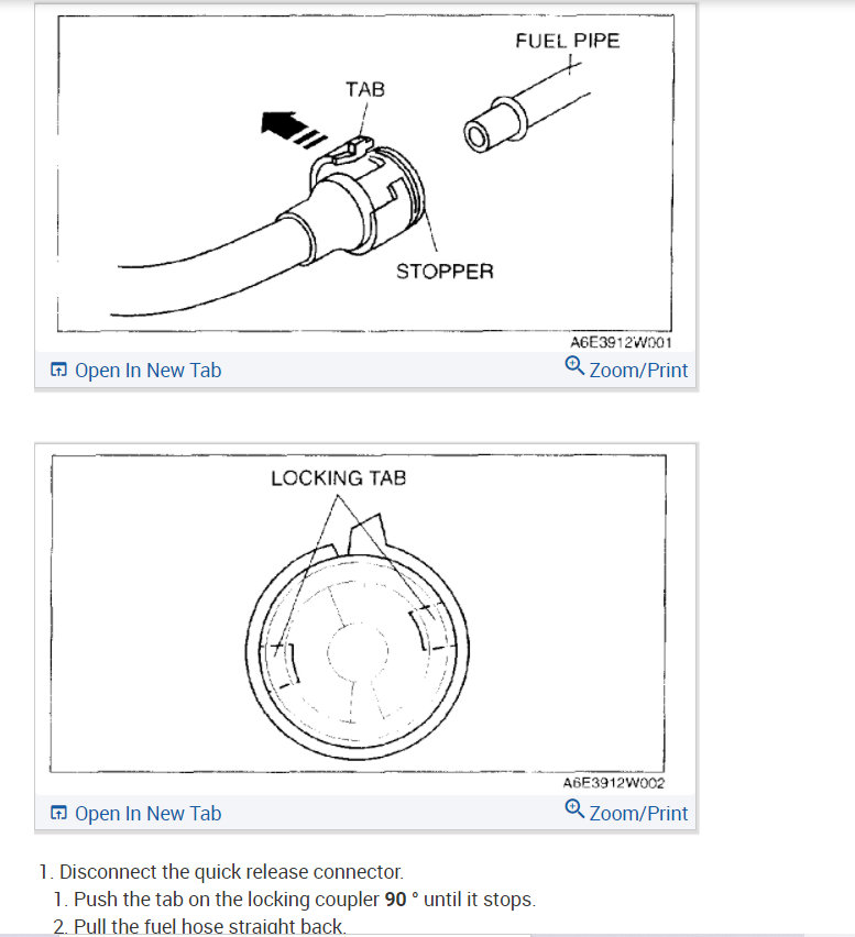

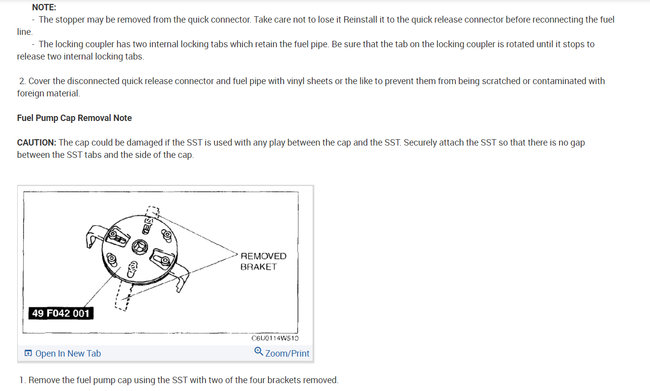

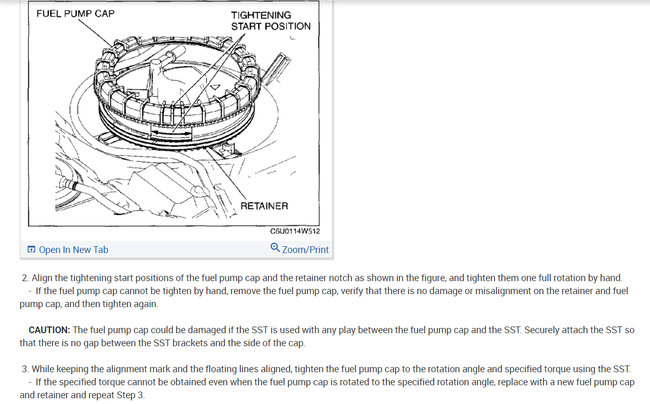

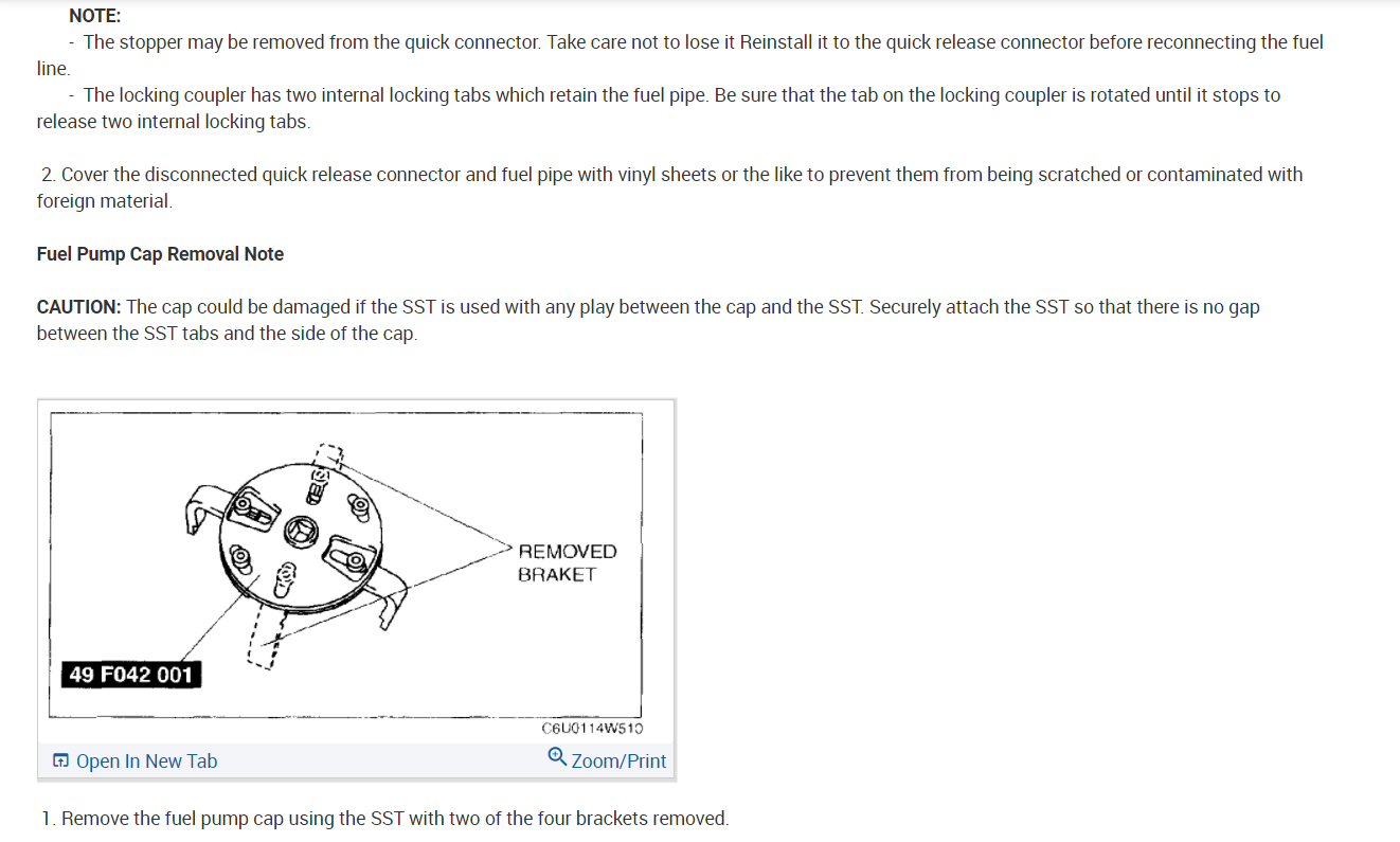

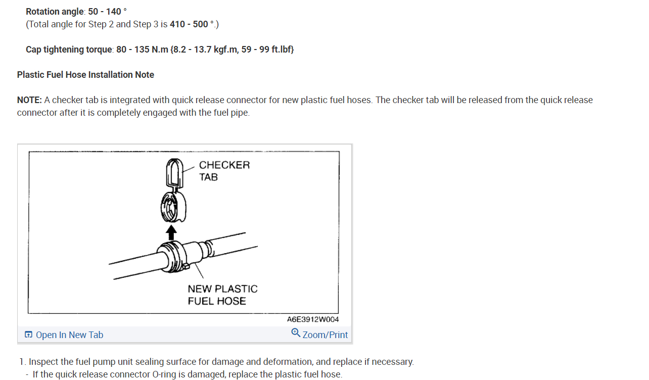

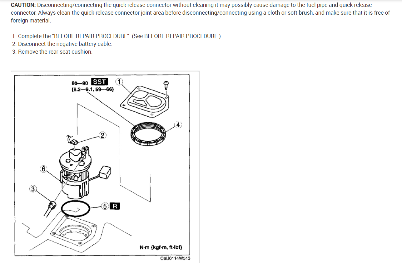

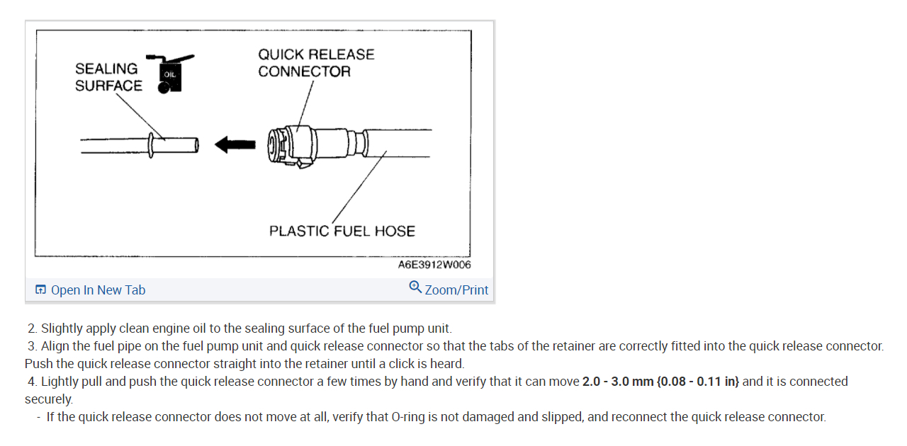

My theories were leaning towards catalytic converter, ignition coil packs, and/or fuel pump. The mechanic I took it to called and told me that he believes the entire throttle body is bad and that the Ignition coil packs could be playing a part as well. Before I throw any more money at parts for this thing I'd like to get some outside perspectives on the matter beforehand.
