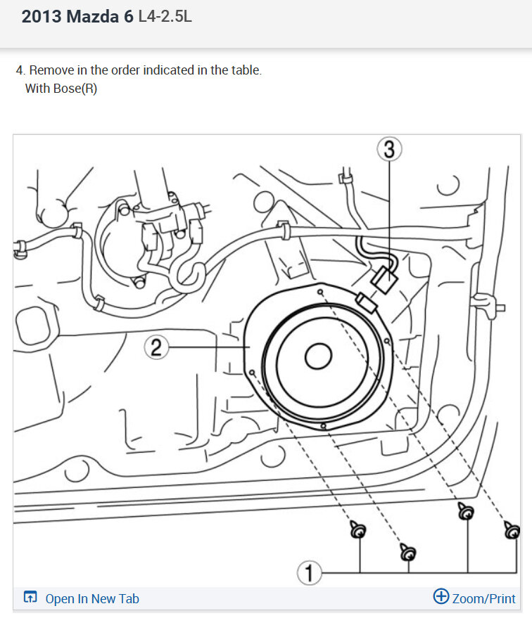

I recently purchased a second-hand vehicle listed above Touring with 118,000 km, and I've noticed a few issues after driving it for a while:
Left Speaker Issue: The left speaker makes a weird, muffled rattling sound when the bass hits in songs, regardless of the volume. A friend suggested it could be a loose wire causing the rattling when driving or from the bass vibrations.

We only handle one problem per thread. We will address the Left Speaker problem on this thread. When the speaker is making this noise, it is blown and needs replacement. Check out the images (below). Let us know if you need anything else.
