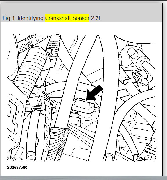

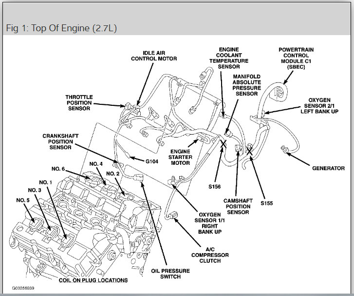

I have a Sebring 2003 v6 2.7 a swap the engine for a Sebring v6 2.7 2004. the engine crank but have no spark?

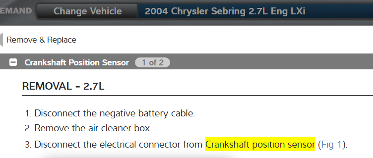

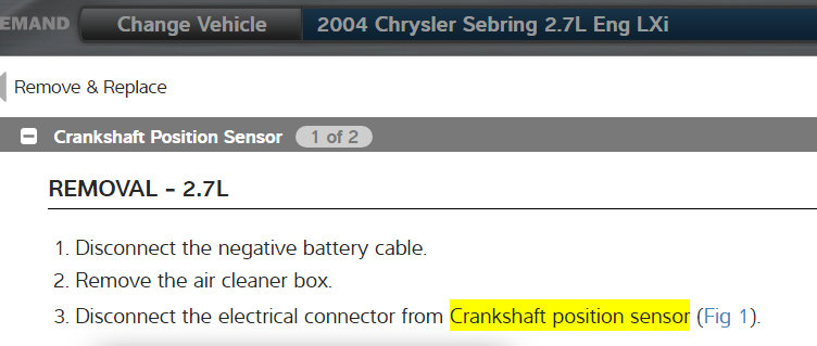

This could be a problem with your Vehicle's Crankshaft Position Sensor (CKP). I have included instructions on how to removal and installation as well as its location on the engine. I have also included a few links for you to go to down below.
https://www.2carpros.com/articles/how-a-crank-shaft-angle-sensor-works
Please go through these guides and get back to us with what you find out.
