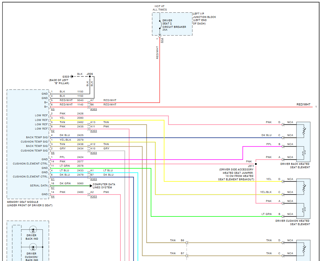

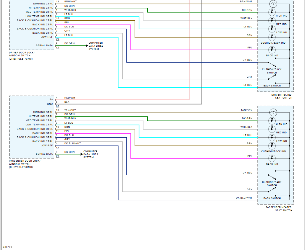

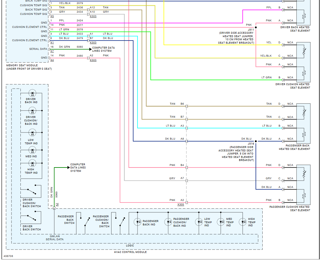

My other question is whether you are able to provide seat connector pinout diagrams. I believe I need the diagrams for connectors X303 and X305, which were shown in the images you provided. I want to make sure that I connect the seat belt buckle switch, passenger presence sensor, and seat position sensor correctly.
In both my 2013 Avalanche and the 2010 Yukon, the GM P/N 13579116 module is the same and uses two yellow connectors. I traced the non-power wires from the seat connectors in the 2010 Yukon harness and found that several of them go to the 13579116 module. I would like to make sure that I connect those wires to the correct locations in my 2013 Avalanche.

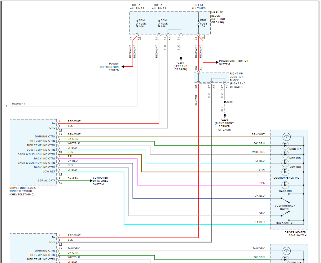

Okay, they don't give us the pin outs in AllData, but I did give you the seat wiring diagram above. Let me know if you need more and how it goes.

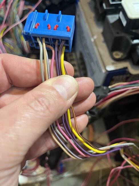

On Yukon 2010 harness there is blue connector that connects to power box under dash, the wires from that circuit run into driver seat... 2013 truck does not have blue connector in power box under dash on driver side. Is there way you can find what that blue connector used for in Yukon 2010? I suspect pedal position.
Thanks
Jul 3, 2026 at 12:18 PM
  • 55,433 POSTS
Can you upload an image of the connector and the wiring so I can see it?
Jul 4, 2026 at 7:20 AM
CHURSIN
  • 12 POSTS

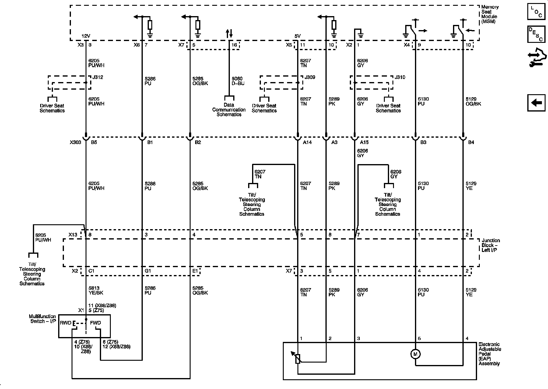

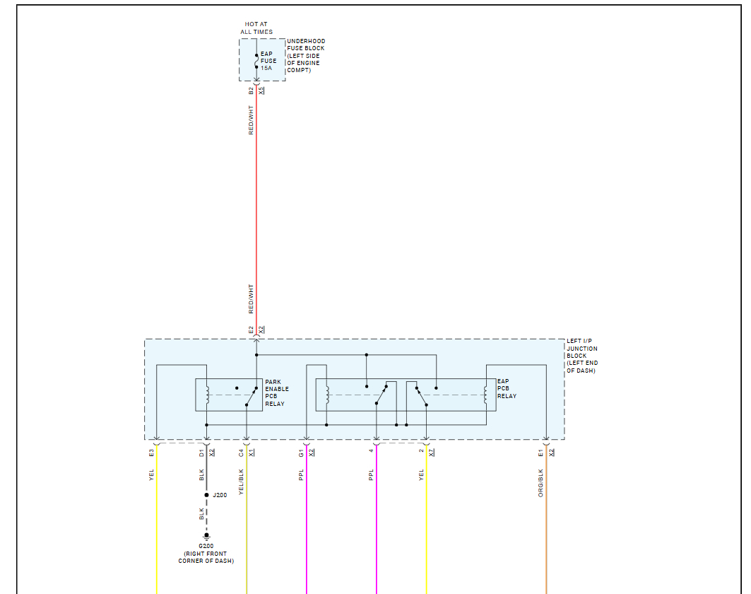

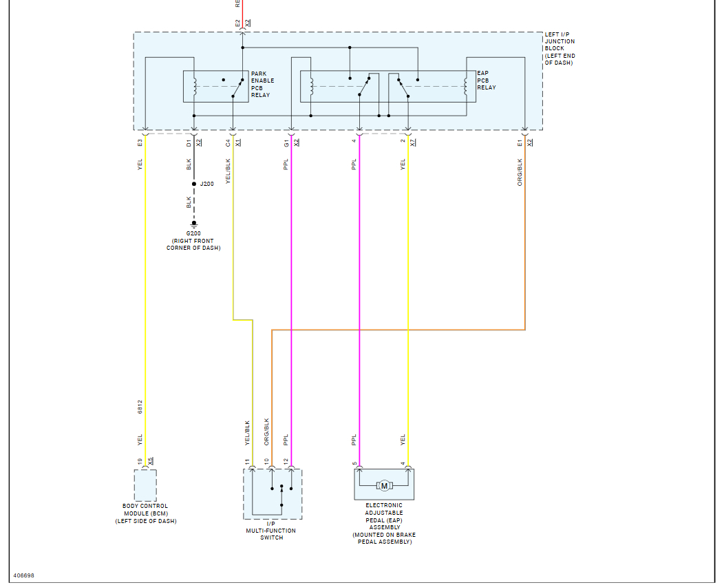

I have made some progress and plan to add a write-up once I am finished. The blue connector is X13 (Junction Block - Left I/P X13 (JF4 with AN3)). The challenge is that, in the Avalanche, the junction block has only one pin in the X13 connector. I am pretty sure I will need to replace the junction block with one from a donor vehicle.
Does AllData have wiring diagrams for the Adjustable Pedal system both with and without the AN3 option?

Here is the wiring diagrams you needed for the adjustable pedals.

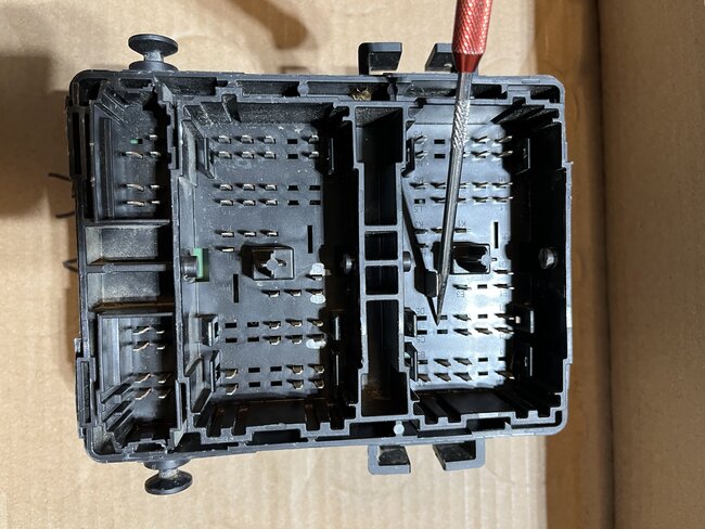

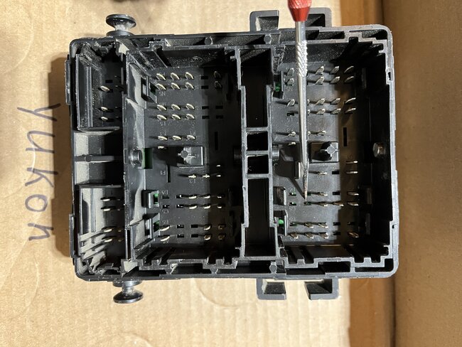

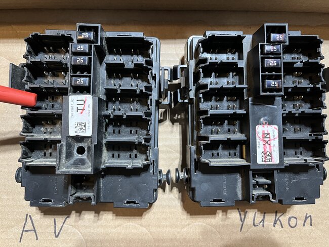

The common error I keep finding in all diagrams is - pin C4 connector X1 should be X2 pin C1. On both X1 and X2 the pin C4 is not used at all, it is not on Junction block at all. I am adding images of both Junction blocks and blue connector I was talking about in earlier messages. The image with red maker show X13 connector that only had pin 8. And the other images show that C4 pin is absent in X1 and X2 connectors on Junction block.

The only two connectors that I had to splice were X12 pin 7 because I have UVC back up camera and adding seat harness added KB6 option (part of circuit 239). Later I realized I did not really need it because circuit 239 goes to X305 pin A4 and is not used on seat side of connector.
The other one is fuse 25 circuit 1140 in fuse block on driver side connector X2 B7. Fuse 25 is remote entry module and driver seat module power which goes to driver seat connector X303 pin B6. That is the recommendation to active module provided at www.oemcarandtruckseats.com/blogs/knowledge-base/92612615-2007-2014-nnbs-chevy-gm-seat-swap-memory-bypass-heat-setup .
I added Brake and Accelerator Pedal Adjuster Position Sensor to complete circuit for X7 pins 1,3,5 (see BlueX13Connecor picture).
Replaced mirrors, Junction Left block. I did not blindly replace Junction block, I compared circuits and reviewed the differences to make sure all connections work. The main addition was extra pins for X13 connector for power pedal control (i.e. adding AN3 option).

Need to clarify this "I added Brake and Accelerator Pedal Adjuster Position Sensor to complete circuit for X7 pins 1,3,5 (see BlueX13Connecor picture)." I thought the image name would be preserved, the image I was talking about is the diagram image showing Electronic Adjustable Pedal(EAP) Assembly.
