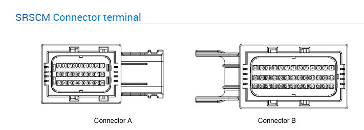

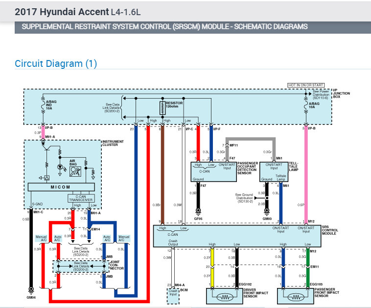

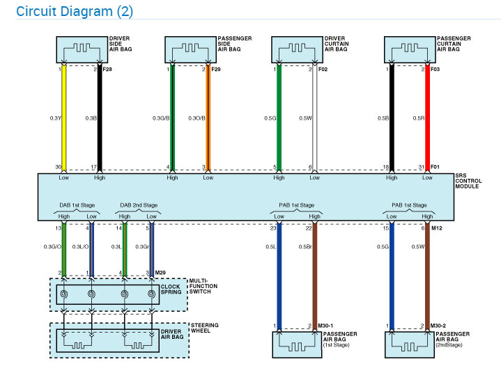

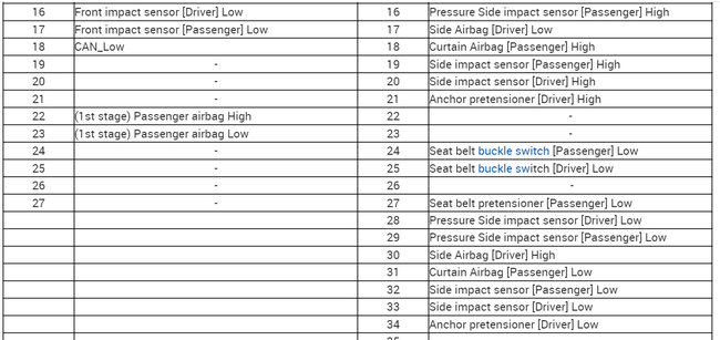

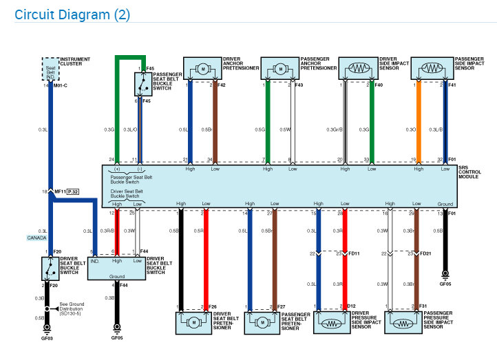

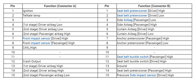

Hi, would you have a wiring diagram for the 2017 seat belt warning chime? I have your 2000 accent diagram but I'm not sure if it has changed.
Thanks. Phil
Jan 18, 2023 at 10:57 PM
  • 110,251 POSTS
I attached the supplemental restraint system wiring schematics below. They include the seat belt buckle wiring as well.
Take a look through them and let me know if they help.
See pics.
