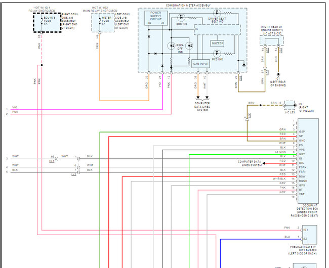

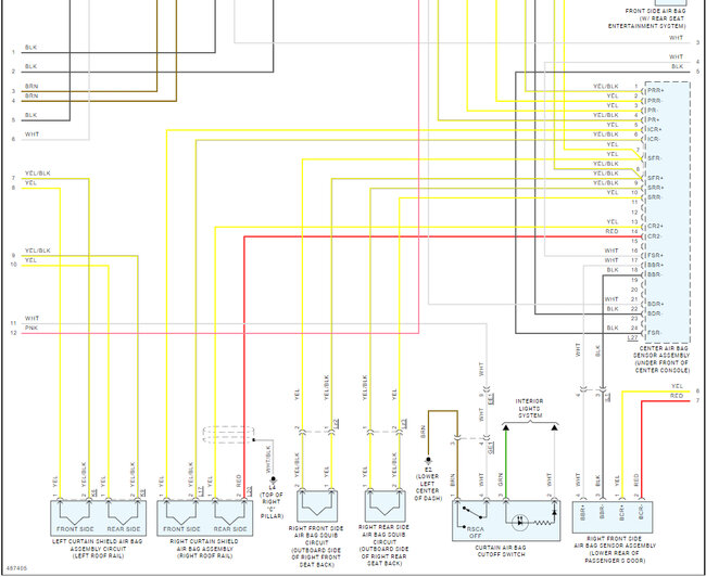

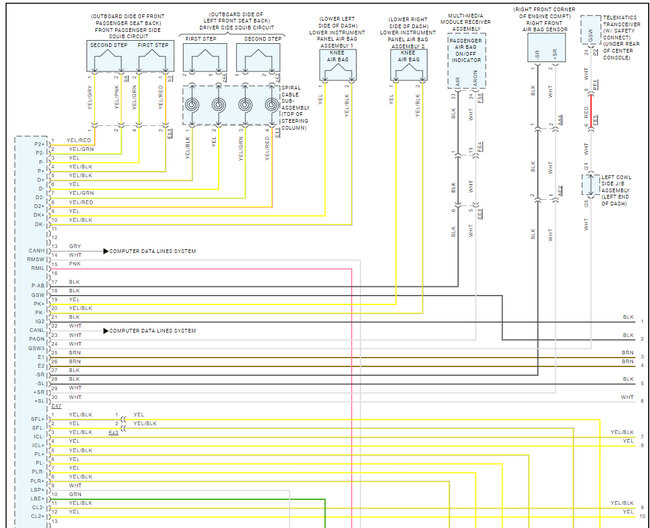

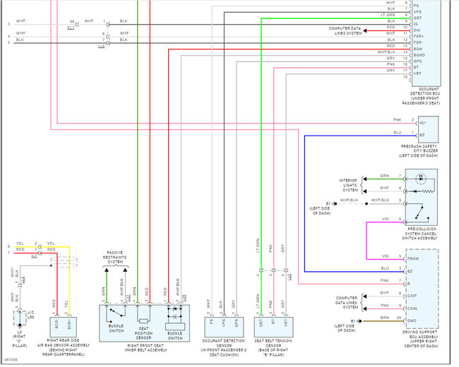

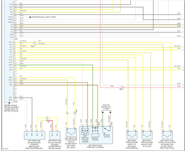

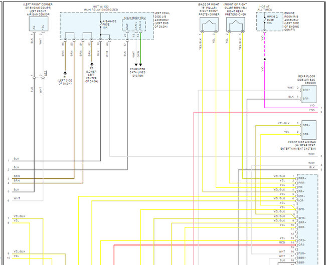

Can you help with the circuit diagram for Toyota Prado and Hilux. I want to pick the signal responsible for the Alarm on and off when seat belt is buckled or otherwise.

Here are the wiring diagrams for the seat belt system you have requested. Check out the images (below). Let us know if you need anything else.
