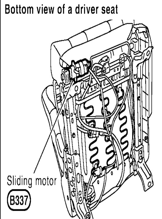

Yep, you can hear the drive shaft/cable skipping which drives the gear on the opposite side of the seat. You will need to remove the seat and take apart the drive system to see what is broken and replaced it, I would look on ebay for replacement parts. Thanks for the video it helps. Check out the images (below). Please upload an image or a short video in your response of the problem, so I can see what's going on. Ken

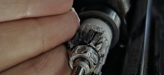

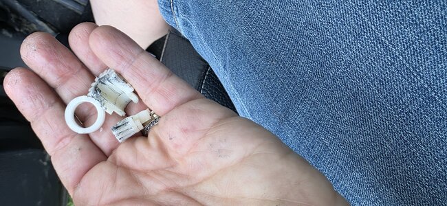

Well.. the problem is definitive.. I think whoever recovered the seat before we bought the car boogered the washer, pushing the motor out of alignment. I wish I had just ordered the part or gone to the pull-it yard in town before I took everything apart, but here we are.I got the part ordered off Ebay. It should be here in a couple of days. I'll put the car mostly back together until it gets here. Don't tell my husband! Just kidding. He already knows.. He honestly doesn't care. He's just happy to have a wife that's also his mechanic.

Yep, you found it! Thanks for letting us know and the images, we are here to help, please use 2CarPros anytime.
