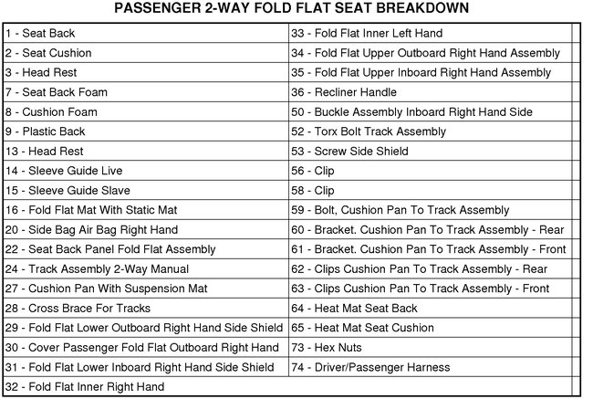

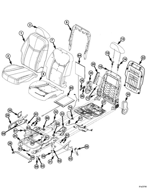

MECHTRIX
  • 591 POSTS
Heres 1 diagram and 1 parts list for the diagram I'm not sure but its think number 24 is the manual adjuster to move the tracks ..to check it out please click below good luck
