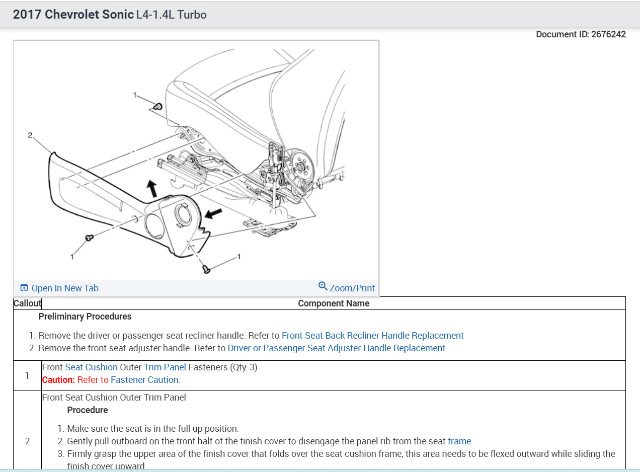

Can you please give me instructions on how to replace the power seat switch on the driver's side for the car listed above? I can't find anything online. Thank you, guys, so much!

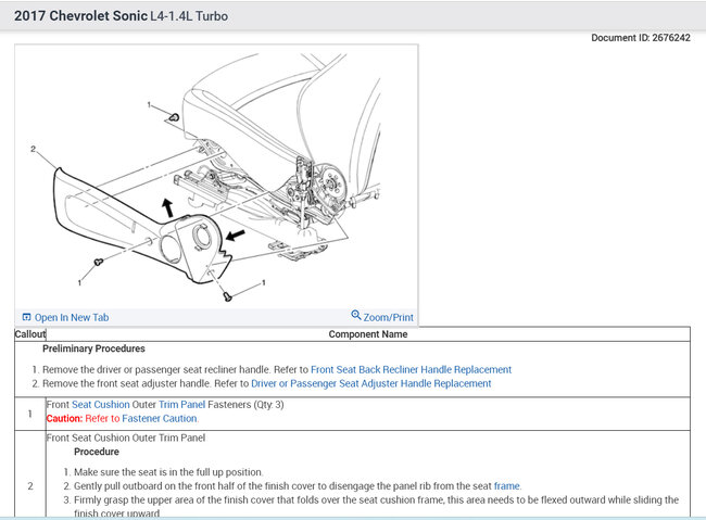

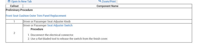

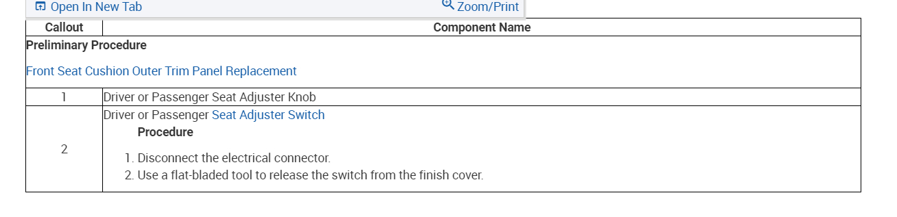

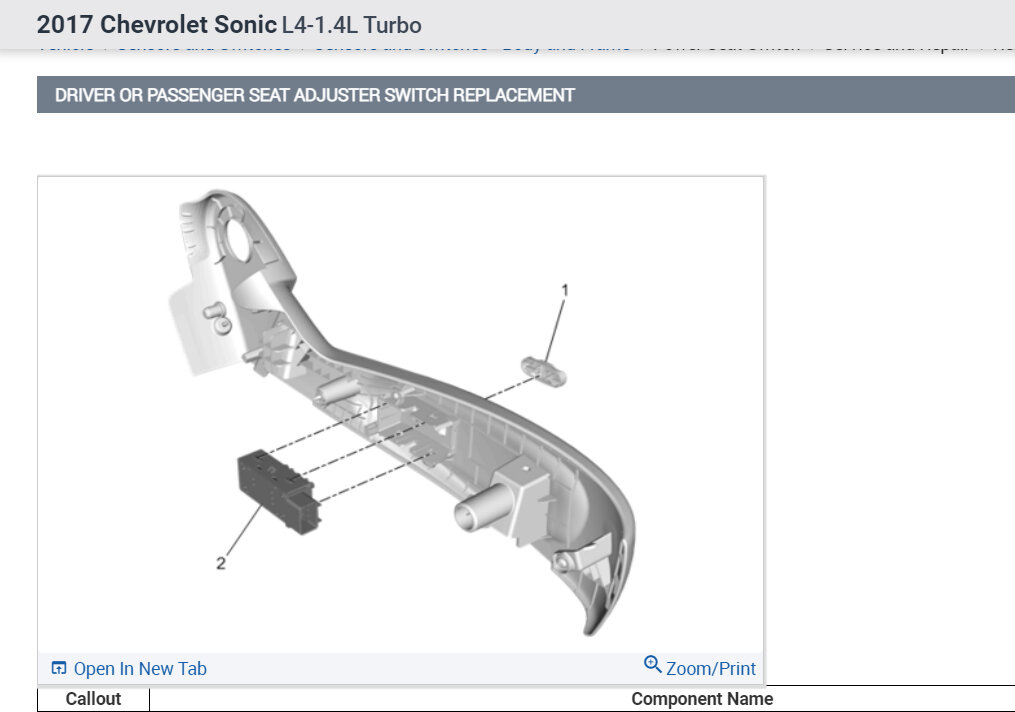

Sure, here are the instructions on how to replace the seat switch for the driver's side. Check out the images (below). Please let us know if you need anything else to get the problem fixed.
