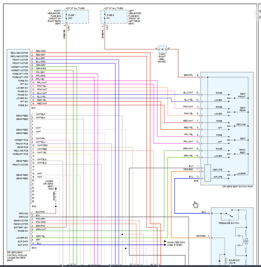

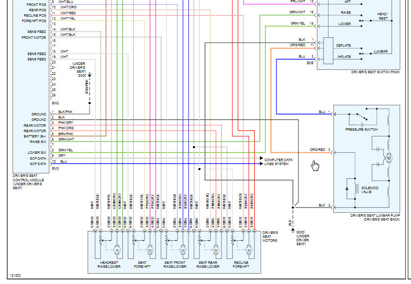

My driver seat does not auto adjust. Steering wheel does fine. I tried on all 3 setting options.
Where can i look to fix?
Jan 11, 2021 at 4:22 AM

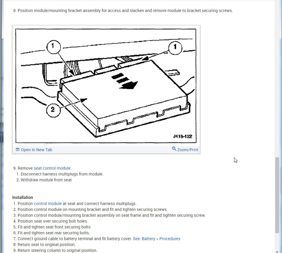

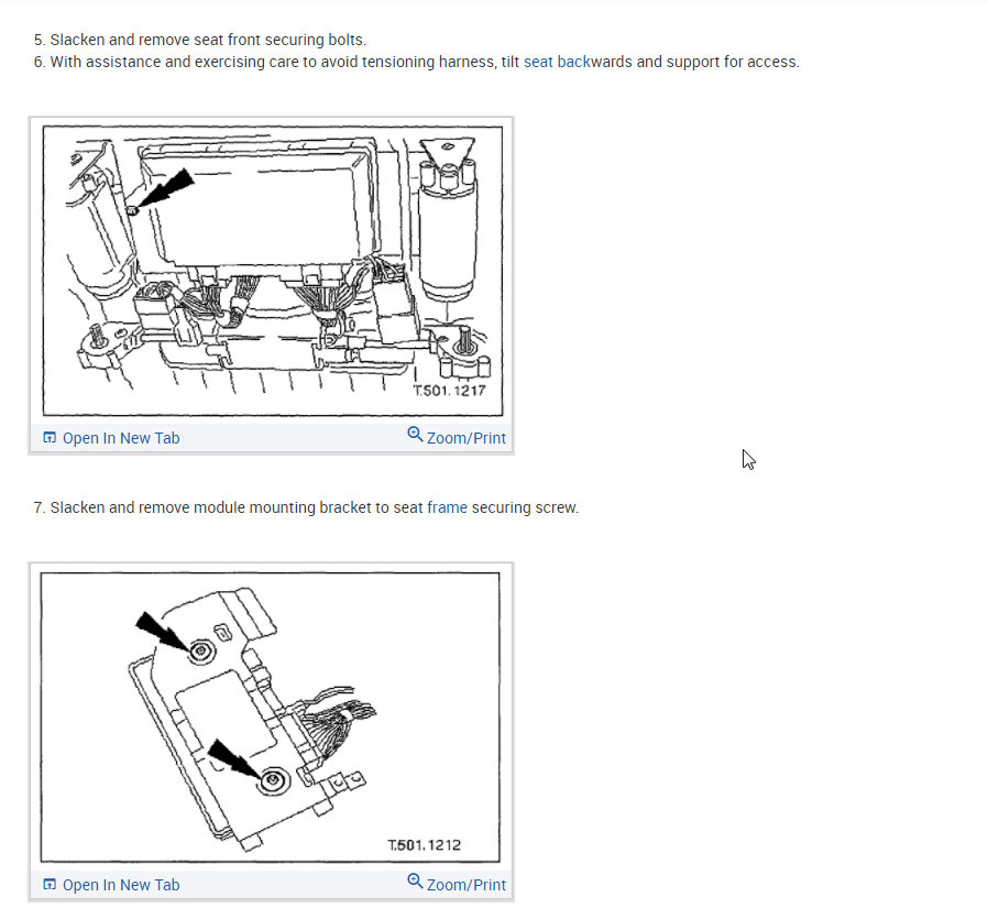

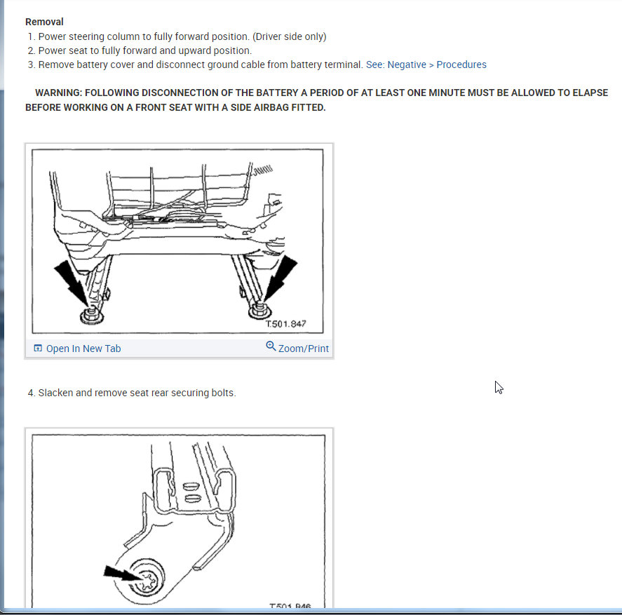

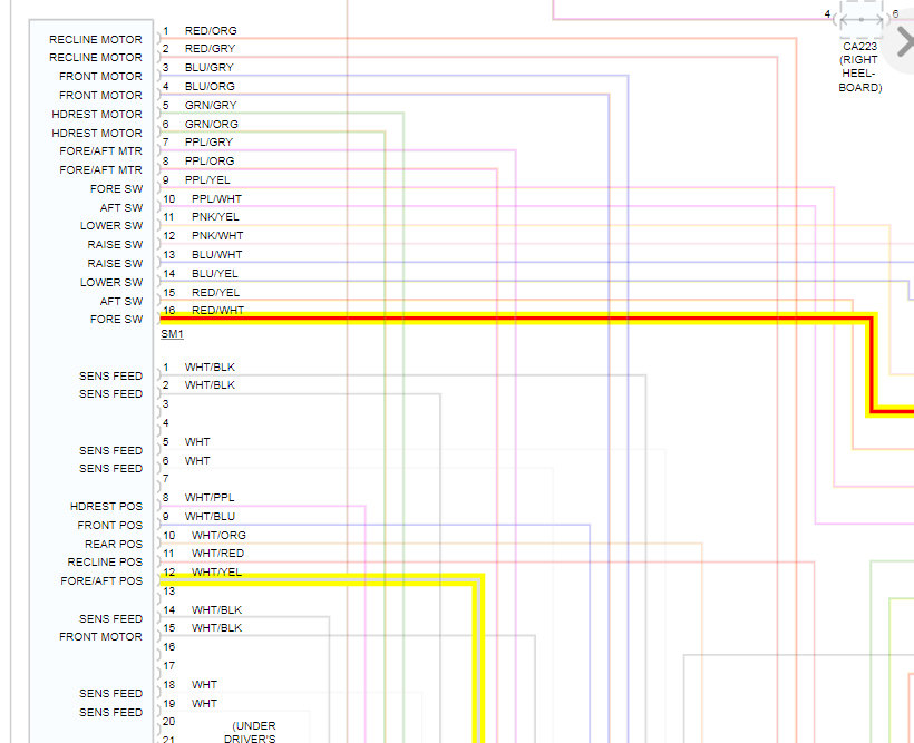

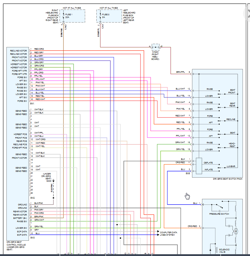

More then likely this is the driver seat control module that has failed. The way to confirm this is to check the voltage coming out of the module when the seat is being moved. If you have no voltage then we need to check voltage coming from the switch. I included the wiring diagram so we can perform this testing.

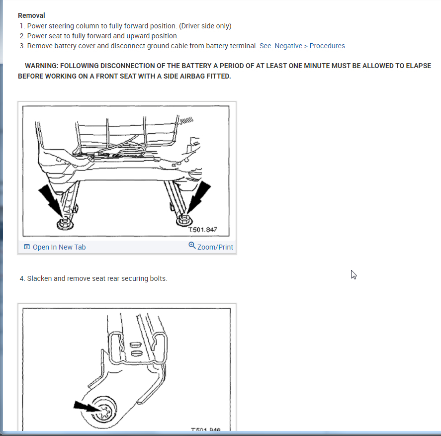

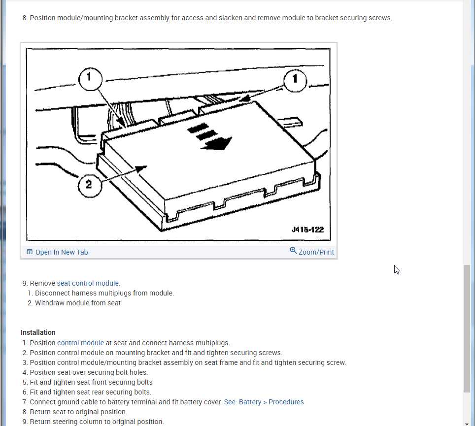

Here is a guide that will help with this:
If you have voltage coming in on the red/white wire when moving the seat forward and none on the white/yellow wire then the module is the issue.
Since this is the auto adjust I am pretty sure that this is the issue so I included the process on how to replace it if this proves out. Let me know what questions you have. Thanks
