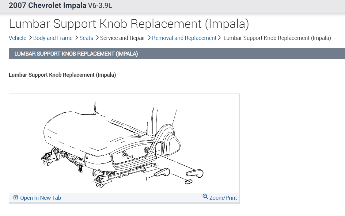

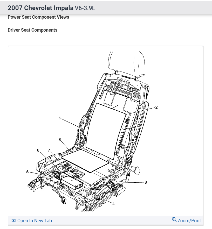

Drivers side manual lumbar handle won’t release lumbar stuck in full inflate position. How to get it to release?
Jul 31, 2022 at 7:05 AM
  • 55,849 POSTS

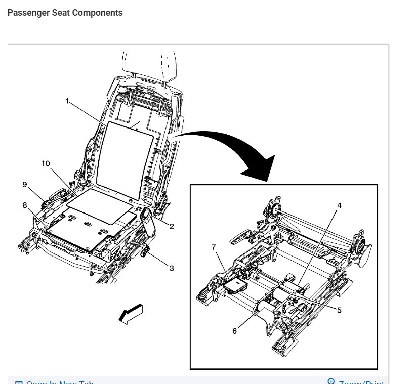

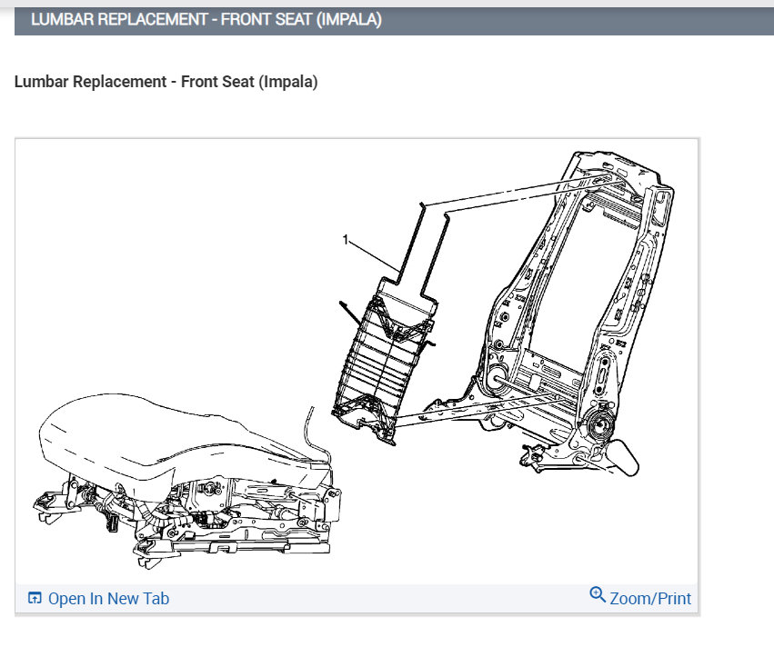

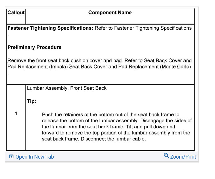

It is more like a cable and an adjuster level. Have you tried releasing the lumber without sitting in the seat? This may help, also here is how the lumber works so you can see what's going on in the diagrams below. Check out the diagrams (below). Let us know what happens and please upload pictures or videos of the problem.

The bladder must be over extended and not able to be adjusted, I would remove the seat and disable per the instructions to see what happens and what is stuck not allowing the adjustment to comes back. You can put the seat on a work bench so it is easier to work on.
