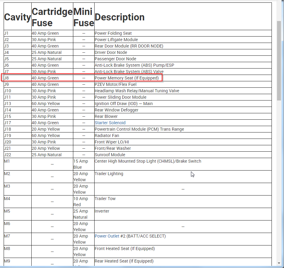

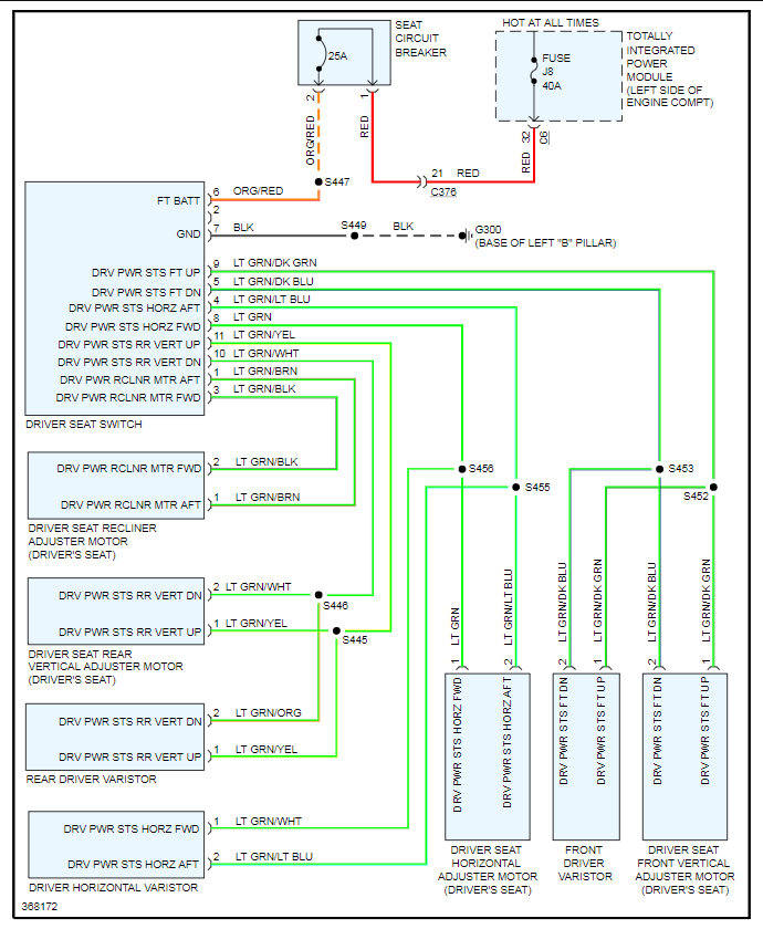

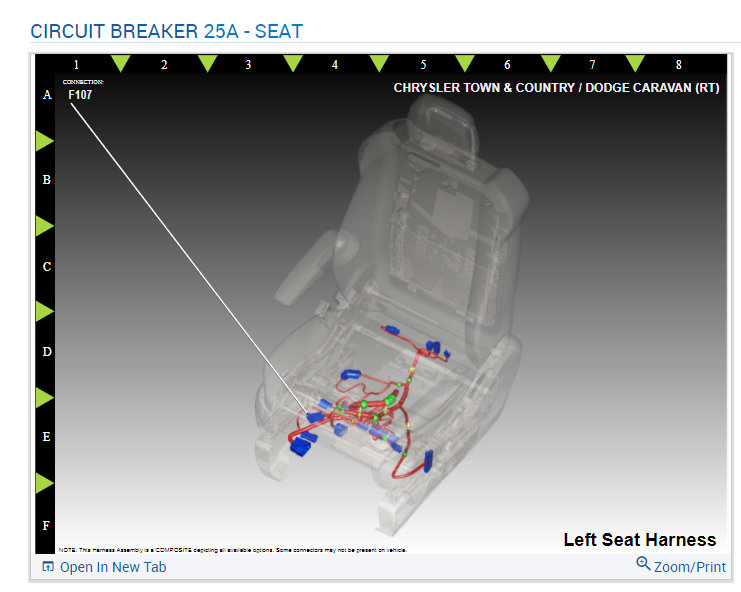

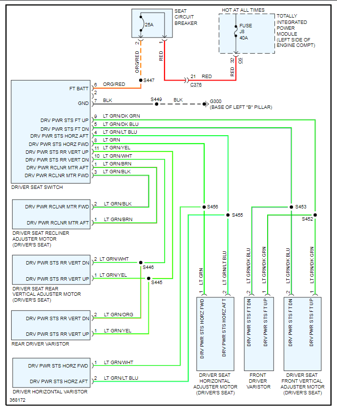

which fuse is for the powered driver seat? non heated cloth seat.
Dec 19, 2020 at 12:55 AM

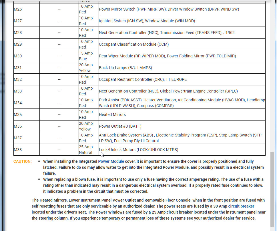

You have an overall fuse in the TIPM but also there is a circuit breaker on the seat underneath. Take a look at all the attachments below for more detail.
Let us know if you have other questions. Thanks
