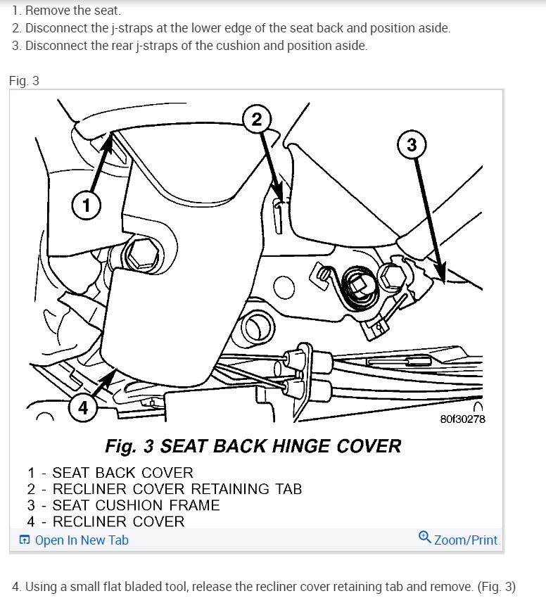

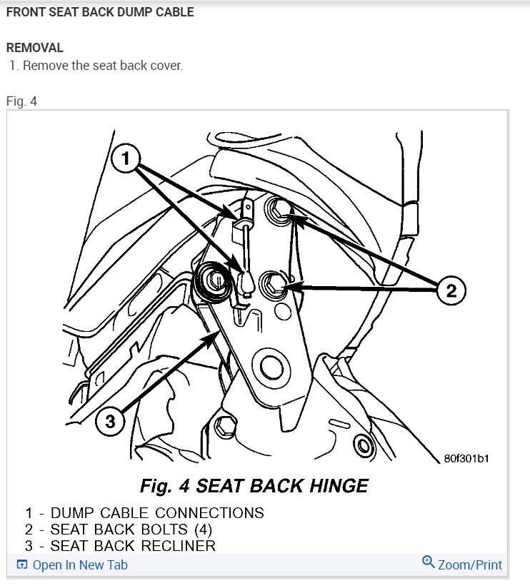

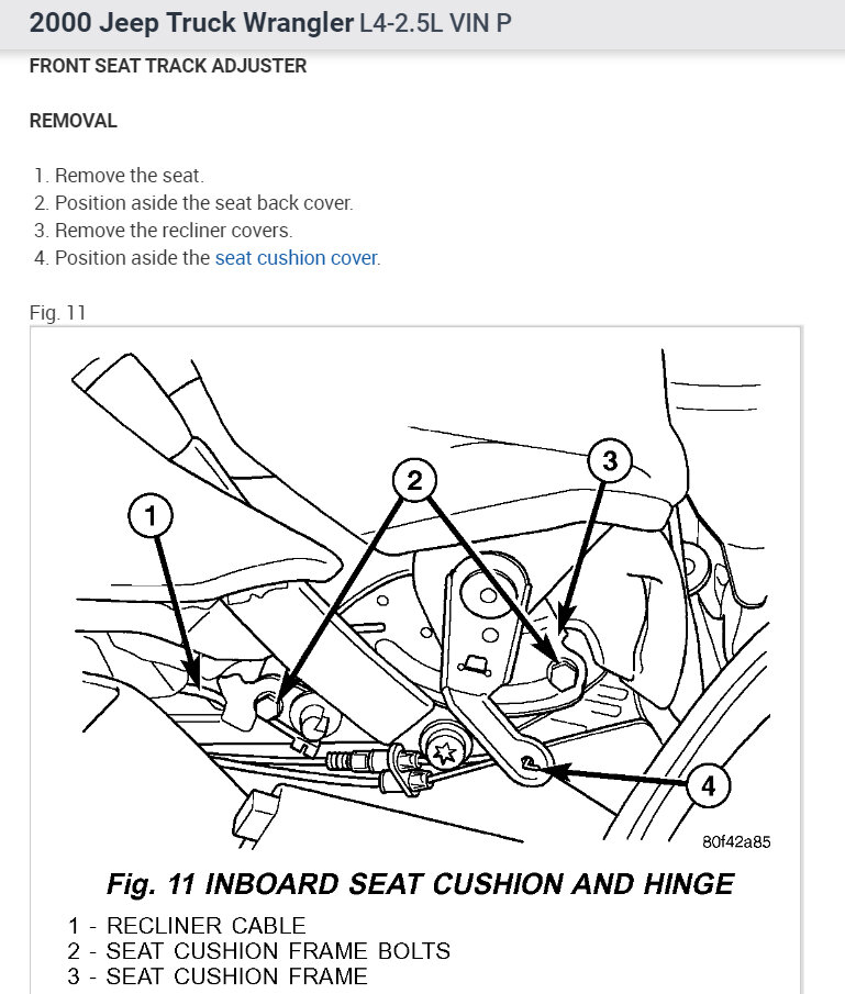

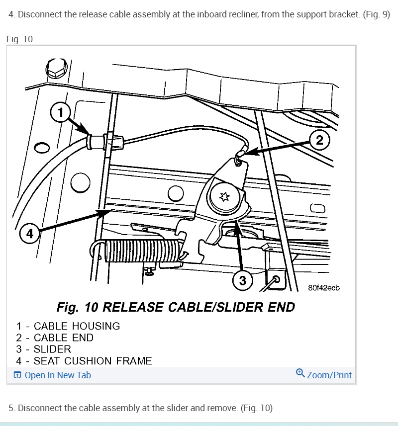

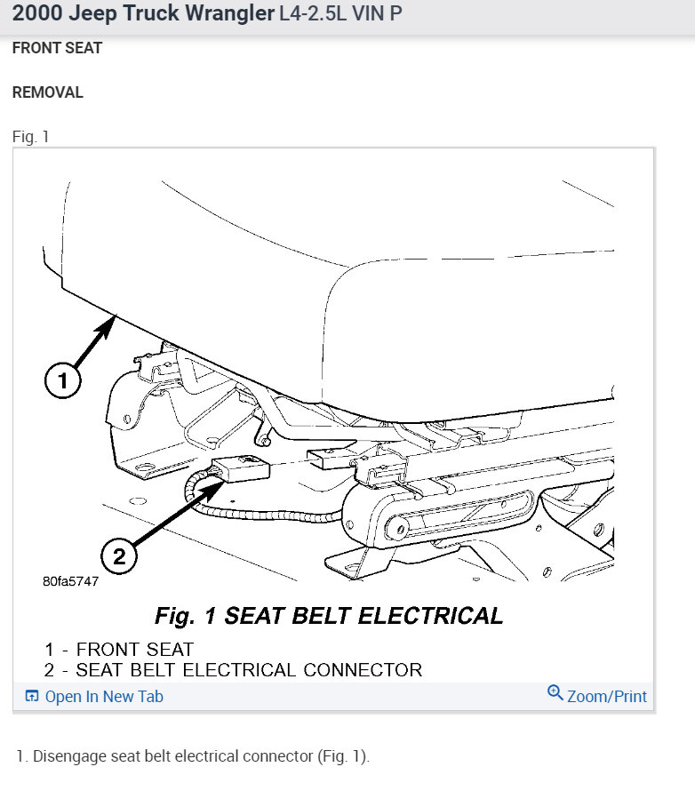

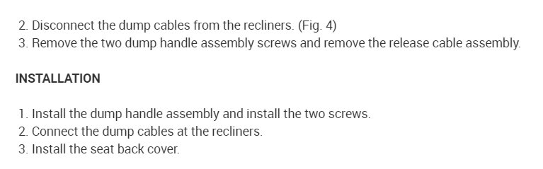

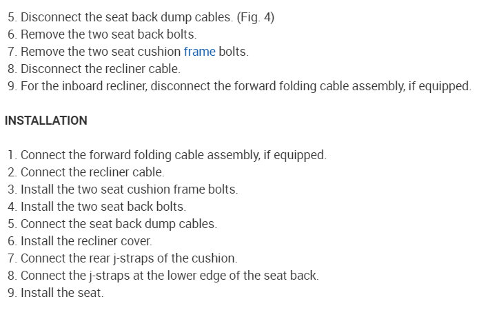

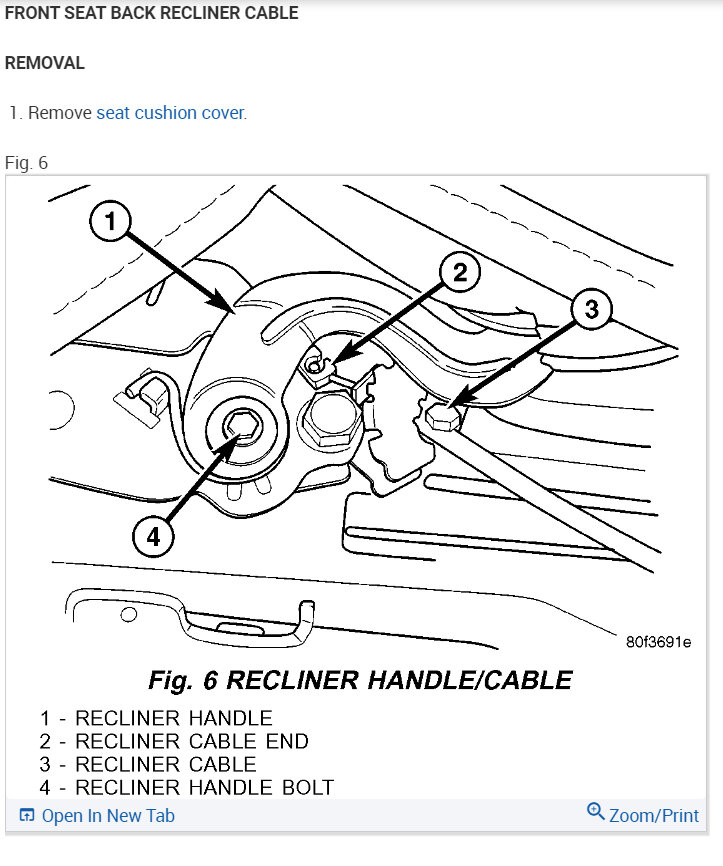

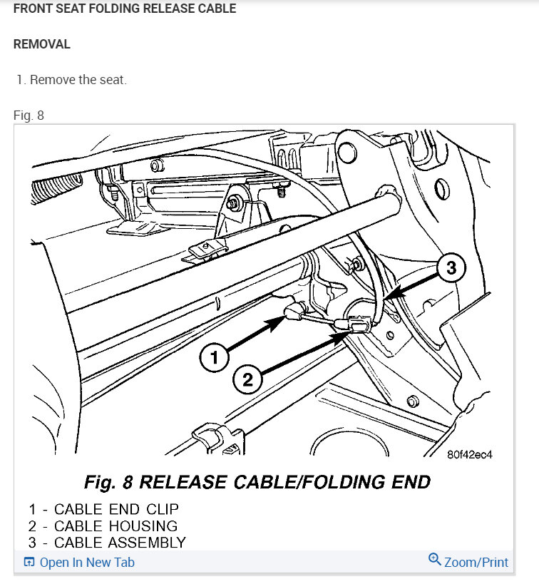

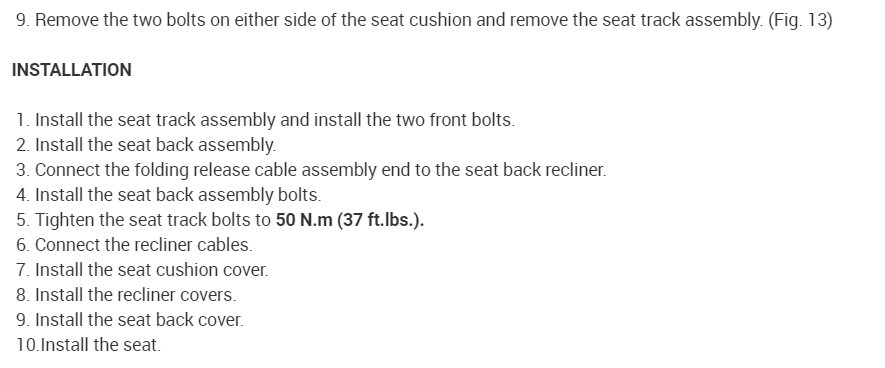

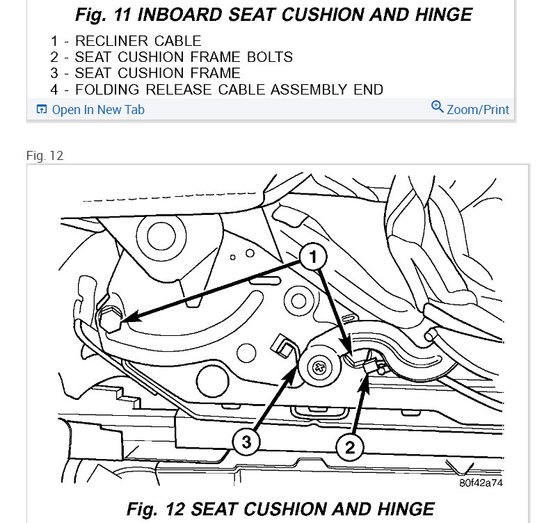

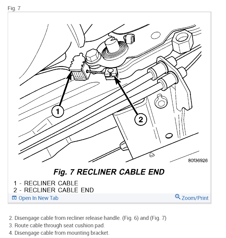

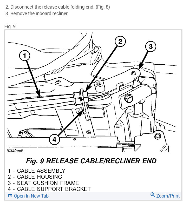

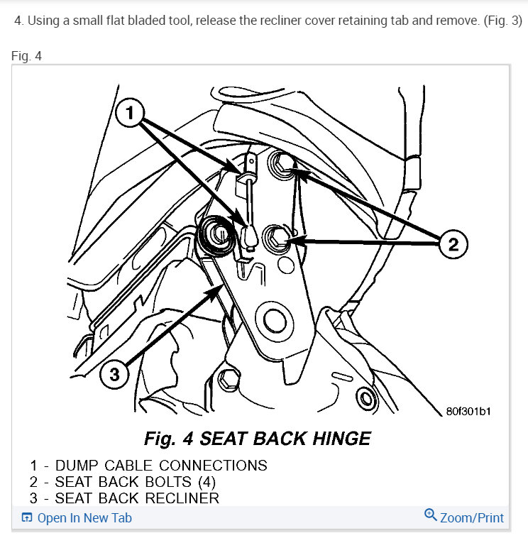

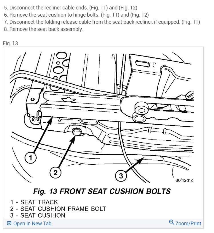

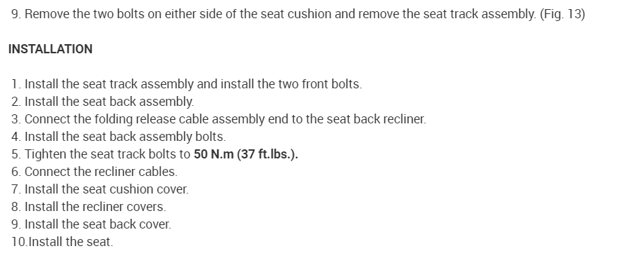

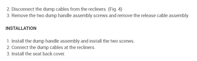

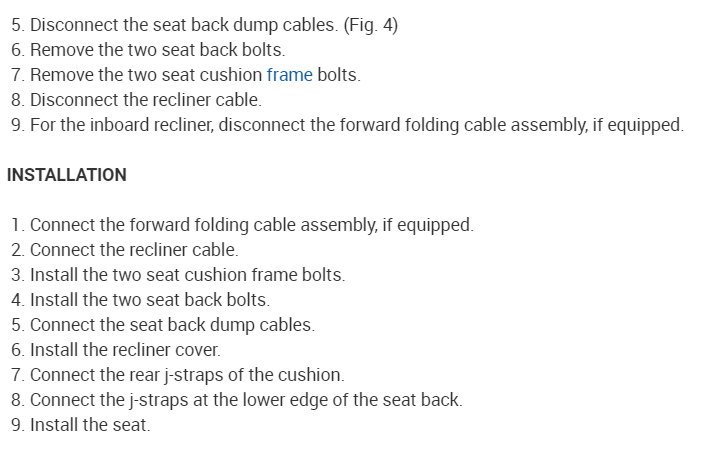

I removed the seats and had them recovered. I went to reinstall and was not sure had to reconnect the cable under the bottom. Sorry to ask, but I guess I'm getting too old to do these things.

Yep, there are more cables than I thought, here are all the seat cables and their locations. Check out the images (below). Please let us know if you need anything else to get the problem fixed.
