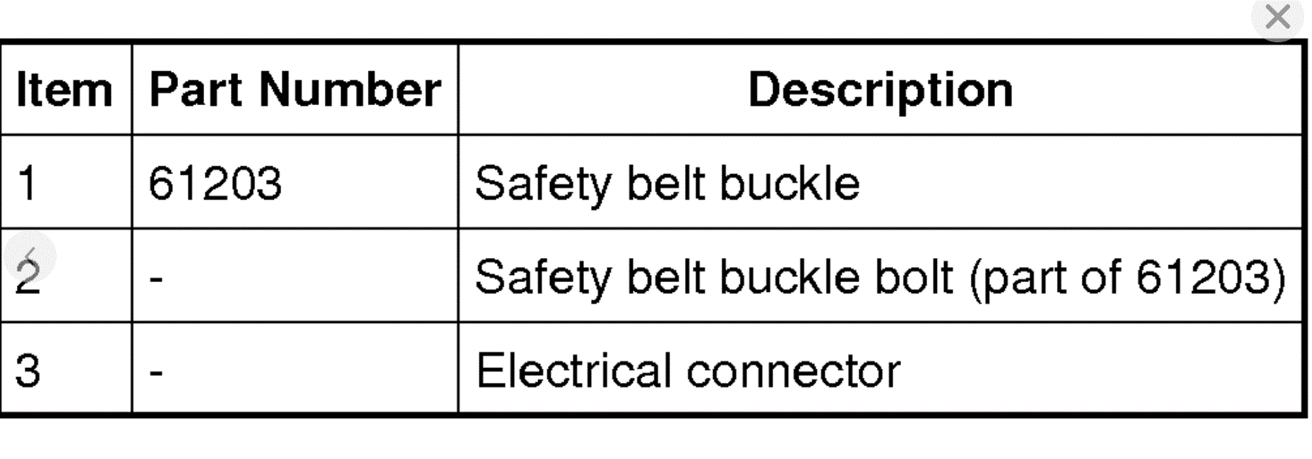

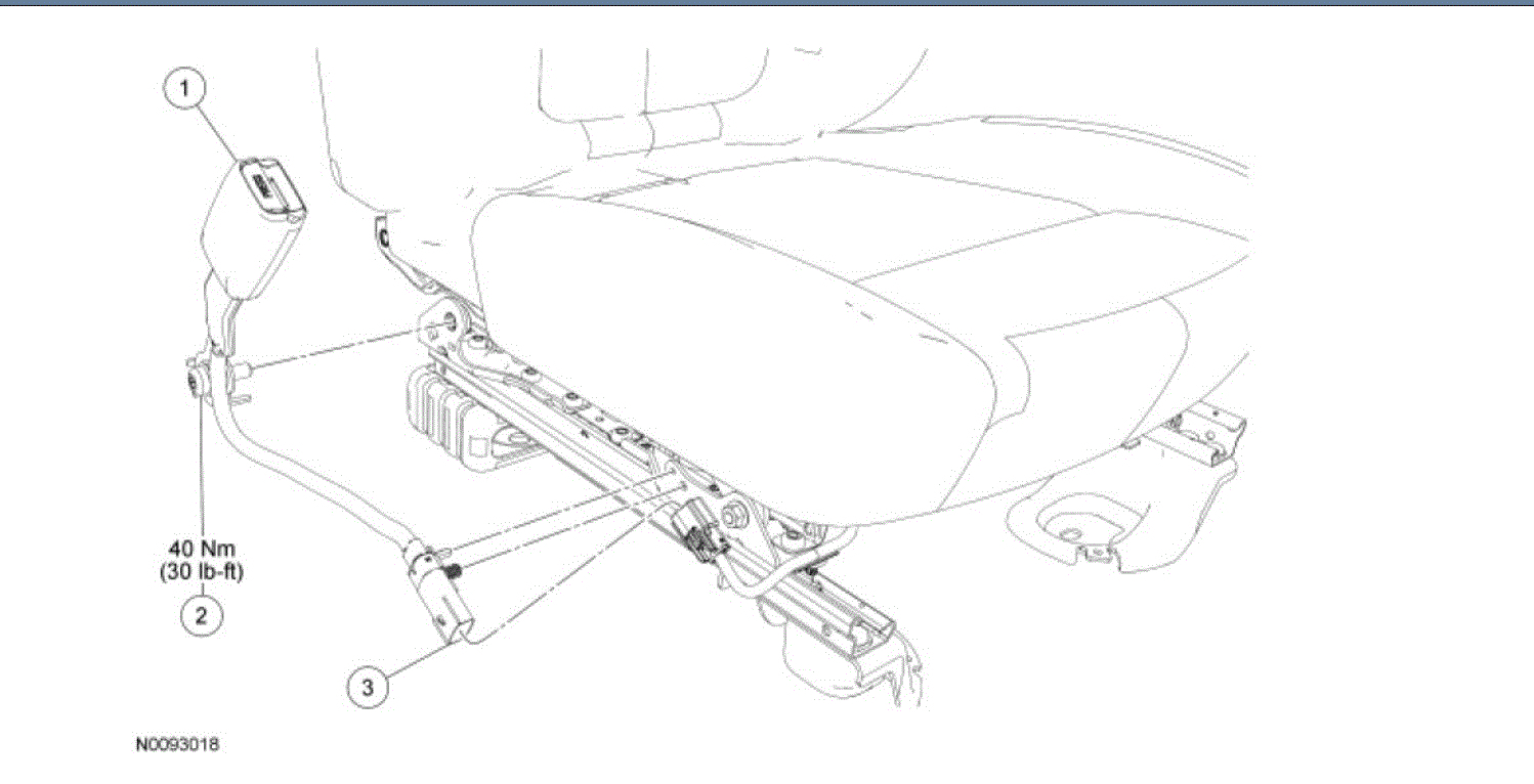

The receiver end of my seat belt assembly will just stay down when inserting the buckle. I can use a screwdriver to disengage and free the button, but every time the buckle goes in there it will stick. I've tried wd-40, brake cleaner, shop air, etc.
If I have to replace the receiver, do I need to replace the belt along with it?
Mar 21, 2020 at 7:07 PM
  • 110,194 POSTS
As long as you get the correct receiver, the belt should be fine. There really isn't much to go bad. Here are directions for replacing it. The attached pics correlate with the directions. Please confirm that the replacement receiver is the same as what you already have. I would recommend a dealership for a new one because it is a safety item. If you get one from a salvage yard, just make sure it's the same.

pic 1
pic 2

1. Remove the seat. For additional information, refer to Seating See: Seats > Removal and Replacement > Seat - Front.
2. Disconnect the electrical connector and detach the wiring harness pin-type retainer.
3. Remove the bolt and safety belt buckle.
- If equipped, pull the safety belt buckle through the seat cushion trim located on the side of the seat.
- To install, tighten to 40 Nm (30 lb-ft).
4. NOTE: Before installation, make sure the safety belt webbing is not twisted and the safety belts and buckles are accessible to the occupants.
To install, reverse the removal procedure.
5. Install the seat.
- For passenger seat, carry out the Occupant Classification Sensor (OCS) System Reset. For additional information, refer to the General Procedures portion of Supplemental Restraint System See: Air Bag Systems > Programming and Relearning > Occupant Classification Sensor (OCS) System Reset.
6. Check the active restraint system for correct operation. For additional information, refer to the appropriate Functional Test procedure in Safety Belt System See: Seat Belt Systems > Initial Inspection and Diagnostic Overview > Principles of Operation.
