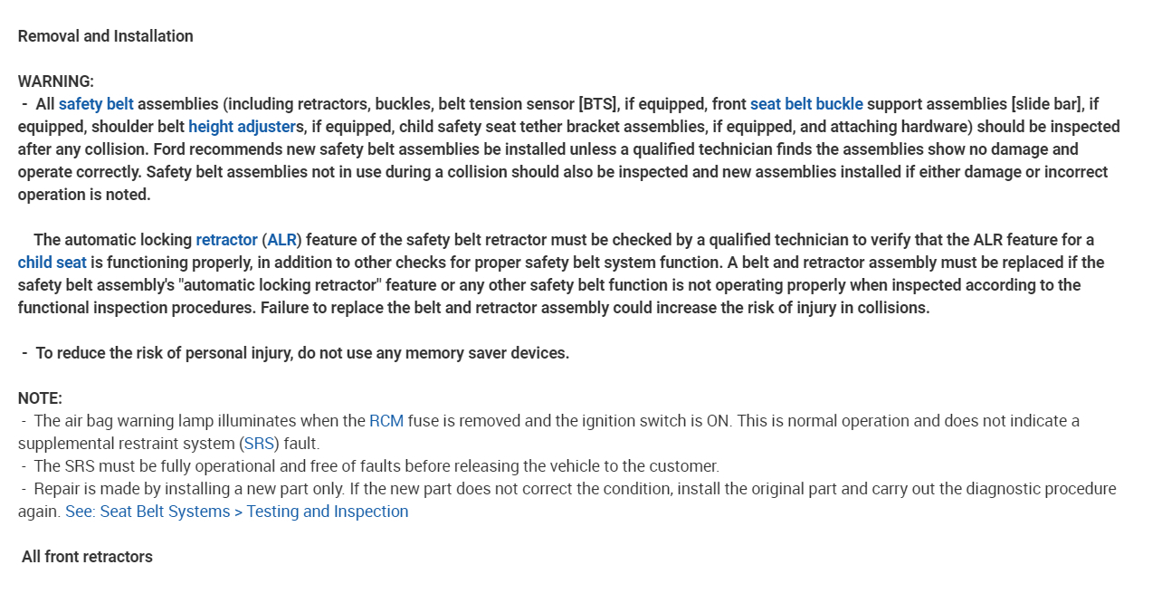

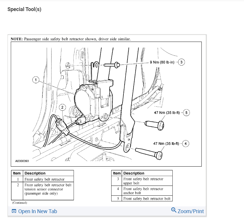

Hi friends, my poor vehicle was recently stolen and thankfully I was able to get it back but not without damage. The thieves sliced the passenger seat belt in half and cut a portion of wire that resulted in the airbag light on the instrument panel to remain on all the time. I'm a recent widow, financially challenged and having the worst year and a half of my life and I am hoping I can repair these myself. I'm pretty sure I already know and won't like the answer though so just give it to me straight. If this is not an easy fix, I can do myself, some advice on the best and least expensive route would be appreciated. I don't want my passengers' safety compromised any more than it is, just joking. All kidding aside, I anxiously await your response and thank you for your help and sharing your expertise with me. - Cat

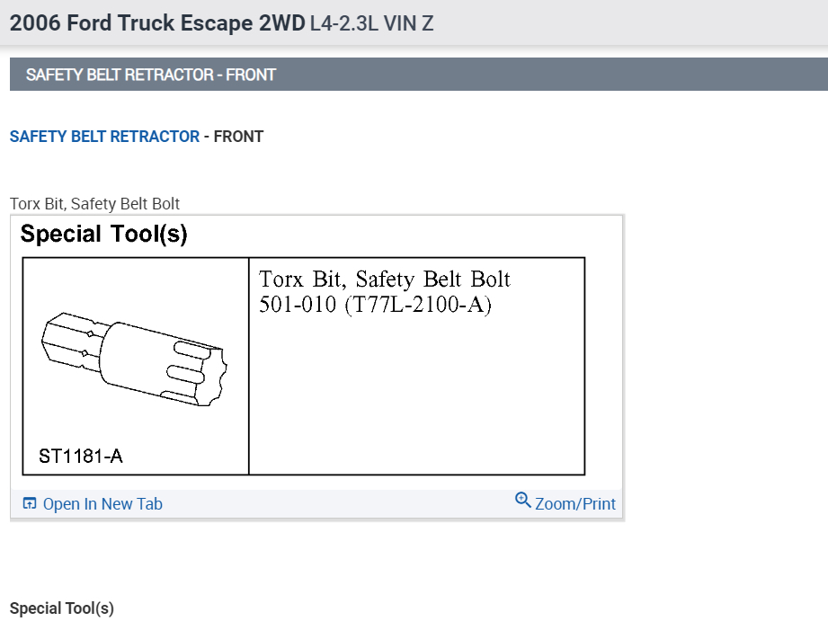

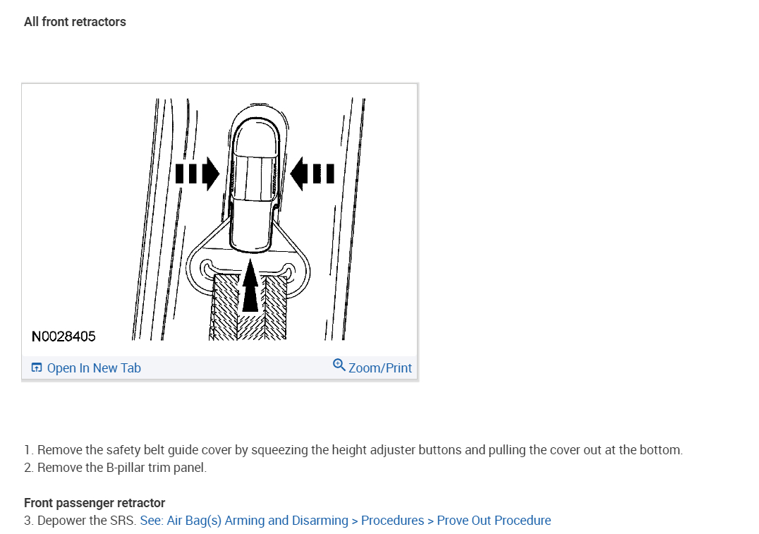

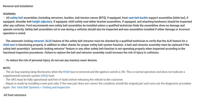

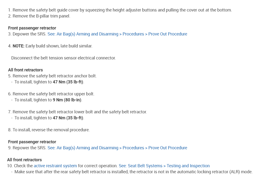

The seat belt mounting bolts will be pretty tight FYI. Here is the instructions on how to replace the seat belt which you will need to get from the dealer. Some interior panels will need to be removed which is not to difficult. Please check out the images below for further instructions.
SAFETY BELT SYSTEM
When replacing any active occupant restraint components, use only the replacement parts specified in the Ford Customer Service Division Master Parts Catalog.
The active restraint system consists of the following:
- Front row safety belt buckles and pretensioners, attached to the inboard side of the seats.
- Driver safety belt retractor pretensioner (Hybrid only).
- Front row safety belt retractors, located behind the lower B-pillar trim panels.
- Second row outboard safety belt retractors, located behind the rear quarter trim panels.
- Second row 60/40 seat center safety belt retractor and LH safety belt buckle assembly integrated into the 60 percent seat back.
- Second row dual safety belt buckle assembly for the 60/40 seat attached to the floor pan under the RH seat cushion.
- Second row lower anchors and tethers for children (LATCH) at all outboard seating positions, welded to the seat backrest frame.
- The child safety seat tether anchors are attached to the roof near the rear liftgate door.
