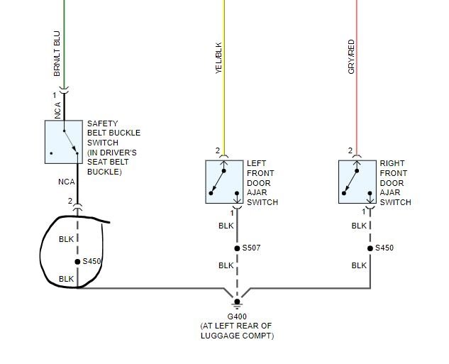

The seat belt alarm does not go off even when the belt is engaged.

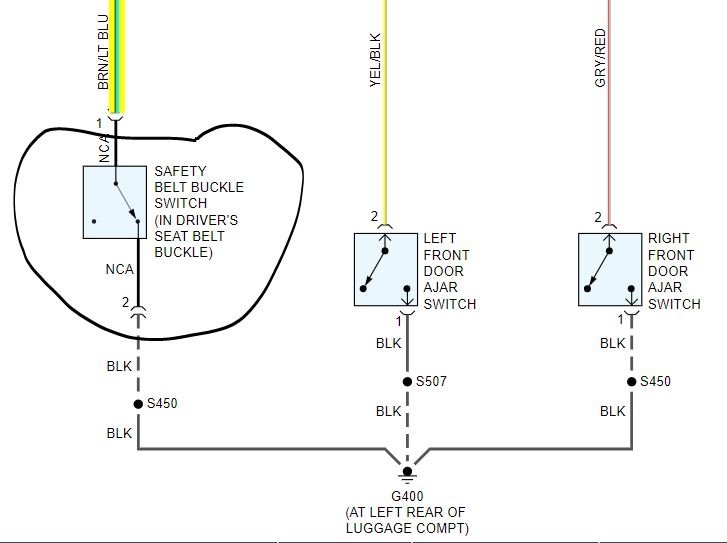

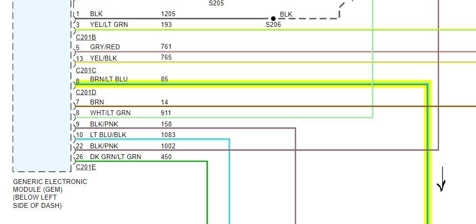

The only thing I can think of is the gem module is bad. Gem (generic electric module) is what sends the signal to the buckle switch. They used to be a problem if the windshield had a leak. Water would get to them and cause them to malfunction. If you look at pic 1, I attached a portion of the wiring. I drew an arrow (sad one) that points to the seat switch. The only other thing is the seat belt switch itself. If you look at picture 2, you'll see it is nothing more than a basic switch. When closed, power goes to ground.

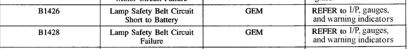

I attached a third picture. If you have a good enough scanner, you can check for codes related to the GEM. Take a look at the picture. I cut out two codes for you to see. Also, look to the right for what needs checked.
Based on everything you have done, the only thing I can think of is a bad switch, the GEM has failed, or you have no ground. I say no ground because you told me you connected the two wires together.
Just for the heck of it, take the brown/light blue wire and run it to a known good ground and see if that fixes it. Looking at the schematic, I notice there is a splice in the ground wire before it reaches its ground point. It may be bad. See picture 4. By the way, the nca for the ground wire indicates no color available.
