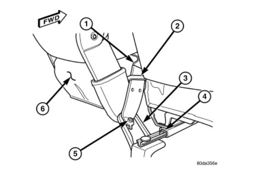

My daughter hit a parking pole, no damage really but the front 2 seat belts lock tight and can't pull them out. Anyway to repair the without sending them off or buying new one? Thanks for any help.
Mar 12, 2020 at 1:29 PM
Good morning,
The pretensions or the belts have to be replaced. There is no unlocking them. They are supposed to do that in the event of a crash to prevent the driver from moving forward to the steering wheel.
