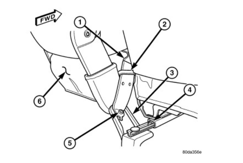

My daughter hit a parking pole, no damage really but the front 2 seat belts lock tight and can't pull them out. Anyway to repair the without sending them off or buying new one? Thanks for any help.

Good morning,
The pretensions or the belts have to be replaced. There is no unlocking them. They are supposed to do that in the event of a crash to prevent the driver from moving forward to the steering wheel.
