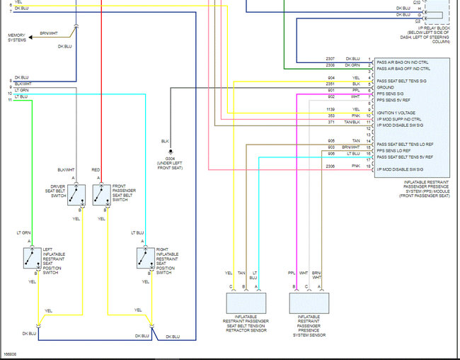

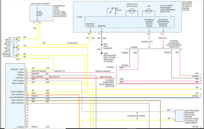

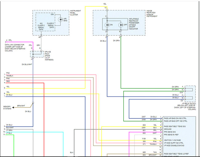

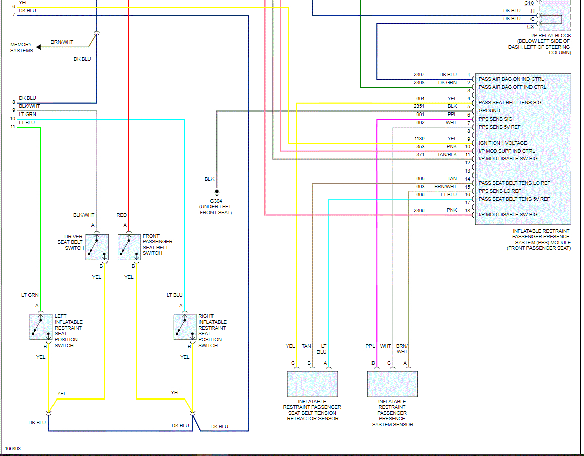

SDM wiring diagram
2003 CHEVROLET SILVERADO
155,000 MILES • 8.1L • V8 • 4WD • AUTOMATIC
LOUD PELLETIER
  • 39 POSTS
I would like to have the wiring diagram of the airbag service that passes to the floor and the wiring diagram of the floor of the truck listed above, lt.
Aug 30, 2021 at 12:33 PM
  • 110,244 POSTS

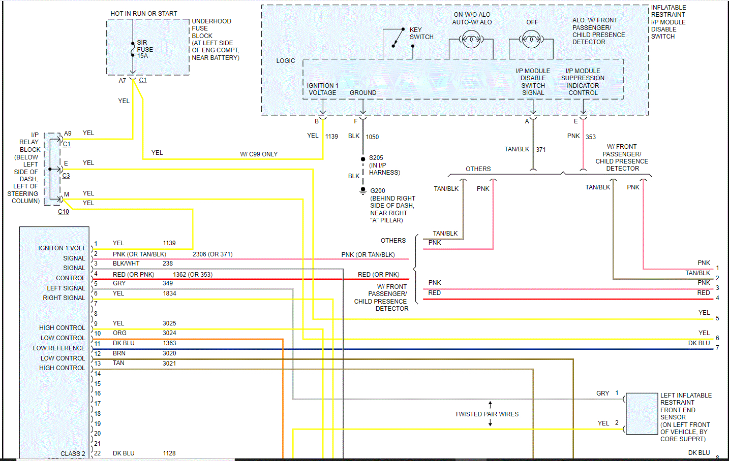

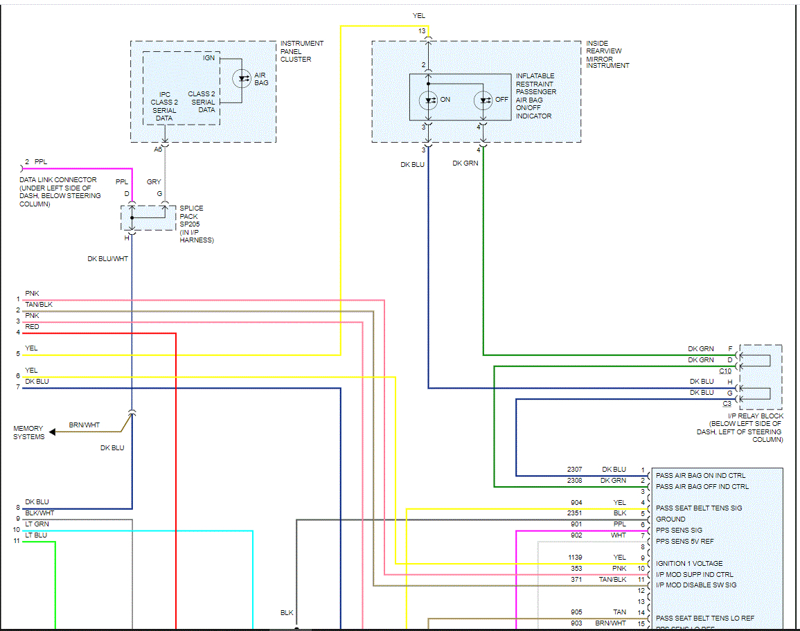

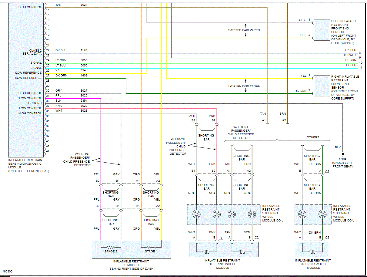

Hi: If you look at the pics below, I included the entire system wiring schematic. Take a look through it and let me know if that is what you needed.
The schematic was two pages long. I had to cut each in half to make them readable for you. I did overlap them so you can follow from one to the next.
Here is a link you may find helpful when checking wiring.
See pics below
