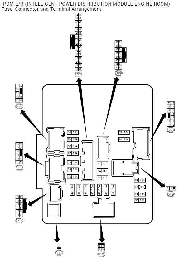

No radio, no map navigation screen is out?
2018 NISSAN PATHFINDER
87,000 MILES • V6 • 4WD • AUTOMATIC
MARCIO ANTONIO
I didn't nothing on the car and get off no screen (still lights on the back) no radio, no map navigation (included SD card).
Nov 24, 2023 at 8:26 AM
  • 55,402 POSTS

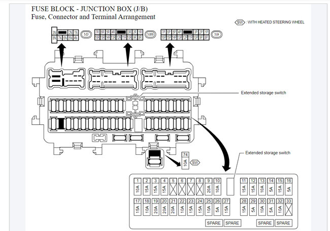

It sounds like you may have a display control module that has gone out but we should check the fuse #65 10-amp in the under-hood fuse panel and fuse# 15 and #29 in the fuse panel in the lower left side of the dashboard.
Here is a guide to help and the fuse location int eh images below:

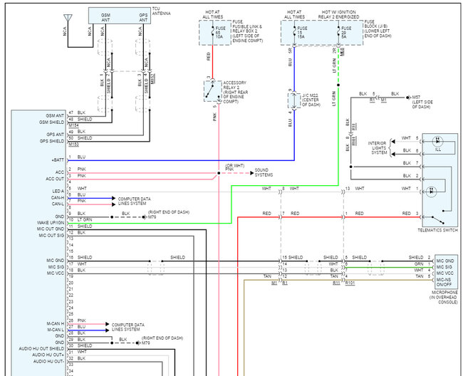

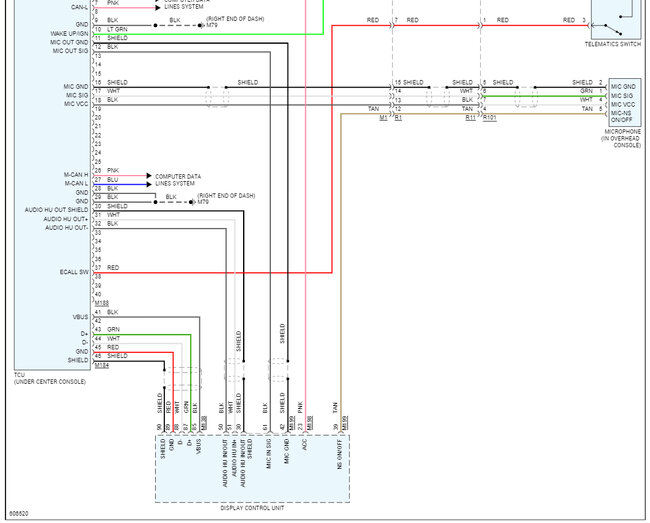

I have also included the wiring diagrams for the telematics screen so you can see how the system works. Check out the images (below). Please let us know what happens.
Nov 25, 2023 at 1:39 AM
QUINN BOSS
For anyone else who has this issue, Ken is likely correct in that it's the DCU (Display Control Unit); specifically a Micro SD Card inside the DCU.
