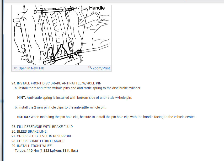

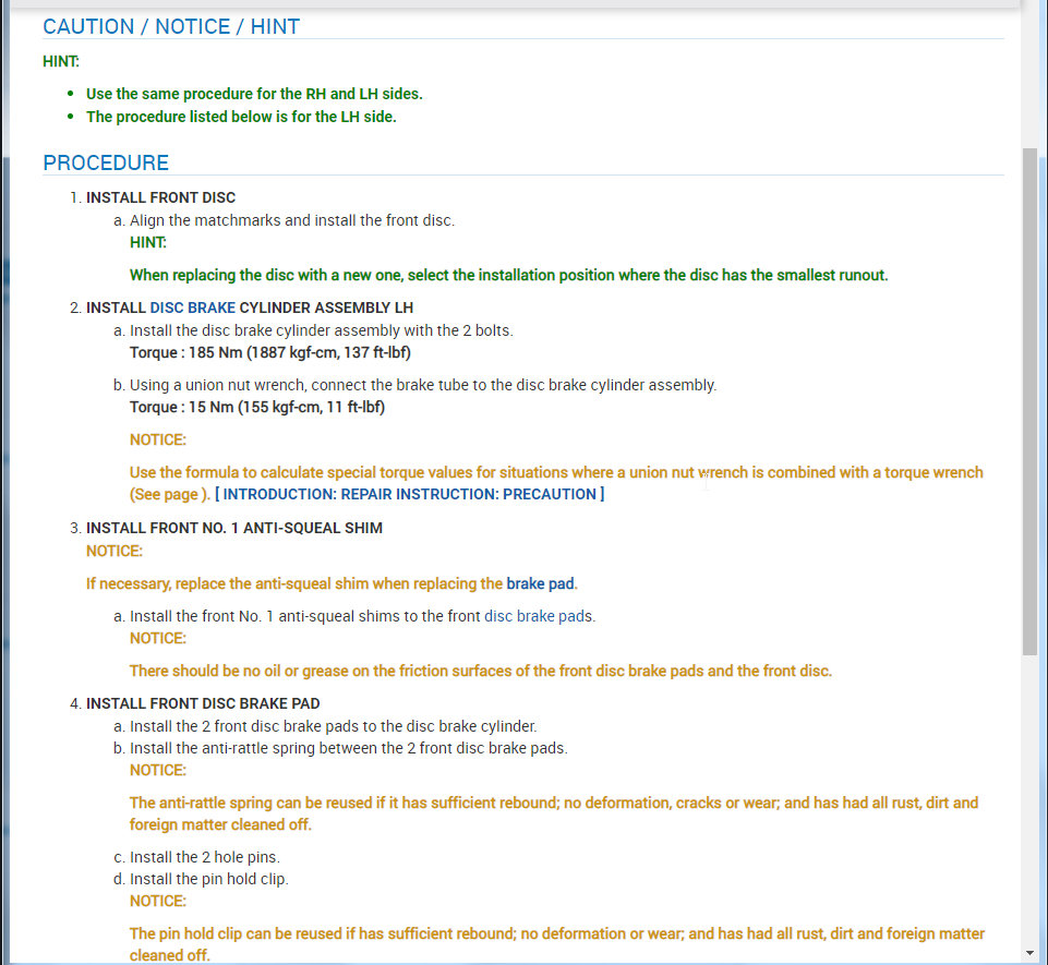

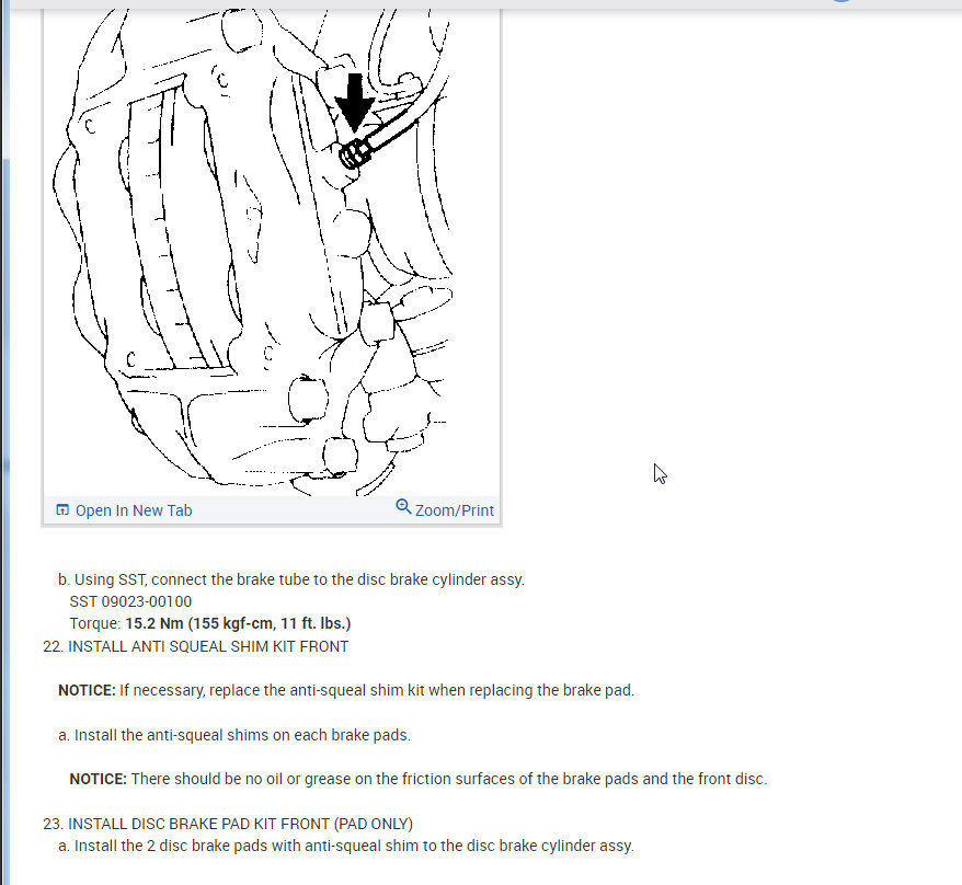

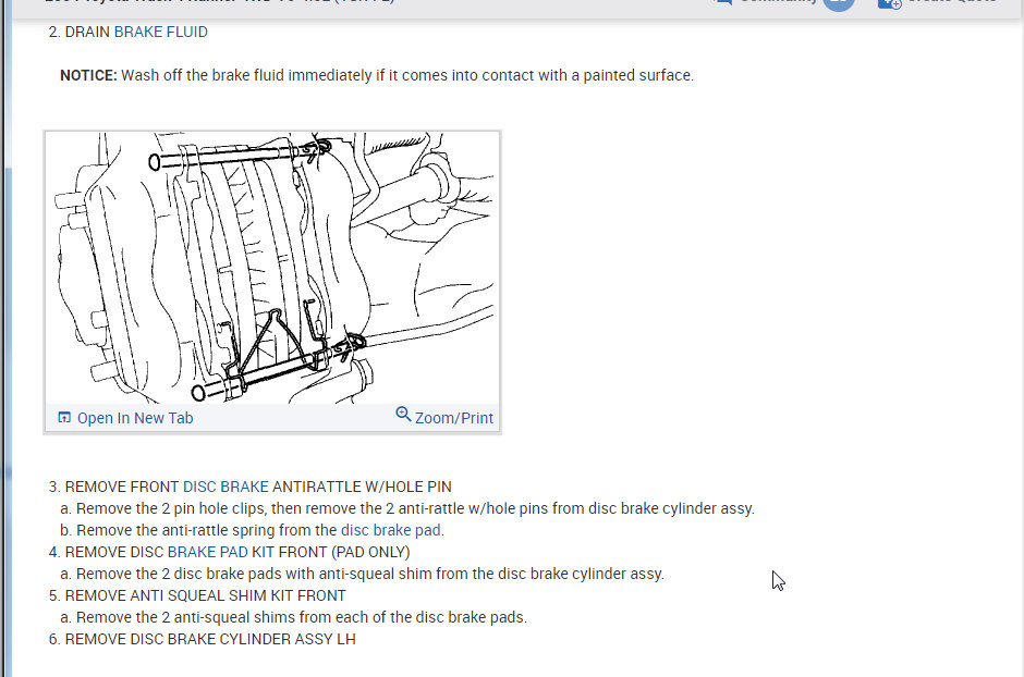

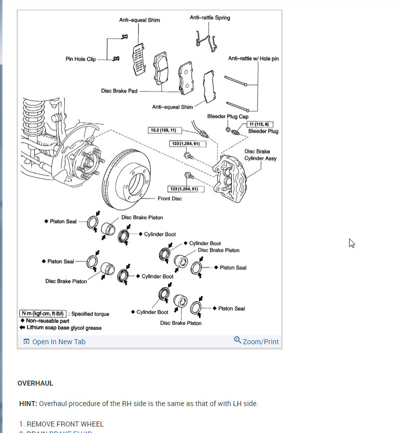

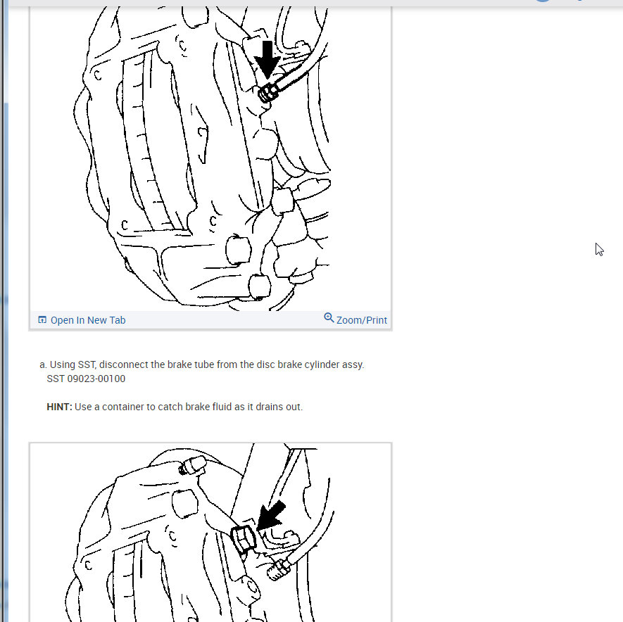

out of my driveway I hear an extremely loud screeching noise
2016 TOYOTA 4RUNNER
105,000 MILES • 4.0L • V6 • 2WD • AUTOMATIC
CATHYRSTEVENS
when i back out of my driveway I hear an extremely loud screeching noise.This has continued and is so loud you can hear it inside the house. I've asked the mechanic to look at it and hes says we need new front brakes can you help?
Jul 9, 2020 at 10:31 PM

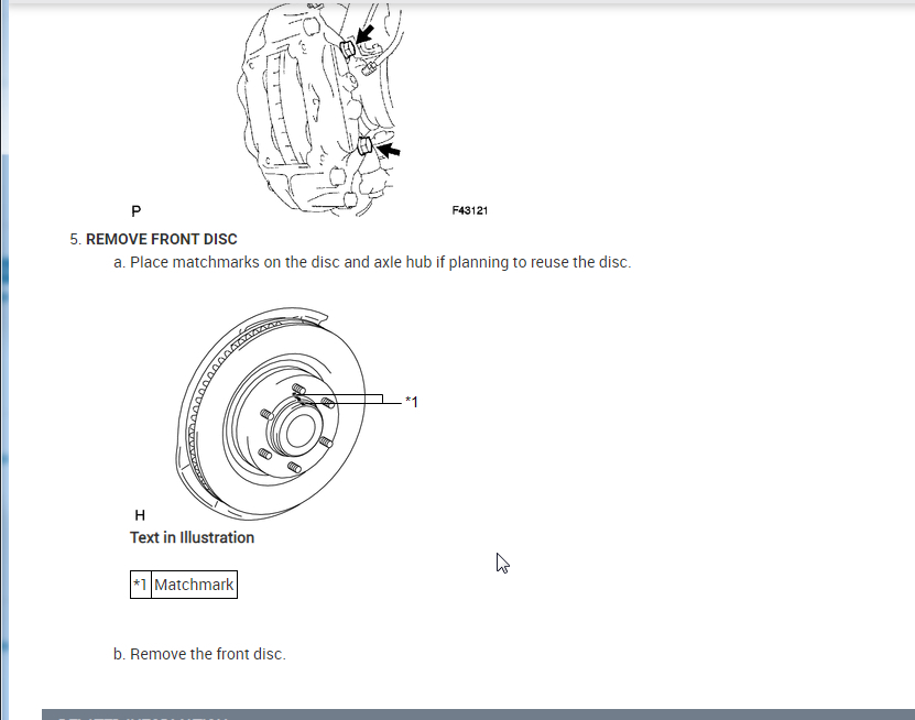

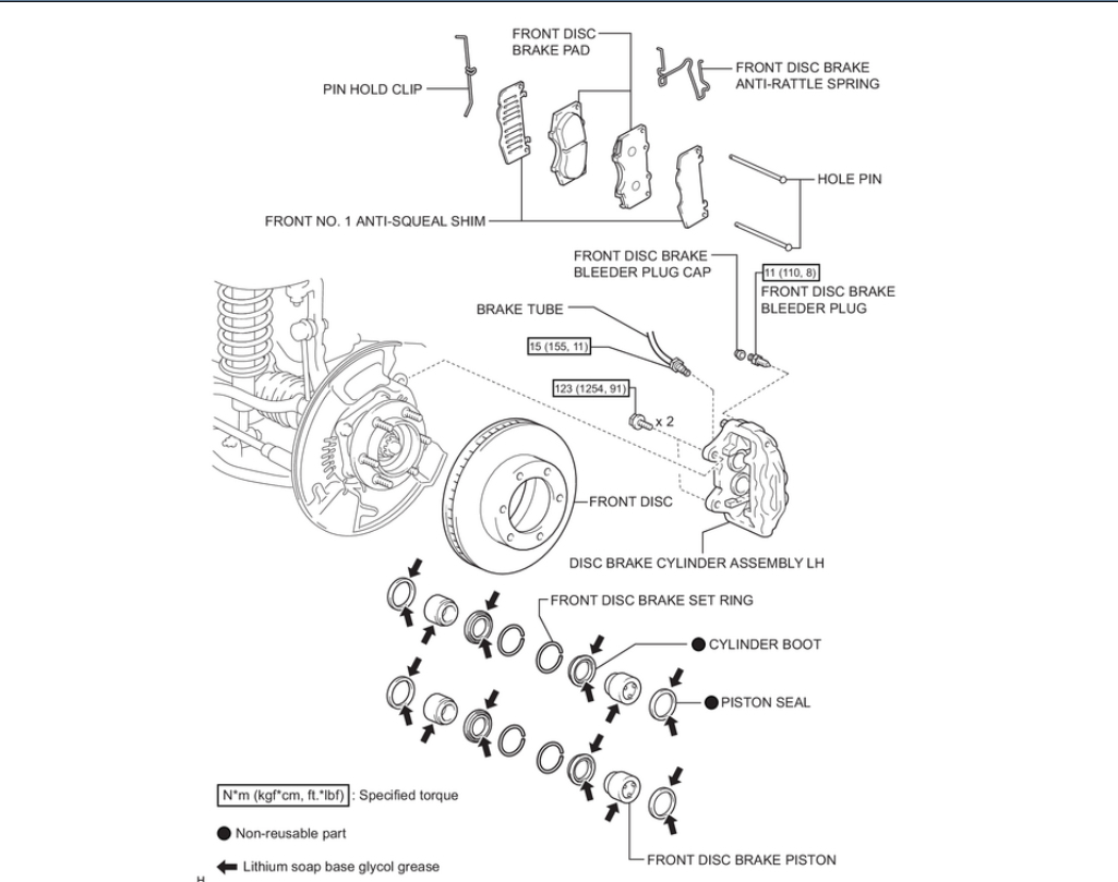

Here is a video to help you step by step with instructions in the diagrams below to show you how on your car.
https://youtu.be/Gzgh_LVAIDE
and
https://www.youtube.com/watch?v=mOyHFT0hoKc

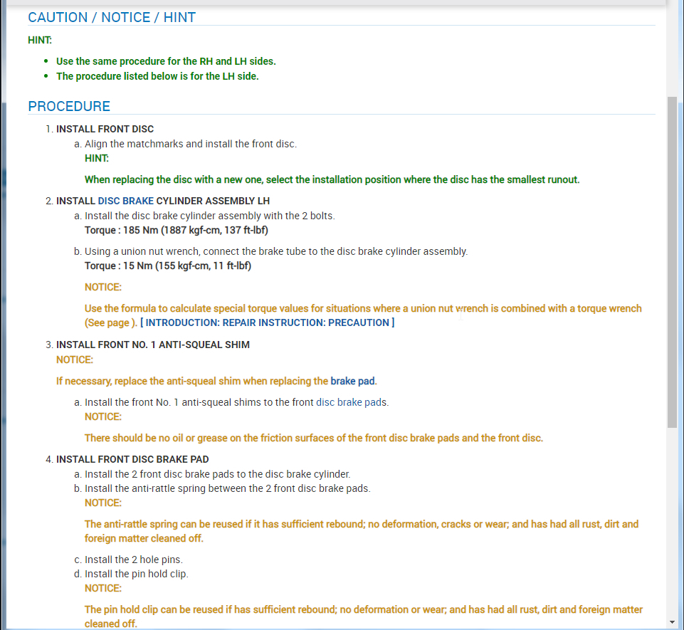

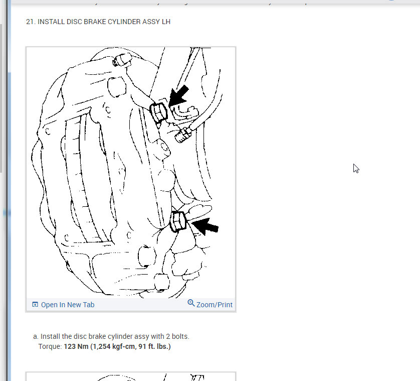

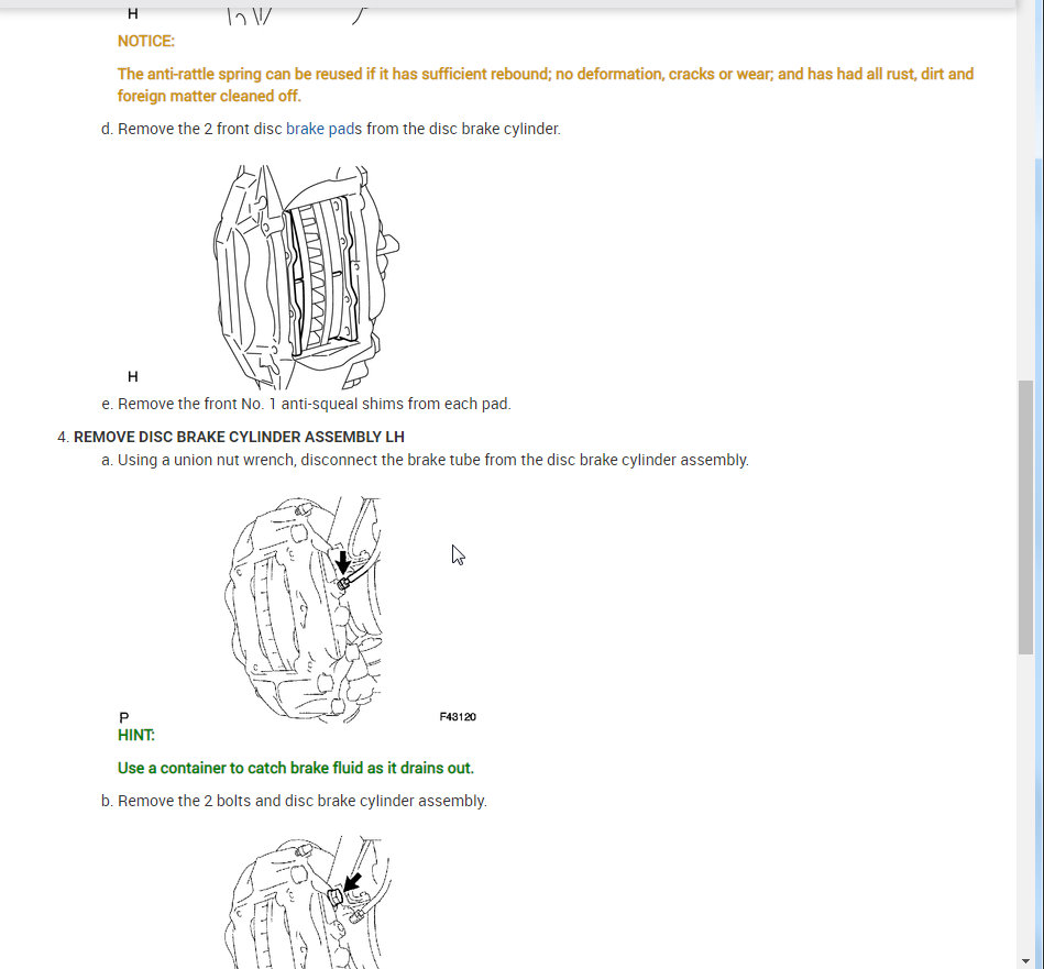

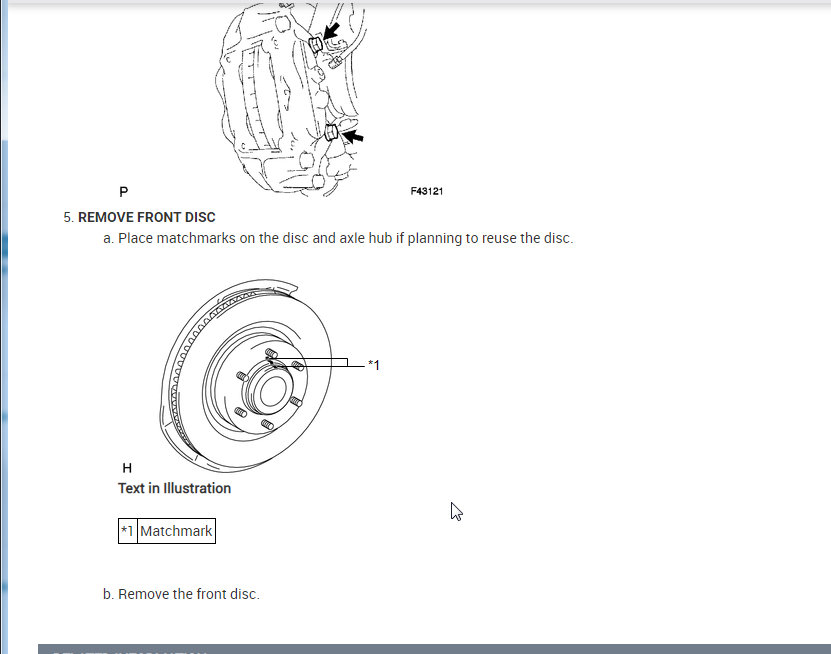

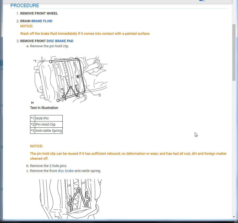

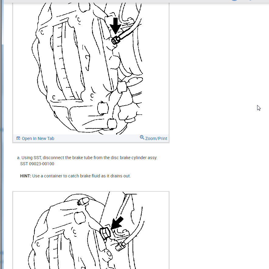

Plus here is the process from the manual on how to replace these as well. Please let us know if you have other questions. Thanks

Good morning,
I attached a breakdown of the front brakes for you to view. I also attached a guide for the procedure for replacing the pads and rotors.
I attached a YouTube video of the procedure as well.

Here is a guide to help you step by step with instructions in the diagrams below to show you how on your car.
Below you will find the process from the manual on how to replace these. Let me know if you have other questions. Thanks

How do you pull a rotor off of a 2002 Four Runner? Front rotors Braking system completly nothing but dust caps and rotor!!! Pulled front dust cap no help without a tool!!! Is there a press involved!! Do you need a tool a fly wheel puller or something like it? Or do you go through the large dust plate in the back of the wheel mount and knock the rotor out that way? Signed Stumped!!!
Apr 5, 2021 at 3:48 AM (Merged)
BLACKOP555
  • 10,386 POSTS
the rotors are probably rusted around the center. spray all around the inside of the center of the at the center and around the lugs to try and loosen it up. then heat it up and hit on it with a hammer between the lugs till it comes off.
