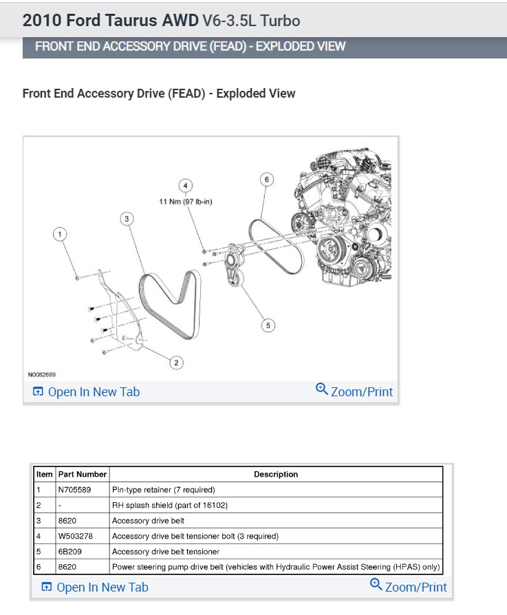

My car has been making a screeching sound when I accelerate. I would guess it’s the timing belt, but my car has a timing chain. Would my car still be making that sound? Side note, this sound started around the time I got the front axle links fixed after I endured pothole damage.

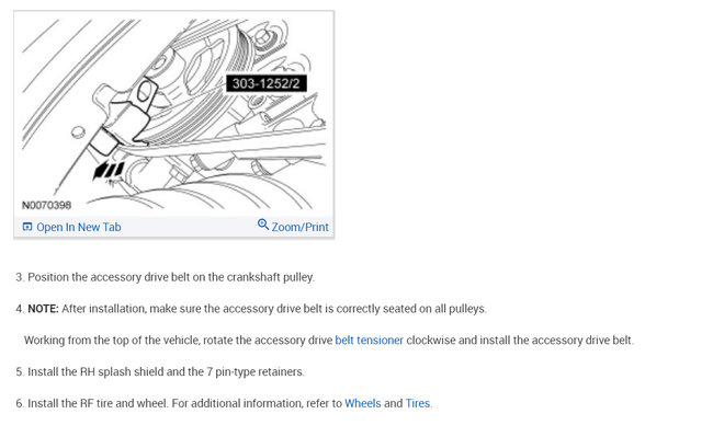

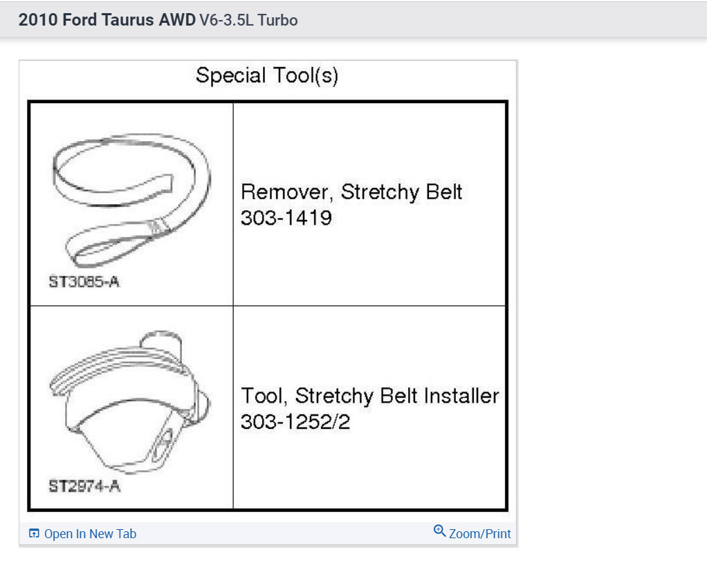

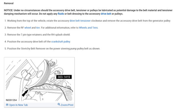

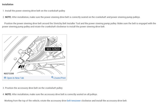

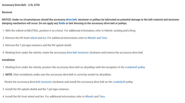

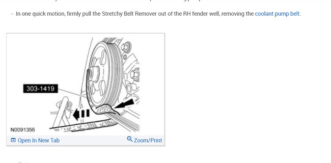

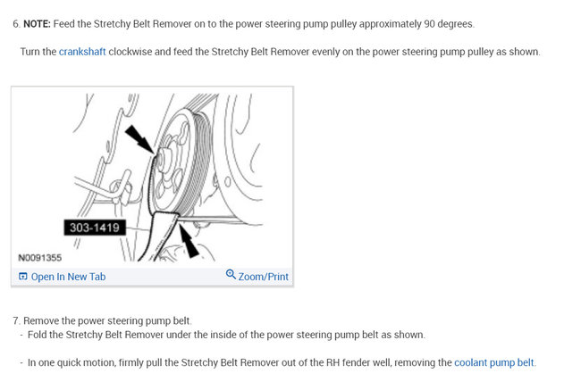

It's hard to say without hearing the noise. Can you please shoot a quick video with your phone so I can hear the noise? That way I can tell for sure what's going on. You can upload it here with your response. I would guess it would be your serpentine belt, here is a generic guide to help you see what you are in for when doing the job with instructions below for your car:
The power steering belt is a "stretchy" belt, so you force the belt off and on with a special tool. Check out the diagrams (below). Please let us know what you find.
