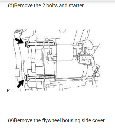

It only makes this noise during cold start up. If the engine is warm. No issues. I replaced the serpentine belt. Belt tensioner etc. here twice now. The engine will just crank and crank and then fire up.
Jan 4, 2025 at 4:35 PM
  • 55,399 POSTS

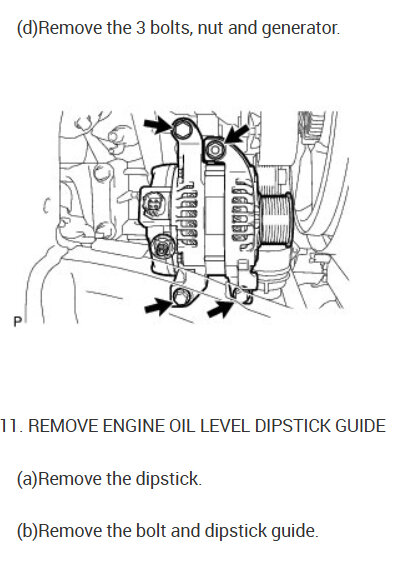

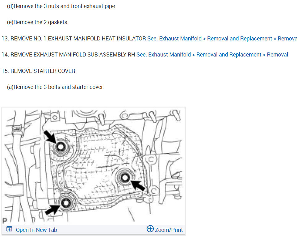

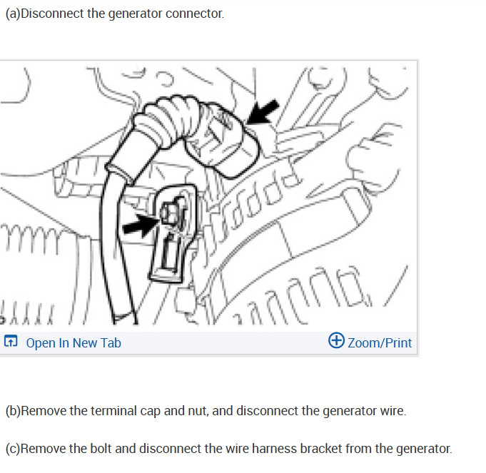

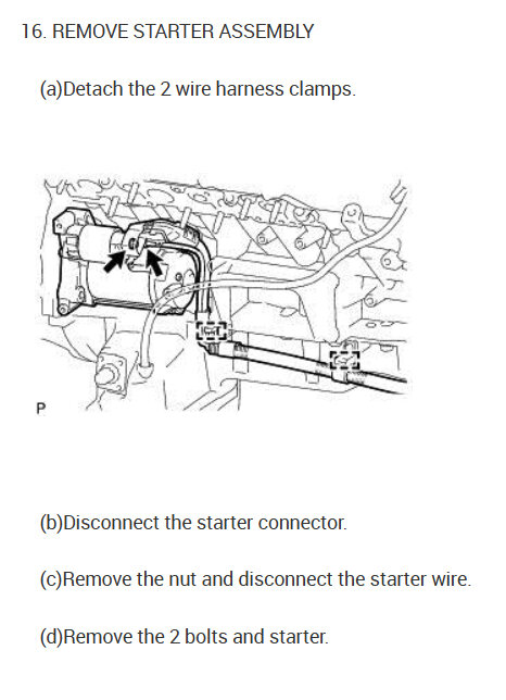

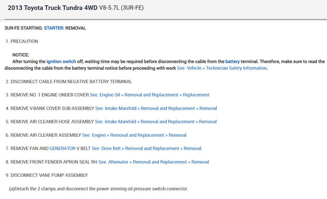

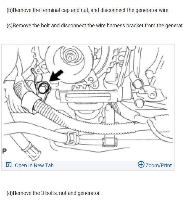

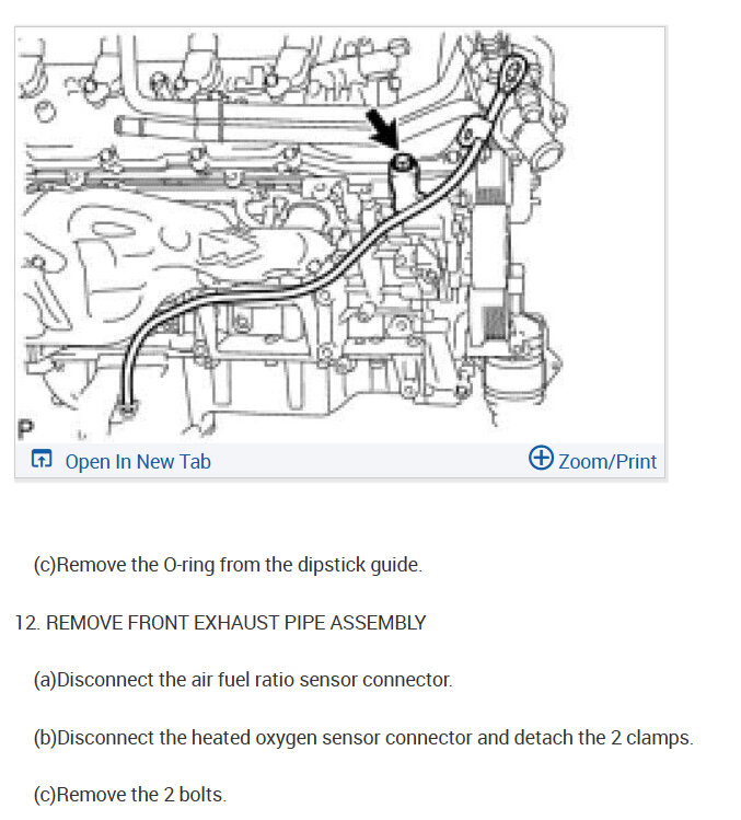

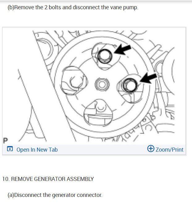

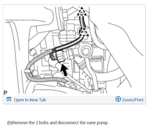

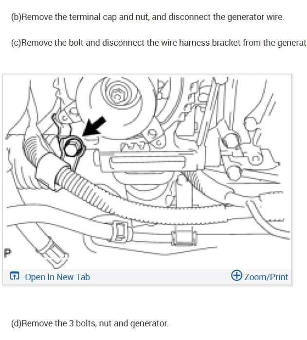

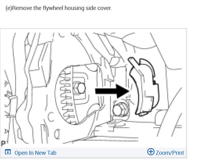

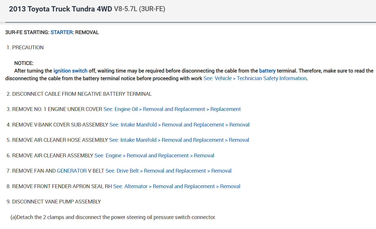

Yep, that is the starter motor, you need a new one, thanks for the video it helps. Here is how to change the starter motor out to fix the problem. You will need to remove the alternator. Check out the images (below). Please let us know what happens.
Jan 5, 2025 at 7:18 AM
ARMYGUY06
Yeah, that’s what I was thinking it was. Didn’t want it to be that since the dam starters on these are a pain to change. Appreciate the input.
