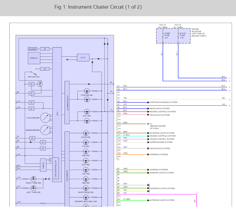

My gauges are not working. Checked fuses, relays and wiring system. What else can cause this problem? The power steering became hard at that same time that this problem started.

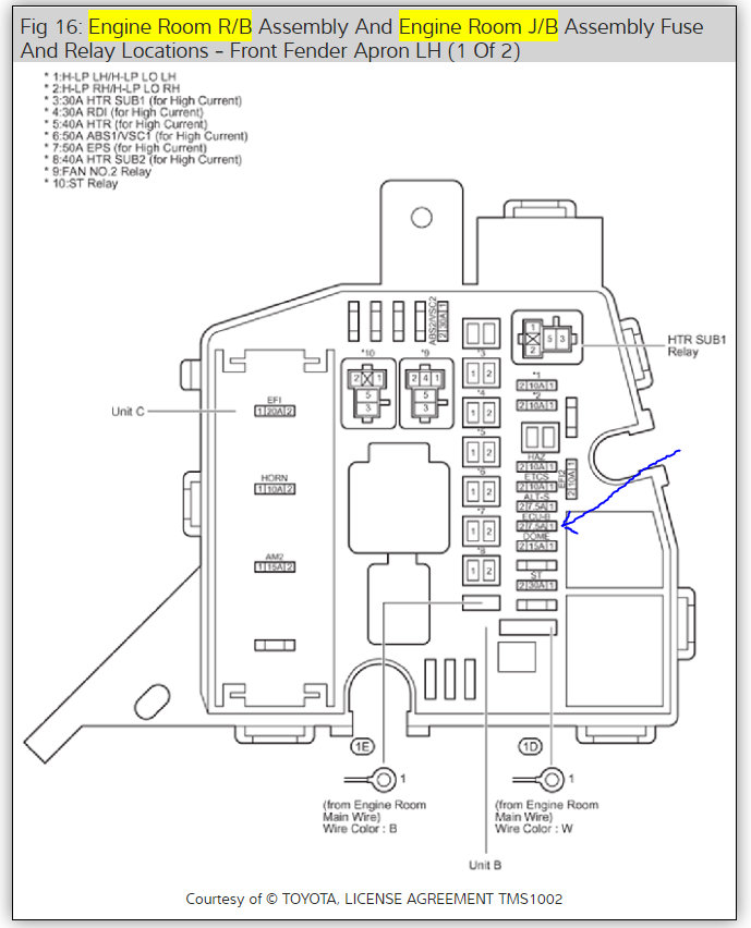

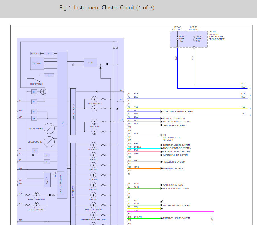

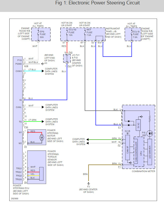

It sounds like you popped a ECUB fuse or its not getting power/bad connection. Here is a guide to help you test for power and the wiring diagrams so you can see how the systems work with the fuse location as well. I have seen the steering module have a problem popping the fuse FYI.
Check out the diagrams (below). Please let us know what you find.
