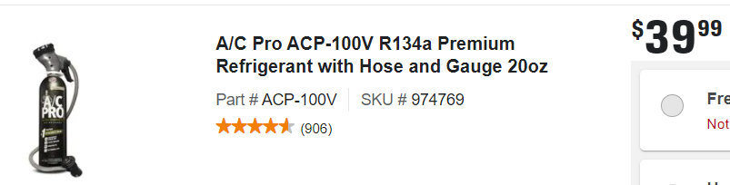

Hi, what can I do to fix my A/C? it just started yesterday it doesn't want to get cold anymore.. I'm a girl and i don't know nothing about car just drive them.. please
help. some websites said i need to get a air conditioner charger something like that.. how much will that cost?
Sep 27, 2010 at 8:23 AM
DANNY L
  • 5,648 POSTS
Hello, I'm Danny.
It sounds like your A/C system might be low on refrigerant if it blow air but not as cold as it used to be. They sell a do it yourself charge kit at all auto parts stores for about $40.00. There are instructions on the can and it should take less than an hour to get results assuming there are no leaks in your ac system. Here is a tutorial showing how to add refrigerant to your A/C system:
https://www.2carpros.com/articles/air-conditioner-how-to-add-freon
I've attached a picture below of what the do it yourself charge can looks like. Hope this helps and thanks for using 2CarPros.
