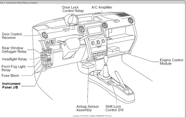

I am going to install an aftermarket Autogage Tachometer and I need to access the ECU on my 2006 Scion XB. Can to tell me its location in this car and any cautions to observe ?
Thanks !
Mar 23, 2010 at 9:39 AM
  • 75,992 POSTS
Heres a diagram of the ECU location

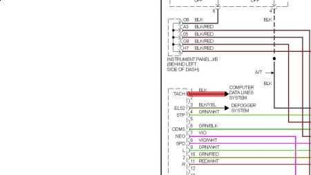

Thanks for the location diagram. Do you have a wiring schematic for the ECM plugs that will show me the TACH feed location ? I am adding a aftermarket TACH to my Scion XB 2006.
Thanks again for you help !
Mar 26, 2010 at 8:29 AM
  • 75,992 POSTS
The TACH signal is the black wire at PCM pin out no.1
https://images.2carpros.com/forum/automotive_pictures/12900_tach_1.jpg
