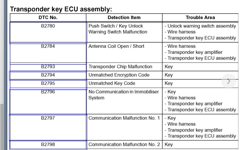

Looks like we need to try a couple other things first.
Here is a guide that may help with this so let's run through this and if it doesn't then we can take the next steps:
https://www.2carpros.com/articles/how-to-reset-a-security-system
If it doesn't work, then we need to scan for codes because that will tell us what the issue is and how to repair it.
Below is the list of possible codes. There are more but I expect we will have one of these.
Let's start with this and go from there. Thanks
