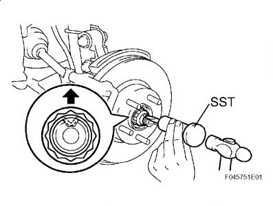

Hello, do you guys have an instructions on how to replace an axle on 2006 Scion tC passenger side. I was also wondering if you know what what size of axle nut socket I need.
Thanks

Hello -

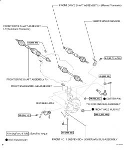

https://images.2carpros.com/forum/automotive_pictures/248015_1_182.jpg
REMOVAL HINT: "¢ Use the same procedures for the RH side and LH side. "¢ The procedures listed below are for the LH side. 1. DRAIN AUTOMATIC TRANSAXLE FLUID (for Automatic Transaxle) a. Drain automatic transaxle fluid (see REMOVAL ). 2. DRAIN MANUAL TRANSAXLE OIL (for Manual Transaxle) a. Drain manual transaxle oil (see ON-VEHICLE INSPECTION ). 3. REMOVE FRONT WHEEL 4. REMOVE ENGINE UNDER COVER 5. REMOVE FRONT AXLE HUB NUT a. Using SST and a hammer, unstake the staked part of the nut. SST 09930-00010 NOTE: Loosen the staked part of the nut completely, otherwise the screw of the drive shaft may be damaged. b. While applying the brakes, remove the lock axle hub nut. Fig. 4: Removing Front Axle Hub Nut Courtesy of TOYOTA MOTOR SALES, U.S.A., INC.

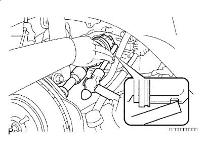

https://images.2carpros.com/forum/automotive_pictures/248015_4_59.jpg
6. DISCONNECT FRONT STABILIZER LINK ASSEMBLY a. Remove the nut and disconnect the stabilizer link assembly. HINT: If the ball joint turns together with the nut, use a 6 mm hexagon wrench to hold the stud in place. Fig. 5: Removing/Installing Front Stabilizer Link With Nut Courtesy of TOYOTA MOTOR SALES, U.S.A., INC.

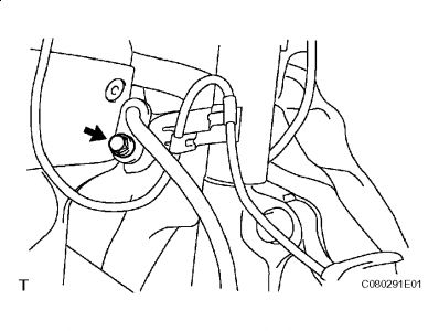

https://images.2carpros.com/forum/automotive_pictures/248015_5_42.jpg

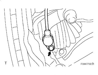

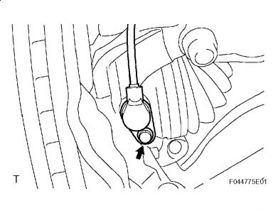

7. DISCONNECT FRONT SPEED SENSOR a. Remove the bolt, and disconnect the speed sensor wire and flexible hose from the shock absorber. NOTE: Be careful not to damage the speed sensor. b. Fig. 6: Front Speed Sensor Wire And Hose At Shock Absorber Courtesy of TOYOTA MOTOR SALES, U.S.A., INC.

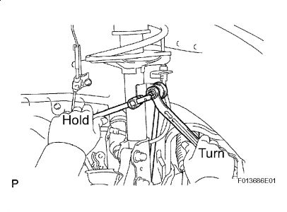

https://images.2carpros.com/forum/automotive_pictures/248015_6_26.jpg
c. Remove the bolt, and disconnect the front speed sensor from the steering knuckle. NOTE: "¢ Be careful not to damage the speed sensor. "¢ Prevent foreign matter from attaching to the speed sensor. Fig. 7: Front Speed Sensor & Steering Knuckle Courtesy of TOYOTA MOTOR SALES, U.S.A., INC.

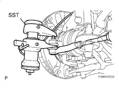

https://images.2carpros.com/forum/automotive_pictures/248015_7_22.jpg
8. DISCONNECT TIE ROD END SUB-ASSEMBLY a. Remove the cotter pin and nut. b. Using SST, disconnect the tie rod end from the steering knuckle. SST 09628-00011 Fig. 8: Disconnecting Tie Rod End Sub-Assembly Courtesy of TOYOTA MOTOR SALES, U.S.A., INC.

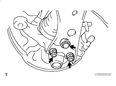

9. DISCONNECT FRONT NO. 1 SUSPENSION LOWER ARM SUB-ASSEMBLY a. Remove the bolt and 2 nuts, and separate the front suspension lower arm from the lower ball joint. Fig. 9: Removing Bolt And Nuts Courtesy of TOYOTA MOTOR SALES, U.S.A., INC.

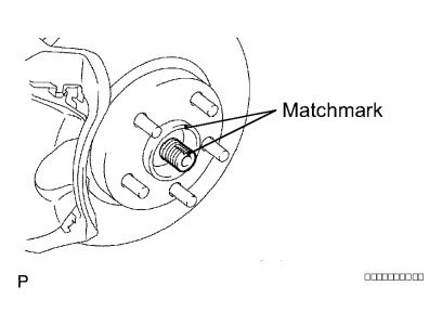

https://images.2carpros.com/forum/automotive_pictures/248015_9_12.jpg

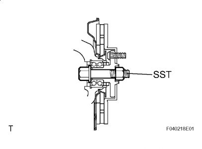

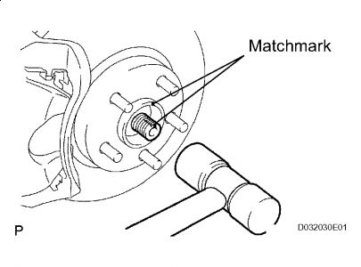

10. REMOVE FRONT AXLE ASSEMBLY a. Put matchmarks on the drive shaft and the axle hub. b. Using a plastic-faced hammer, separate the drive shaft from the axle hub. NOTE: Be careful not to damage the boot and speed sensor rotor. NOTE: Do not excessively push out the drive shaft from the axle assembly. d. Fig. 10: Identifying Matchmarks And Hammer Courtesy of TOYOTA MOTOR SALES, U.S.A., INC.
https://images.2carpros.com/forum/automotive_pictures/248015_10_9.jpg

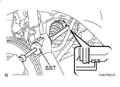

11. REMOVE FRONT DRIVE SHAFT ASSEMBLY LH a. Using SST, remove the front drive shaft. SST 09520-01010, 09520-24010 (09520-32040) NOTE: "¢ Be careful not to damage the transaxle case oil seal, inboard joint boot and drive shaft dust cover. "¢ Be careful not to drop the drive shaft assembly. Fig. 11: Removing Front Drive Shaft Courtesy of TOYOTA MOTOR SALES, U.S.A., INC.
https://images.2carpros.com/forum/automotive_pictures/248015_11_10.jpg

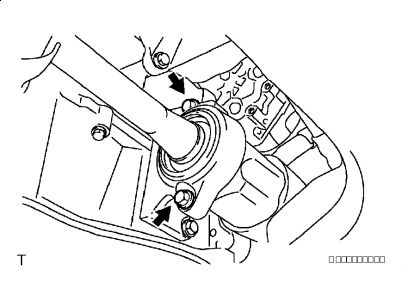

12. REMOVE FRONT DRIVE SHAFT ASSEMBLY RH a. Remove the 2 bolts and pull out the drive shaft together with the drive shaft bearing case. b. Remove the drive shaft from the transaxle. NOTE: "¢ Be careful not to damage the inboard joint boot and drive shaft dust cover. "¢ Be careful not to drop the drive shaft assembly. Fig. 12: Front Drive Shaft Assembly Bolt RH Courtesy of TOYOTA MOTOR SALES, U.S.A., INC.
https://images.2carpros.com/forum/automotive_pictures/248015_12_2.jpg

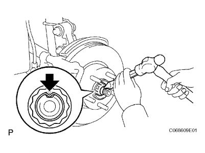

8. INSTALL FRONT AXLE HUB NUT a. Install a new axle hub nut. Torque: 216 N.m (2,200 kgf.cm, 159 ft.lbf) b. Using a chisel and hammer, stake the axle hub nut. 9. INSTALL ENGINE UNDER COVER 10. INSTALL FRONT WHEEL Torque: 103 N.m (1,050 kgf.cm, 76 ft.lbf) 11. ADD AUTOMATIC TRANSAXLE FLUID (for Automatic Transaxle) Fig. 57: Installing New Axle Hub Nut Courtesy of TOYOTA MOTOR SALES, U.S.A., INC.
https://images.2carpros.com/forum/automotive_pictures/248015_57_1.jpg

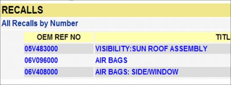

Hello - Also, it looks like you may have some recalls on your vehicle. The dealer may fix these for free. Please contact the dealer service department, give them the VIN number of your car and have them check on these to see if they apply to you.
https://images.2carpros.com/forum/automotive_pictures/248015_Recalls_42.jpg
