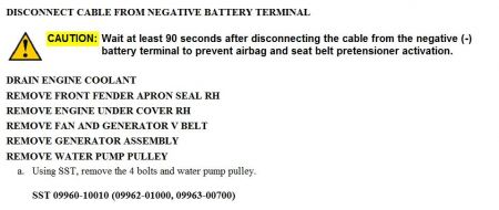

How do I change the water pump?
Aug 28, 2010 at 9:42 AM
BLUELIGHTNIN6
Experienced Mechanic
16,542 POSTS
Aug 28, 2010 at 9:48 AM
