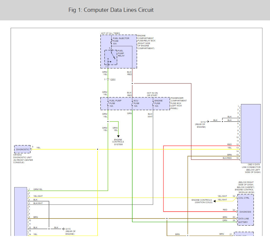

Has had a crank no start, intermittent. Check engine light is on.Immobilizer light is on when running.

Obd 2 Scanner connects via Kia adapter and lights up, tries to connect but cannot.

Austel MaxiScan MS309. Yes says no communication.

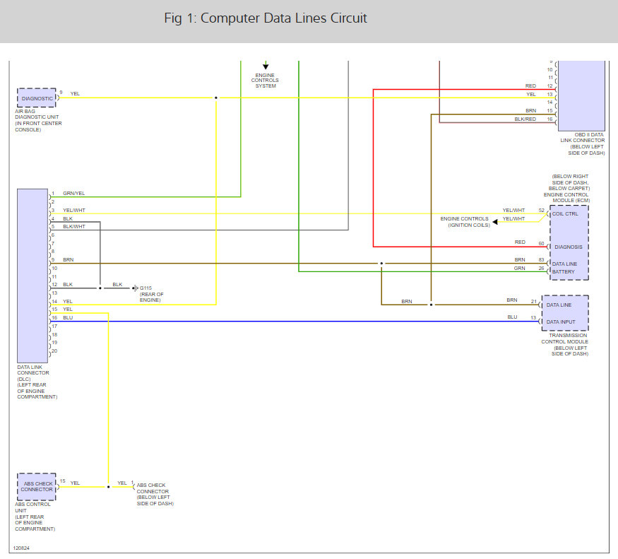

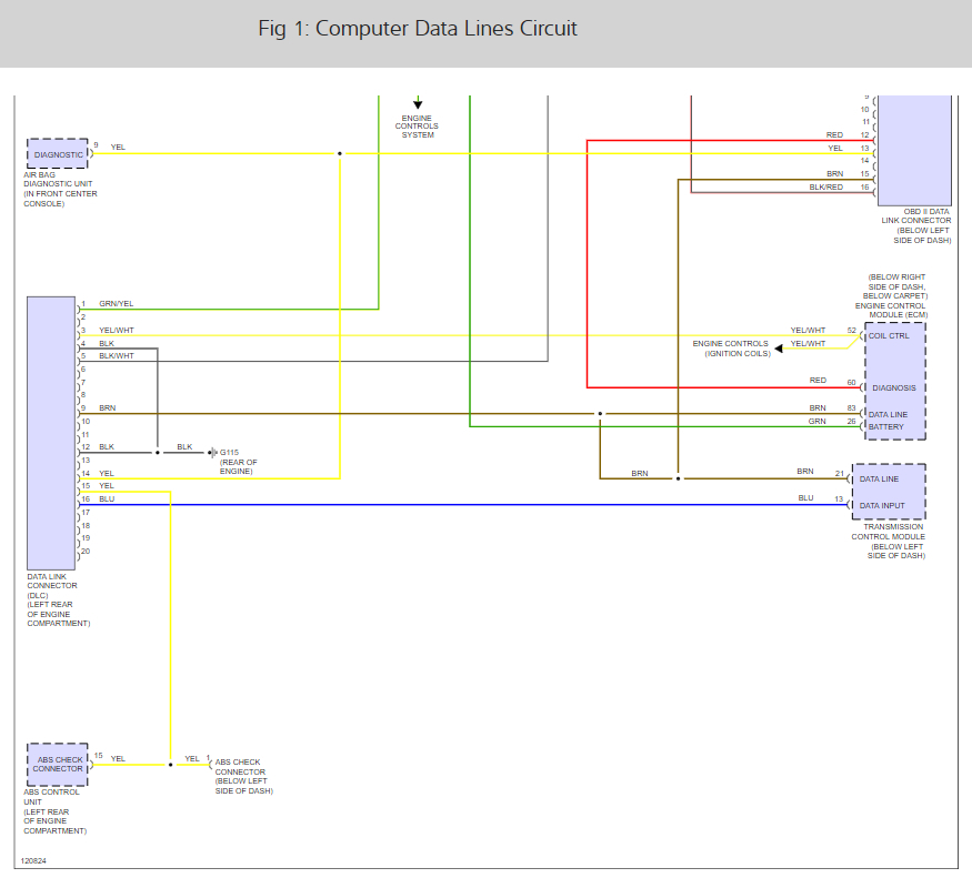

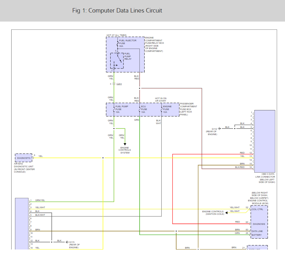

If I can jump in here this is the wiring diagrams for the ALDL and a guide to help you test it. Make sure the ALDL is getting power from the fuel injector fuse 30 amp.
