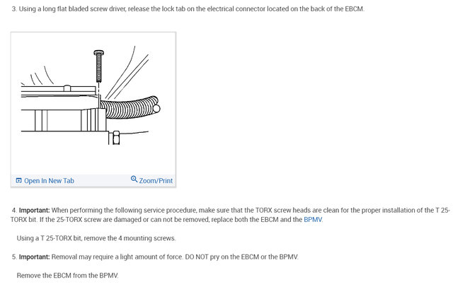

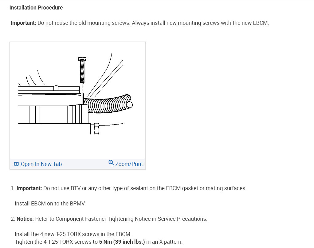

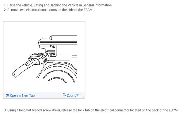

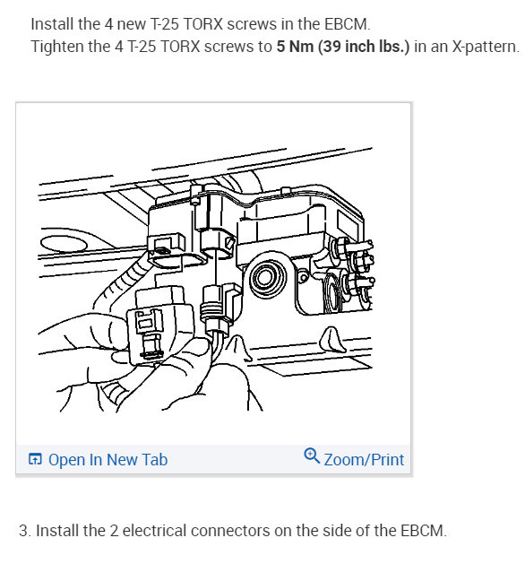

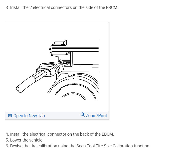

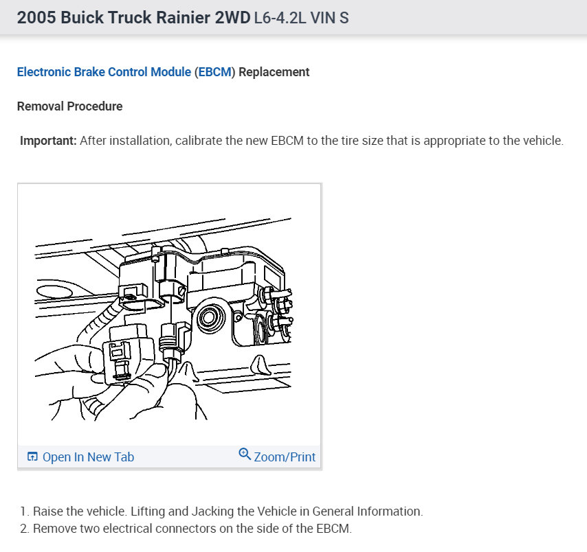

The ABS module sounds like it is going out because the ABS system gives vehicle speed information to the PCM and CAN. To be sure let's do a CAN scan which is the future of automotive repair you can get a CAN scanner from Amazon for about $30.00 here is a video to show you how and a link to a scanner from Amazon. I have included how to change out the ABS module in the diagrams below.
https://youtu.be/u-4syLc-ifQ
and
https://amzn.to/3OpAotj for the scanner
This guide can help as well:
https://www.2carpros.com/articles/how-to-replace-a-abs-controller
