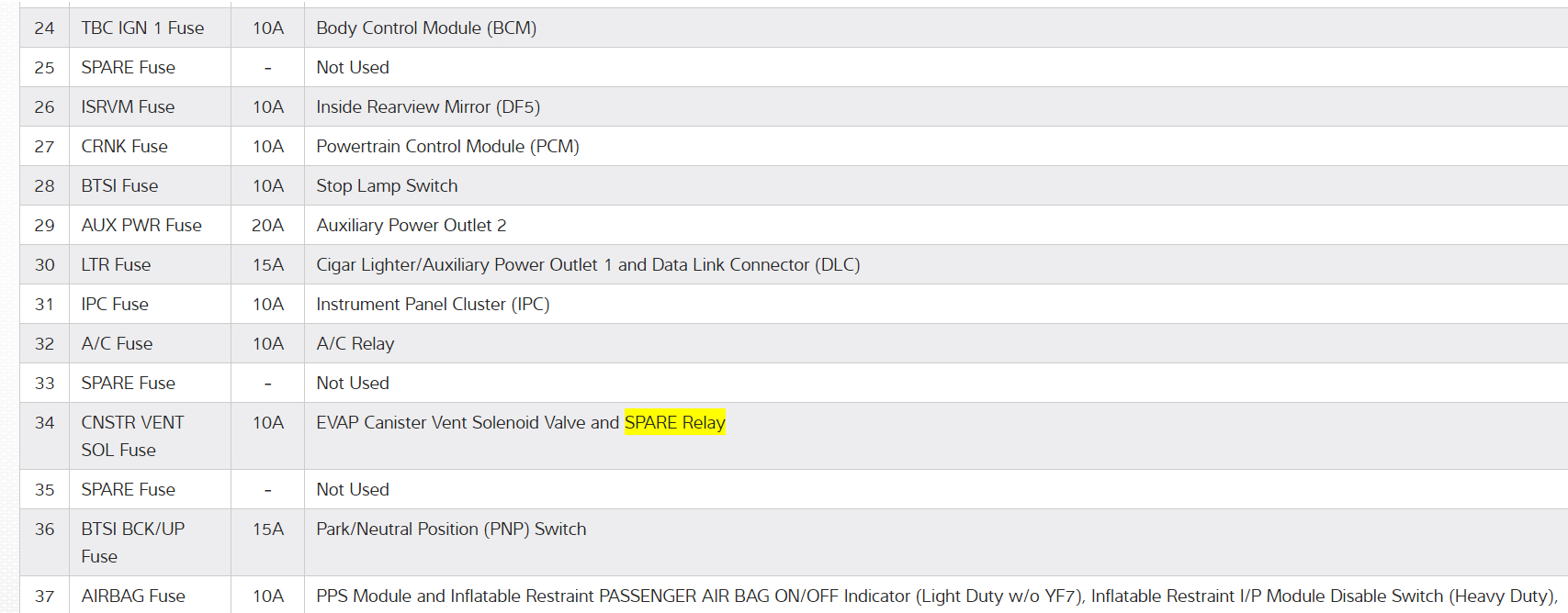

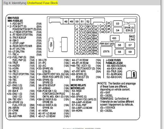

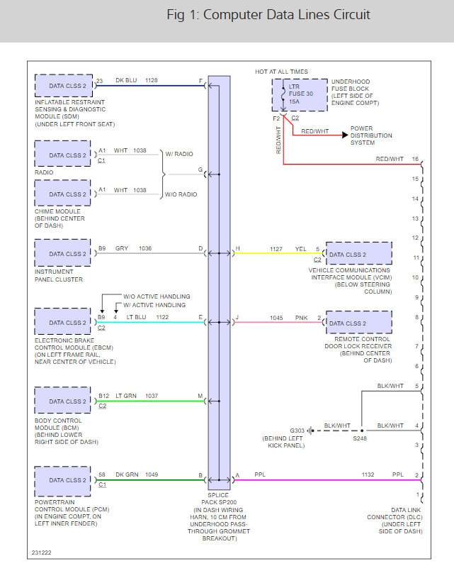

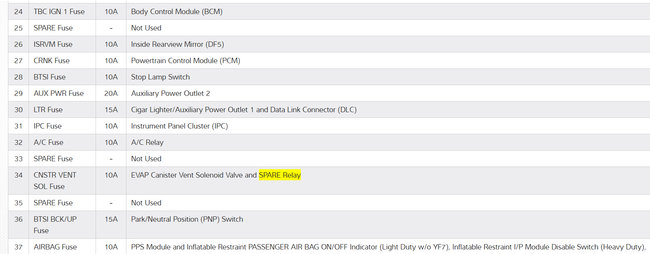

scanner does not communicate with ECU.
Apr 6, 2019 at 12:48 AM
  • 54,832 POSTS

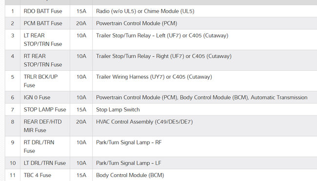

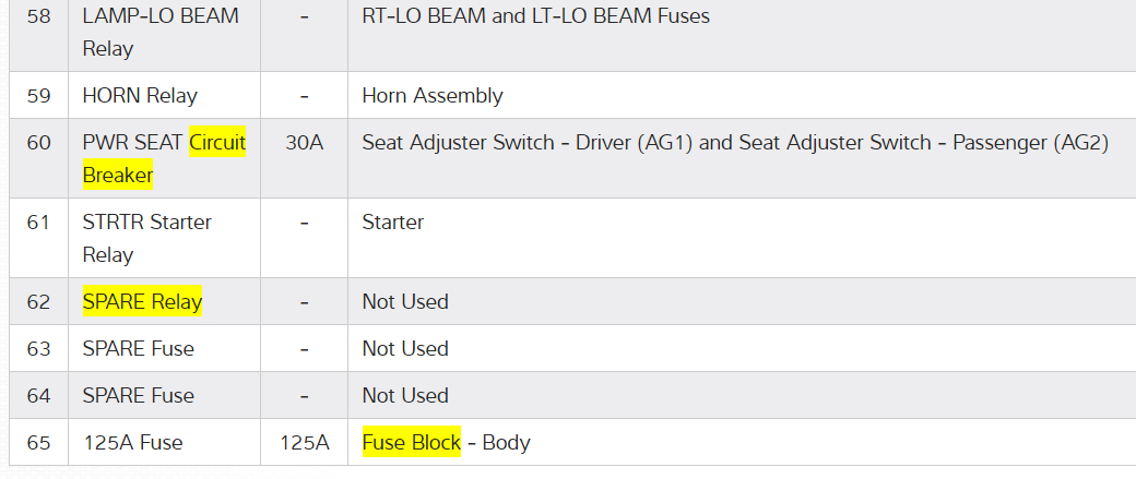

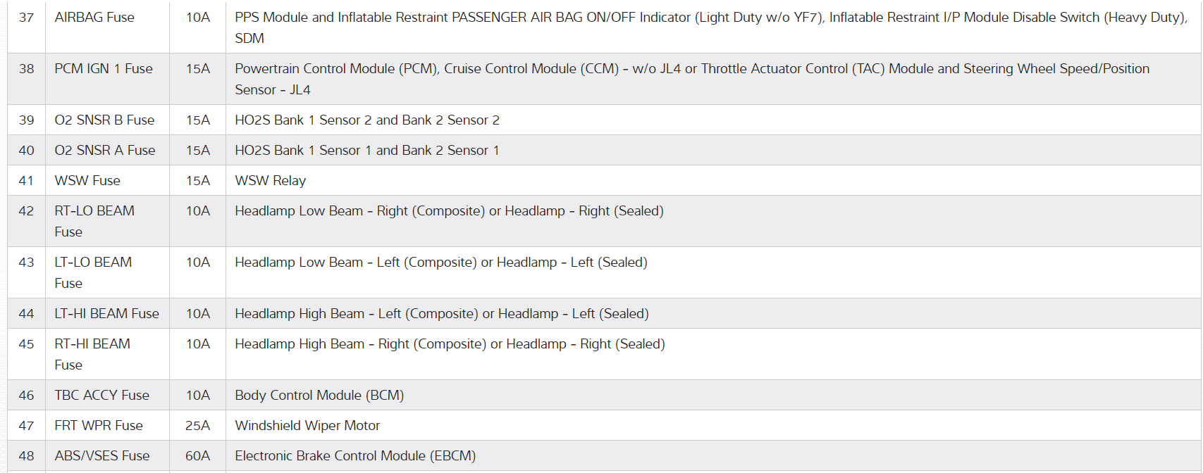

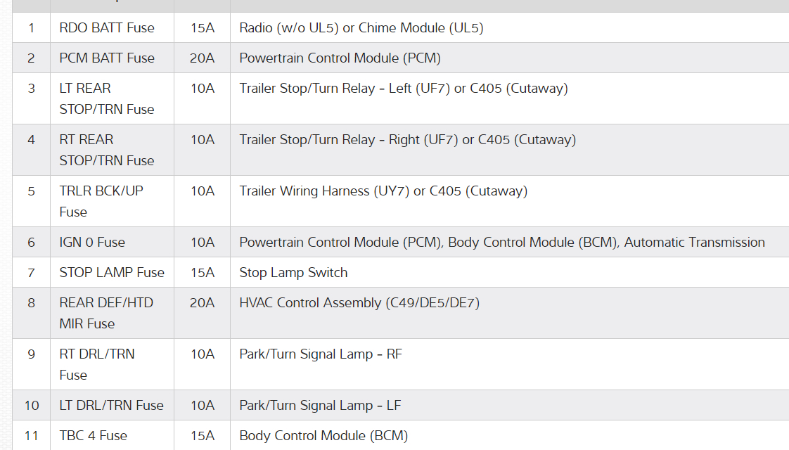

Can you try the scanner in another car to confirm the scanner operation? then lets check the ALDL fuse #30 in the under hood fuse panel. here is a guide and the wiring diagrams so you can see how the system works and the fuse location:
