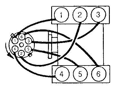

Will not start. may have mixed up firing order when changed plugs and wires? How do i get codes without scanner tool?

1-4-2-5-3-6 distributor rotation: Counterclockwise.
Oct 22, 2017 at 10:18 AM
PATENTED_REPAIR_PRO
  • 1,853 POSTS
Here is a diagram:
