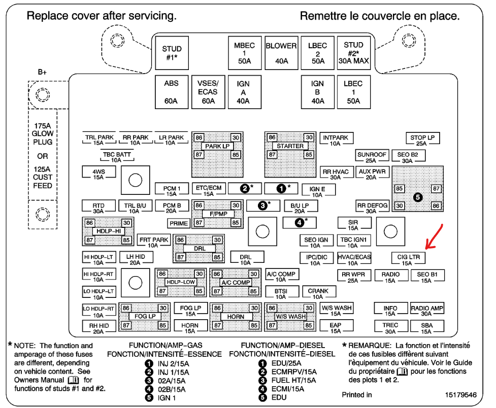

Why won't my scanner link to my truck?
Jul 8, 2024 at 8:02 PM
Experienced Mechanic
55,561 POSTS
The scanner is powered by the cigarette fuse, that is the first thing I would check.
Here is a guide to help you and the fuse location as well:
Check out the images (below). Let us know how it goes.
