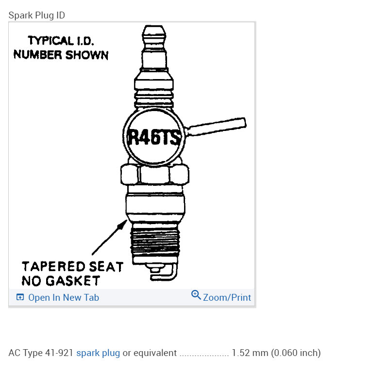

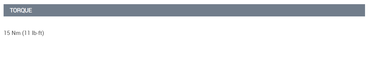

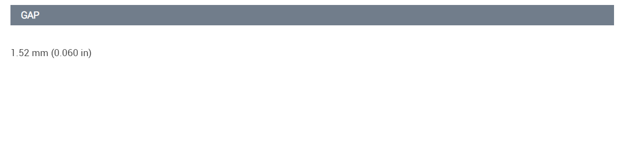

Hello, cylinder misfires can happen for a number of reasons. If it's been a while since it had plugs and wires you can start there, clear out the codes and see if any come back. These are known for their Ignition coils packs going bad, you can also add some fuel treatment to a full tank of gas, which will help to clear up the fuel injectors. They will clog up over time. If your scan tool has a live data function, look to see what the long and short term fuel trim numbers are at. They should be as close to 0 as possible. But plus, or minus 10 percent is about average on an older vehicle. Hope this helps some. I'll post the type of spark plugs it takes if service information lists them.
Here's the spark plugs type, gap, and torque spec. These don't have a crush ring, so don't over tighten them or they can break off in the cylinder head.
