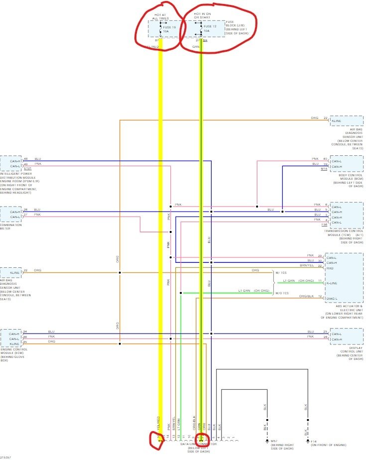

scan tool connector?
18,000 MILES • 2.5L • 4 CYL • 2WD • AUTOMATIC
PECAN
no 12 volt t0 pin 16 will not communicate with emc.
May 6, 2024 at 7:43 AM
STEVE W.
  • 15,411 POSTS
The first items to check would be the fuses. Those are fuses 12 and 19 in the fuse panel under the left side of the dash. 12 sends power to other items and to pin 6 while fuse 19 powers only pin 16.
