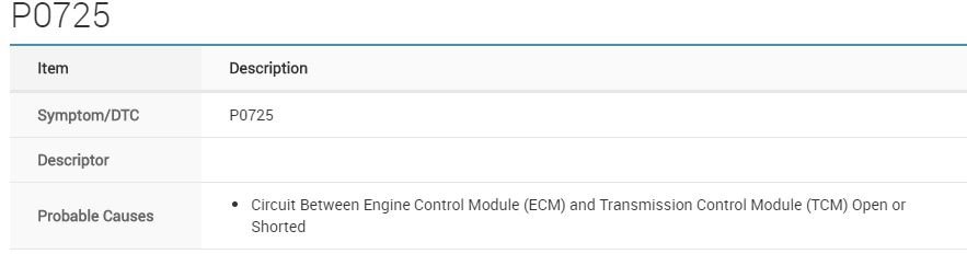

Scanned computer/ECM got a code said speed sensor circuit -PO725 what is this?
Dec 23, 2017 at 4:28 PM
Good morning my name is Roy and I will assist.
The code is for engine speed sensor. It is a circuit issue between the engine control module and the transmission control module. there may be damage from the way the harness is run or it could be a connector that has either a bad connection or damaged pins from exposure to the outside elements.
Attached is the possible cause listed for this code.
