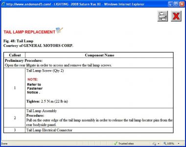

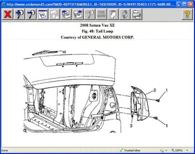

how to change a brake light

theres the replacment instructions let me know how it goes.
