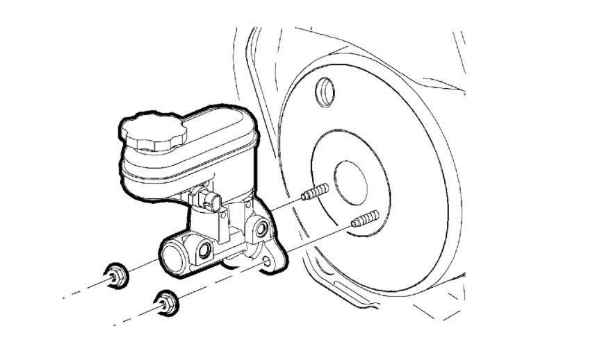

the person who changed my oil-put power steering fluid in my brake reservoir to top it off. When tested the brake fluid contained 4% of the contaminant. My question is how can I change out my brake master cylinder?

I attached the procedure below for you for the replacement but you must bleed and flush the entire system of all the fluid.
https://www.2carpros.com/articles/how-to-replace-a-brake-master-cylinder
https://www.2carpros.com/articles/how-to-bleed-or-flush-a-car-brake-system

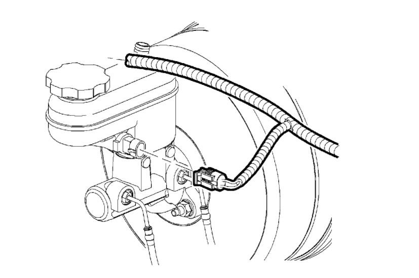

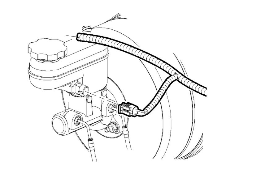

1. Disconnect the electrical connector from the brake fluid level sensor.

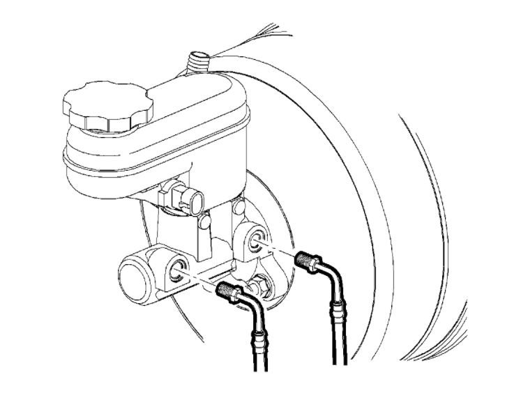

2. Disconnect the brake pipes from the master cylinder.
Important: Install a rubber cap or plug to the exposed brake pipe fitting ends in order to prevent brake fluid loss and contamination.
3. Plug the open brake pipe ends.
4. Remove master cylinder mounting nuts.
5. Remove the master cylinder from the vehicle.

1. Bench bleed the master cylinder.
2. Install the master cylinder to the brake booster.
Notice: Refer to Fastener Notice.
3. Install the master cylinder mounting nuts.
Tighten the master cylinder mounting nuts to 25 N.m (18 lb ft).
4. Remove the plugs from the brake pipes.
5. Connect the brake pipes to the master cylinder.
Tighten the brake pipe fittings at the master cylinder to 18 N.m (13 lb ft).
6. Connect the electrical connector to the brake fluid level sensor.
7. Bleed the hydraulic brake system.
