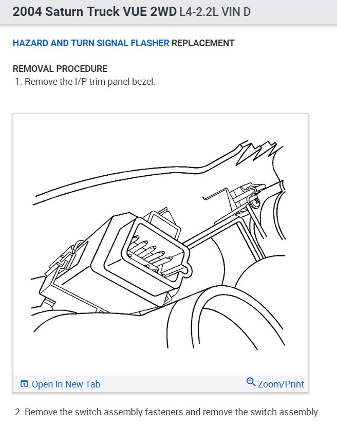

My turn signal work one day and then not the next and back and forth. I was thinking there is a turn signal flasher on this as I remember the older cars used to have them. No one can find a part. Is the flasher built into the hazard switch in the dash and I need to replace that or could there be another reason. There are no relays for the turn signals and the fuse is good.

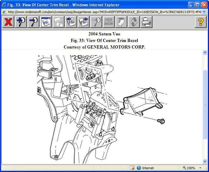

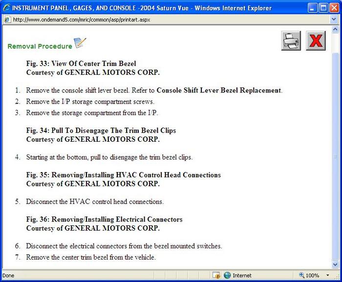

They have the hazard flasher which is the turn signal flasher that goes out all the time here is ainstrions below on how to change it out. It is behind the instrument cluster bezel. Check out the diagrams (Below). Please let us know if you need anything else to get the problem fixed.

how do you get the dash cover off that hold the four way flasher off to put the flasher back in to place it came loose and sliped in th dash

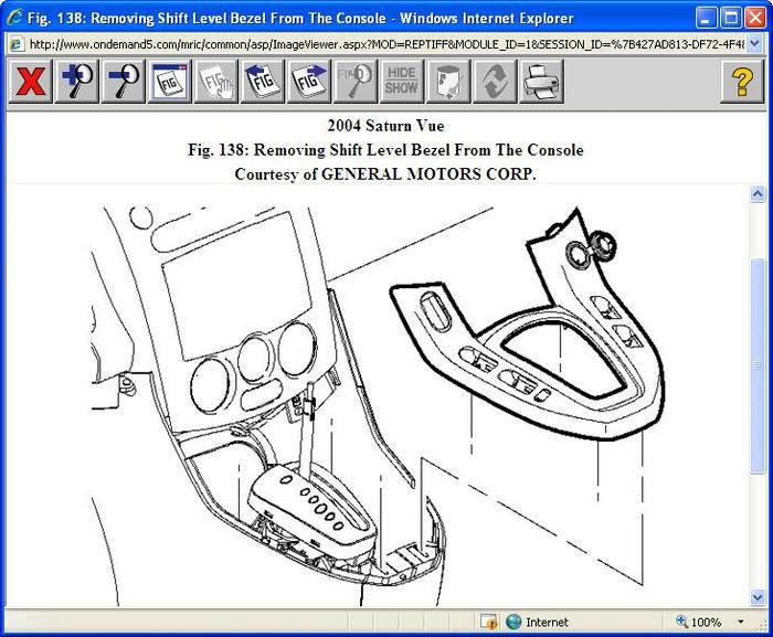

I posted how to remove the radio bezel just to give you a head's up the reason the hazzard switch fell in is because the plastic sleeve that hold's it in place is broken.Before you take anything apart go to the dealer and get a new plastic sleeve to replace the broken one.
