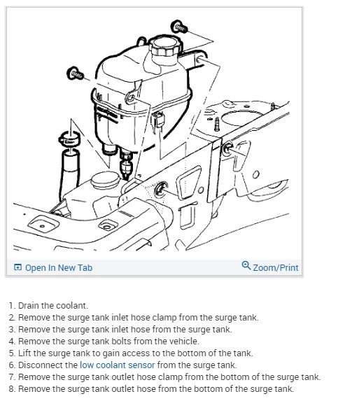

My coolant light has come on. I put coolant in but the light is still on. I don't see any leakage. What could be the problem/ the temperature gauge is not moving up. It seems like the engine is not overheating.

Low coolant level sensor is most likely faulty, be sure to replace the level sensor and not the coolant sensor in the engine. They are two entirely different things
See the diagram below for location/instructions to get to the low coolant level sensor

Low level coolant light is on the dash, but coolant is correct and temp is fine.
I figure I need to change the coolant level sensor. Anybody have a part number for this sensor. 2003 Saturn Vue, AWD, 6 cyl.

Before you go changing it why don't you unplug the sensor and jump the connector to see if the light turn's off?
