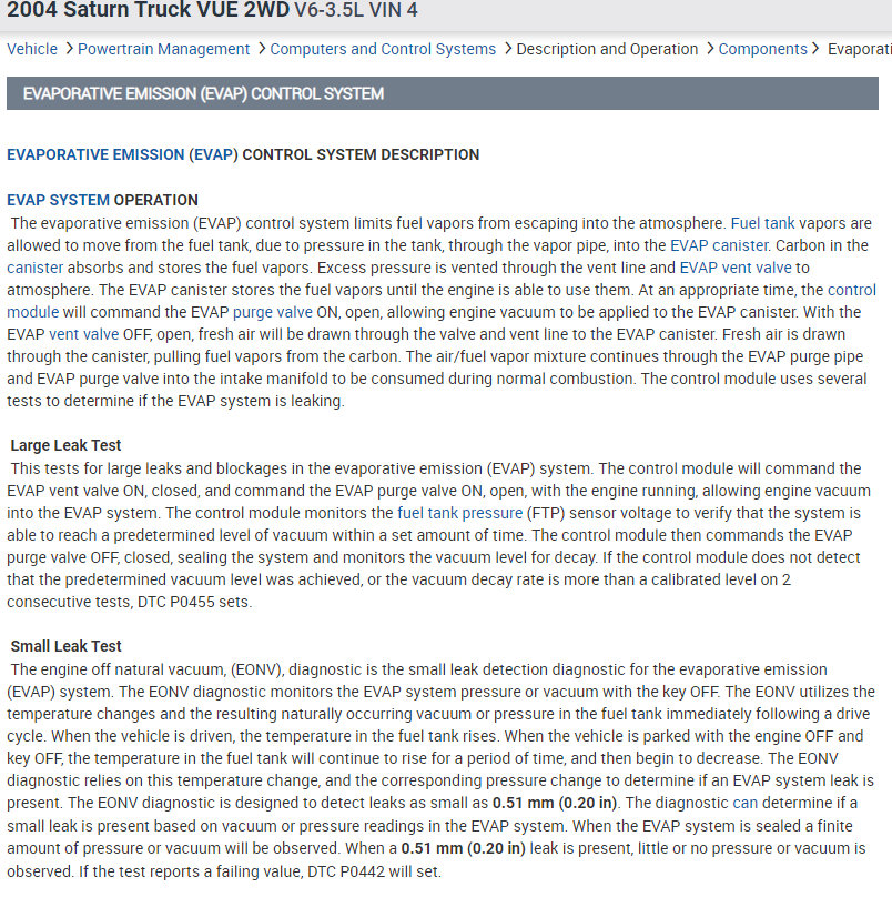

I put the truck on a little machine and it said large air leak but I don't see from where I checked hoses and I am trying to seek help

Is the check engine light on? Do you know the codes?
It could also be a leak anywhere in the evaporative system, which could include the fuel tank or a faulty hose.

I have attached a basic diagnostic procedure for EVAP.
