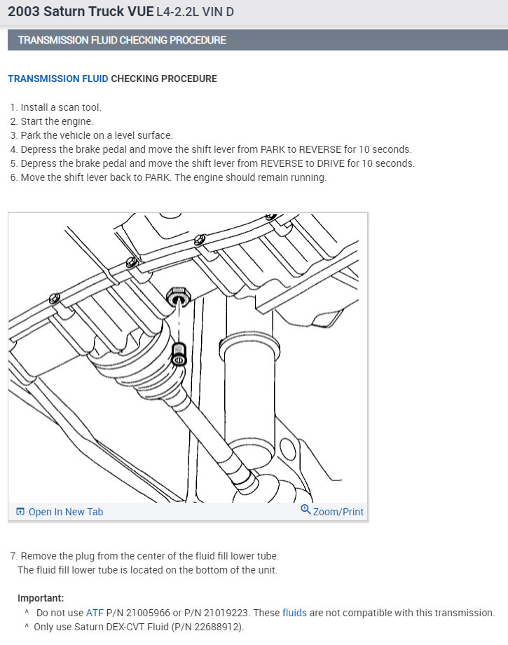

Where or how to put transmission oil additive ? There is no dip-stick with this car.
Jul 7, 2008 at 4:17 AM
SQM
  • 6,383 POSTS

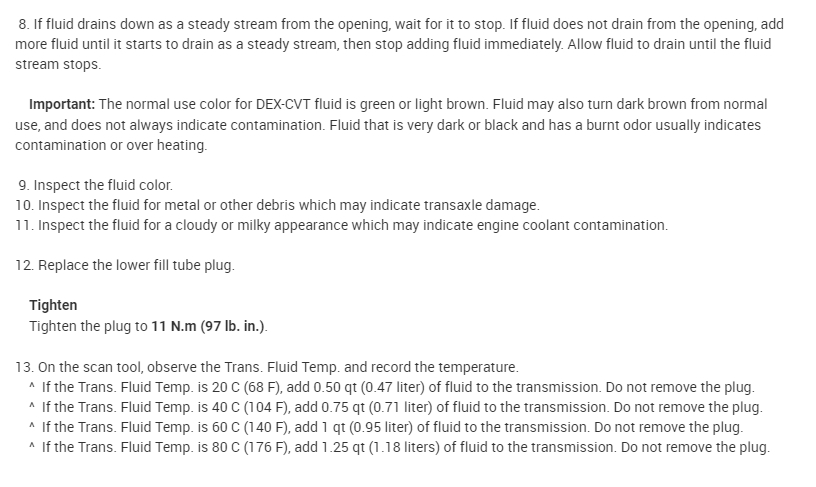

The transmission check and fill plug is located on the side of the transmission.
In order to check or add any fluid you will have to access the top plug located in the transmission housing.
Correct fluid level is right at or just little below the fill plug.
https://www.2carpros.com/articles/how-to-check-and-add-transmission-fluid
I have attached the fluid checking procedure below.
