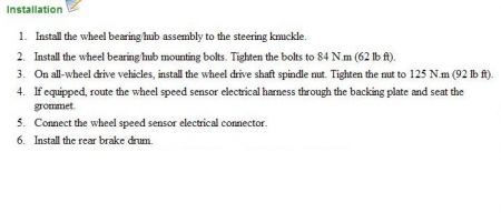

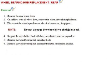

2003 Saturn Vue Rear wheel bearing replacement
2003 SATURN VUE
GERRIT
Drive Train Axles Bearings problem
2003 Saturn Vue 4 cyl Two Wheel Drive Manual
How to replace rear wheel bearing
Sep 24, 2009 at 5:04 AM
BLUELIGHTNIN6
  • 16,542 POSTS
https://images.2carpros.com/forum/automotive_pictures/261618_Noname_1012.jpg
https://images.2carpros.com/forum/automotive_pictures/261618_Noname2_285.jpg
