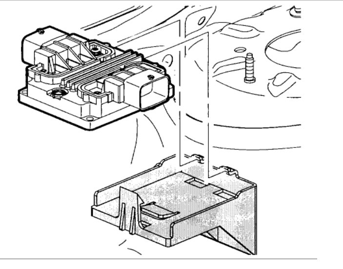

Transmission problem 6 cyl All Wheel Drive Automatic

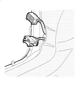

Transmission Control Module Loop code? Is this a relay problem or a sensor problem and how do I repair it?
Jul 2, 2009 at 9:24 AM
BRIAN 1
  • 1,030 POSTS
The instrument panel/body inline connector,located behind the left hinge pillar garnish molding, may have bent or corroded terminals.
https://images.2carpros.com/forum/automotive_pictures/147643_connector_1.jpg
check this first,and post back with what you find.

Where is this?

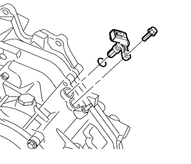

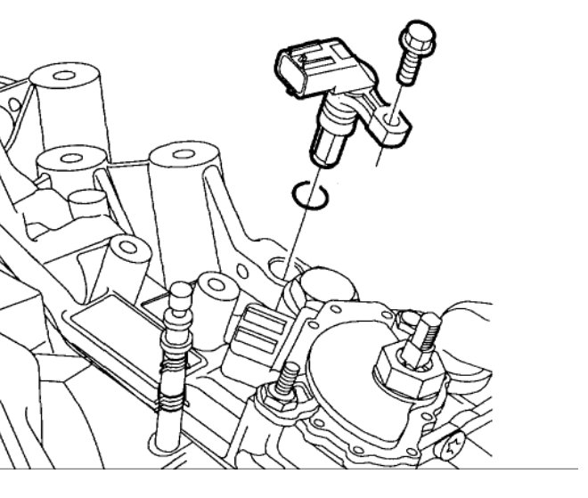

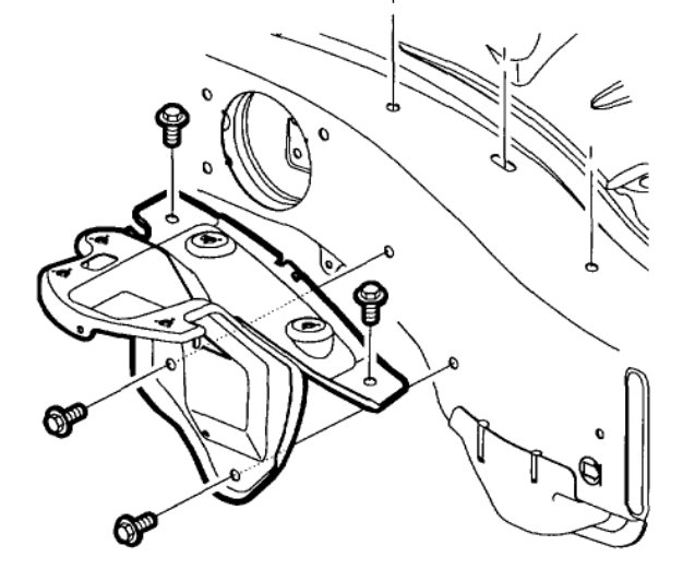

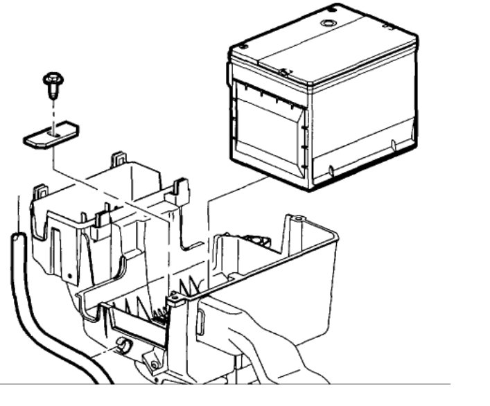

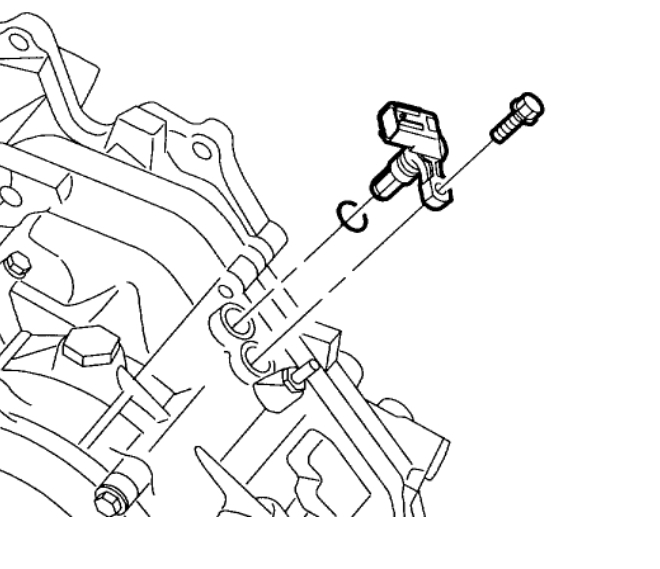

This code is for the transmission input and output speed sensors. Here is a video that show the speed sensors being done.
https://youtu.be/f3bETtCIdxM
Different car but you get the idea.
You can run the codes by follow this guide.
Here is how you do it on your car. (below)
