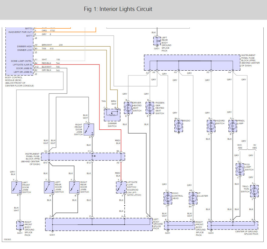

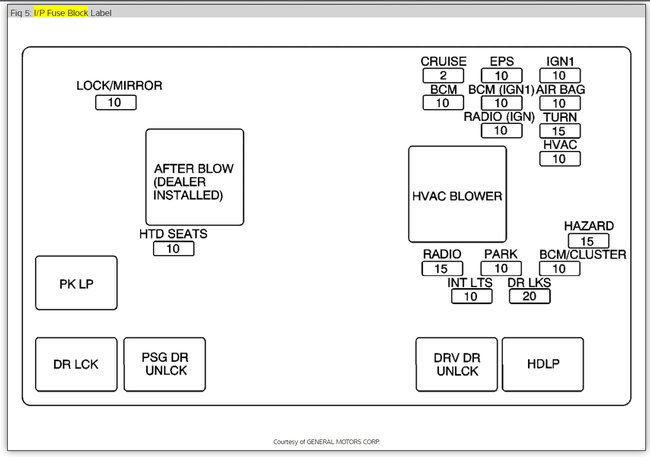

I have an 03 Saturn Vue, about 3 weeks ago my dash lights went out and now my tail lights are out. I have blinkers, hazards, brake lights, head light, DTR, reverse lights, everything else works. What could be the problem?
Aug 10, 2010 at 7:06 AM
  • 55,616 POSTS

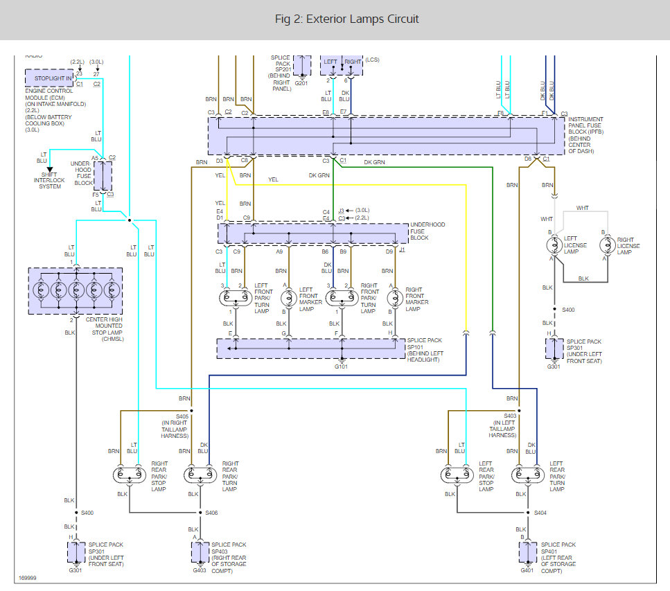

There are 4 fuses that run the system I would check all of them to start. Then I would cycle the hazard switch become the contacts get a little corroded which will make the lights not work.
Here are some guides that will help you get the tail lights.
Also I see the BCM controls these circuits to test for power output there to confirm the BCM failure.
Please let us know what you find. I'm interested to see what it is.

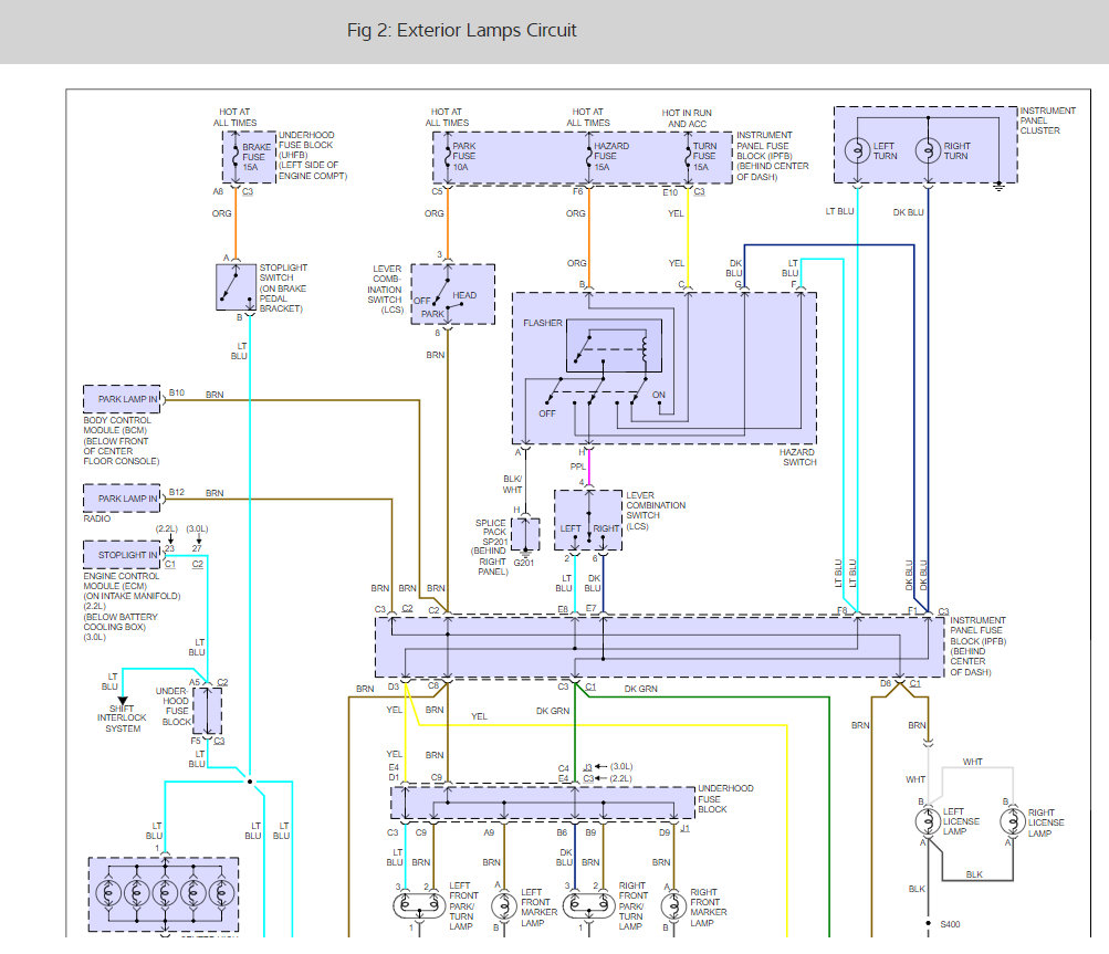

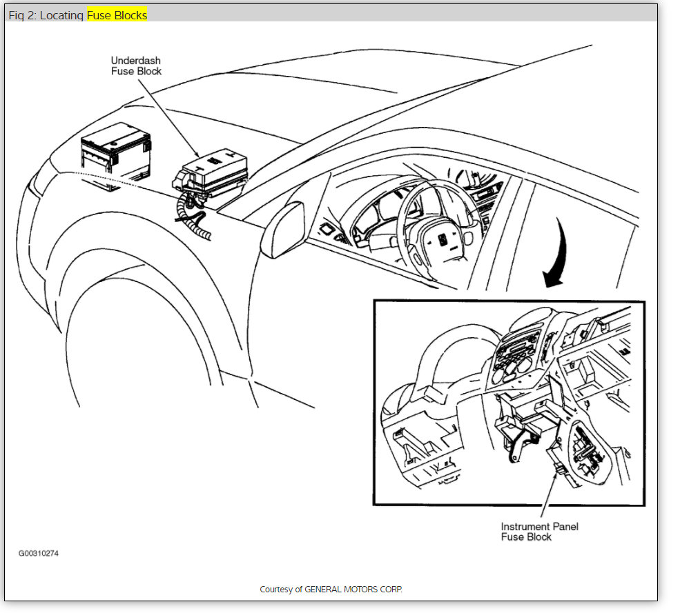

ok here is the issue, dash lights and tail lights quit working on the car but brake lights and reverse still work thinking it is a fuse but dont know where to look for it
Oct 18, 2017 at 9:45 AM (Merged)
STEVE W.
  • 15,385 POSTS

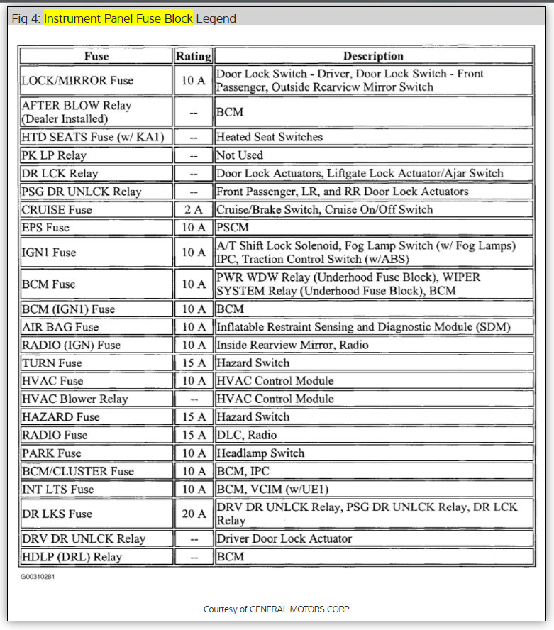

Check the Park Lamp fuse (10A), in the fuse panel in the middle of the dash. It powers all the marker lamps if that's okay The BCM is bad
GIUGGIOLA
Thanks for this post I had this problem and had to replace the PARK fuse.

welcome to the forum. Did you use a testlite on the parklamp fuse, there should be voltage? You may need to check the voltage feed to and from the combination switch. If that checks out, I suspect the combination switch or wiring in steering column.
