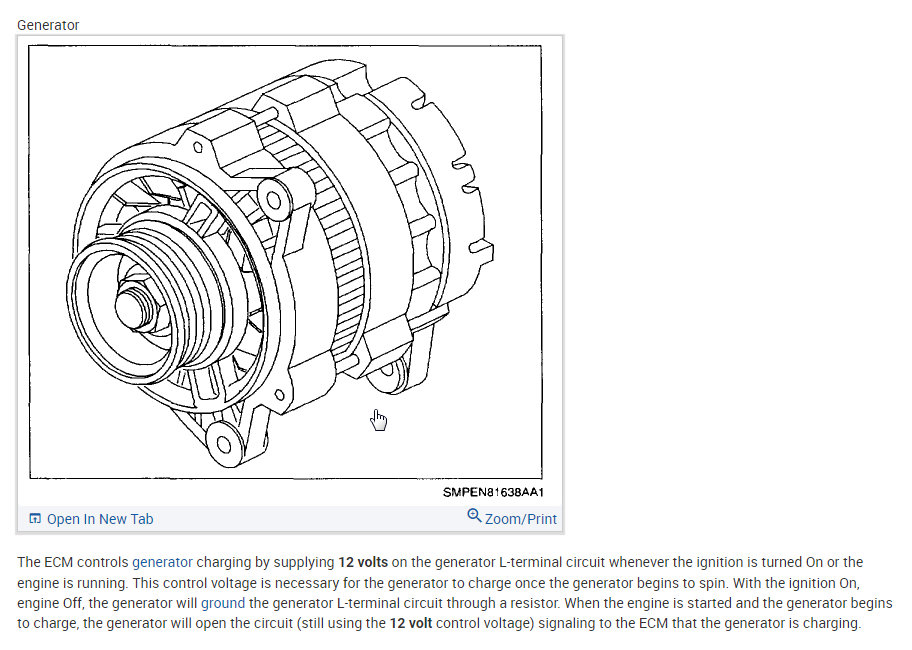

We first need to find out how they tested it. Here is a guide on how to test the alternator:
I suspect the voltage regulator is the issue which is part of the ECM. Take a look at the info attached.
We need to monitor the voltage on the battery when the engine is running. However, before you replace the ECM you need to load test the battery.
Here is a guide on how to do that:
Let us know what questions you have. Thanks
