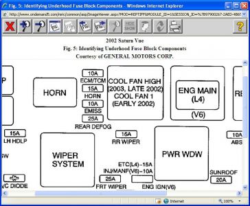

Please help me find the horn fuse.

The horn fuse is in the under hood fuse box between the horn relay and the cooling fan relay as seen in the diagram i posted.
Follow the guide below on fuse replacement and testing
Please run down these guides and report back
