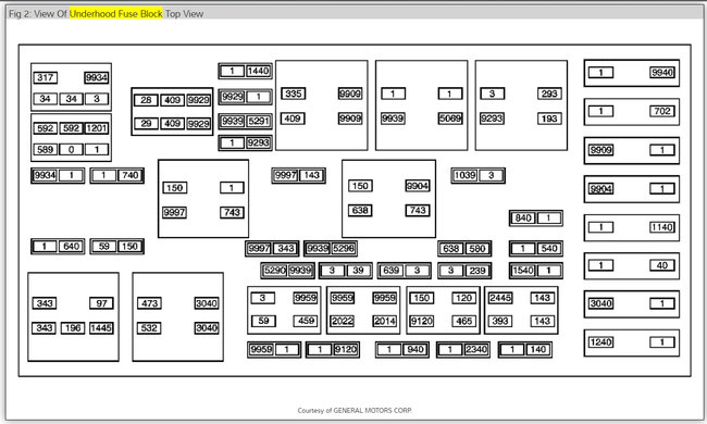

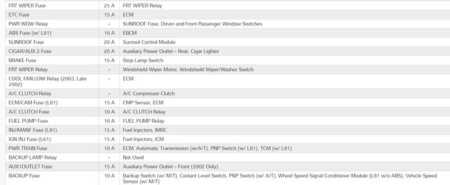

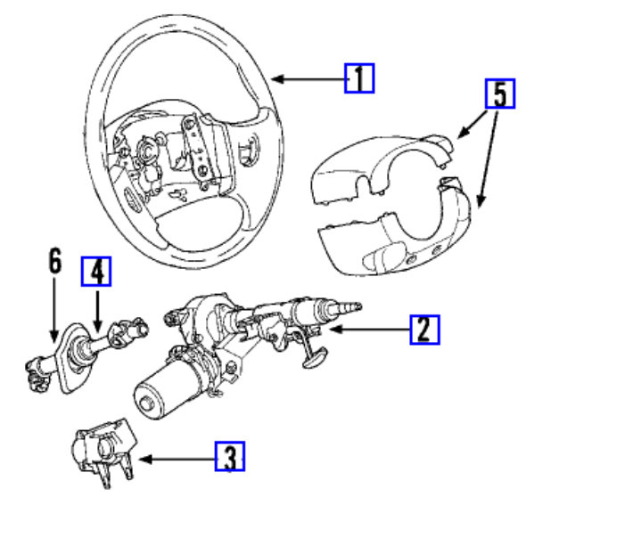

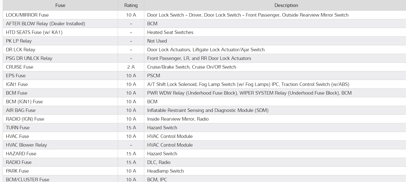

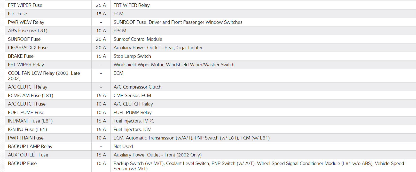

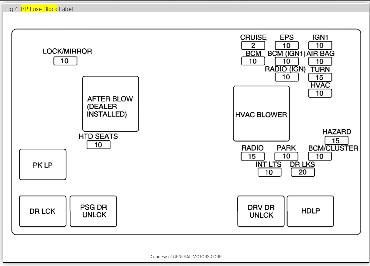

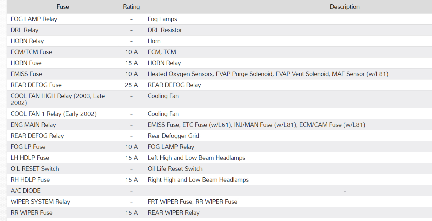

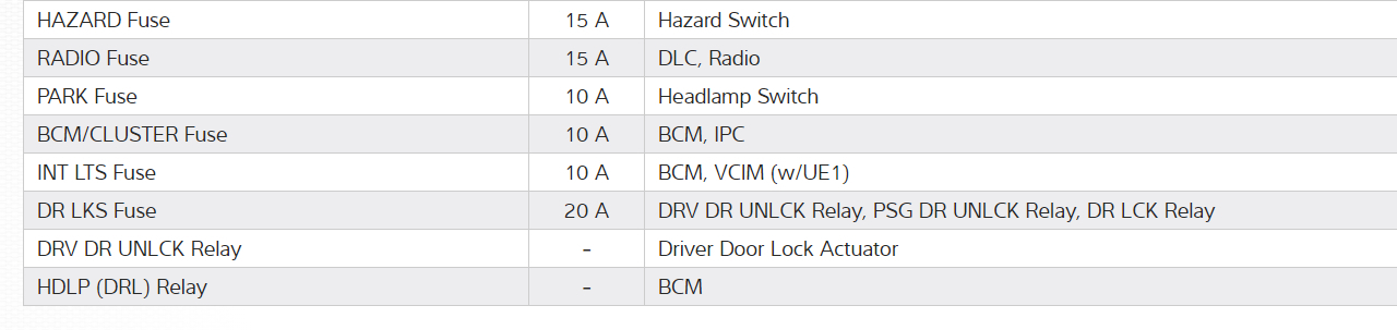

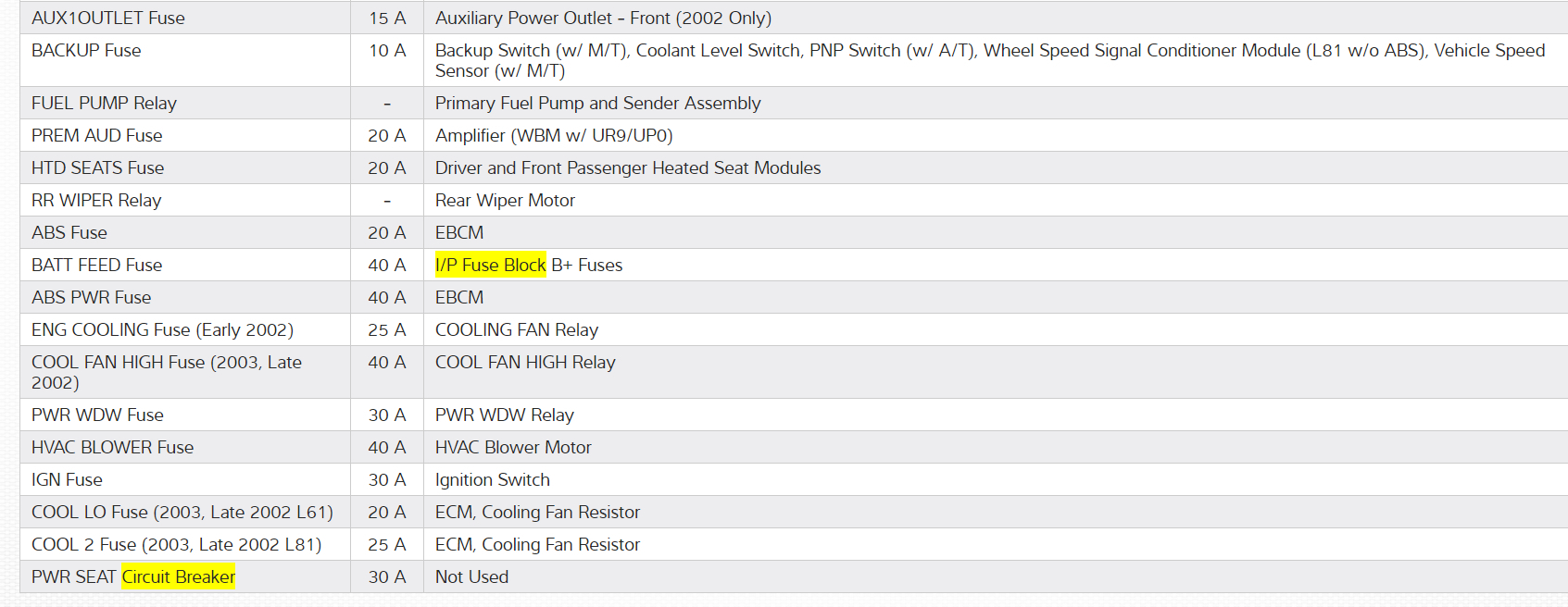

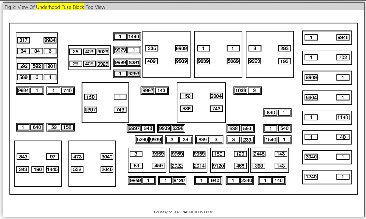

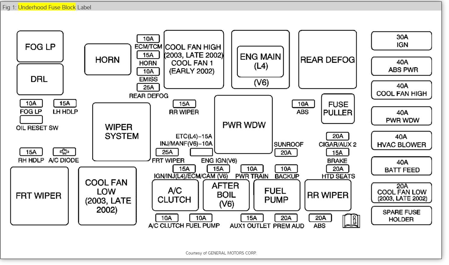

It sounds like the EPS module is going out becasue there is only two fuses and a controller with a motor that makes up the system. The motor supplies the power steering. But you should check the fuses just to be safe. Here is a guide on how to do the test.
Here are some diagrams (below) that show you how the system works and where the fuse panel is with what fuses to check.

Here is the fuse I thought might be causing the problems.
https://images.2carpros.com/forum/automotive_pictures/55316_02vuefusebox_1.jpg
Replace the fuse with a known good fuse. If the problem continues, the problem may lie within the electronic power steering module. Located at the steering column. Unfortunately, diagnostic for the system is not available.
