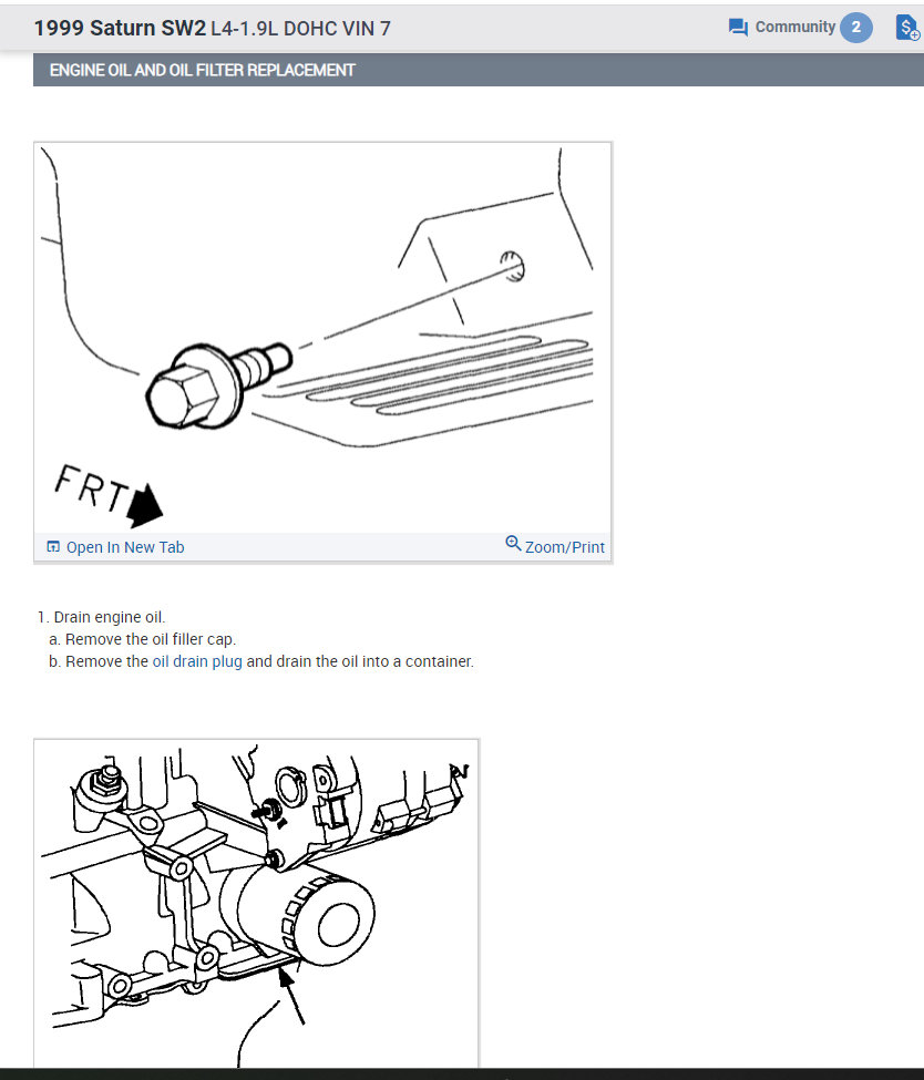

It is past time for my oil change and I had been getting them per my maintance schedule. Now that my Saturn dealer has closed, I'm thinking about doiing it myself. Does my car have a sensor or any other thing that I could be concerned about before I attempt this?

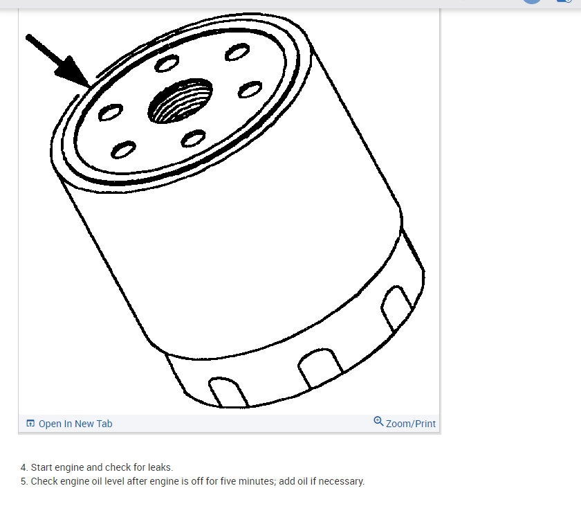

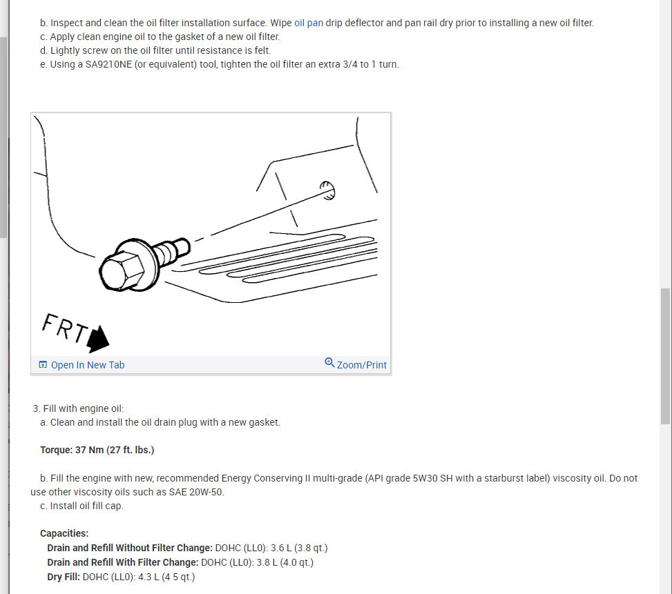

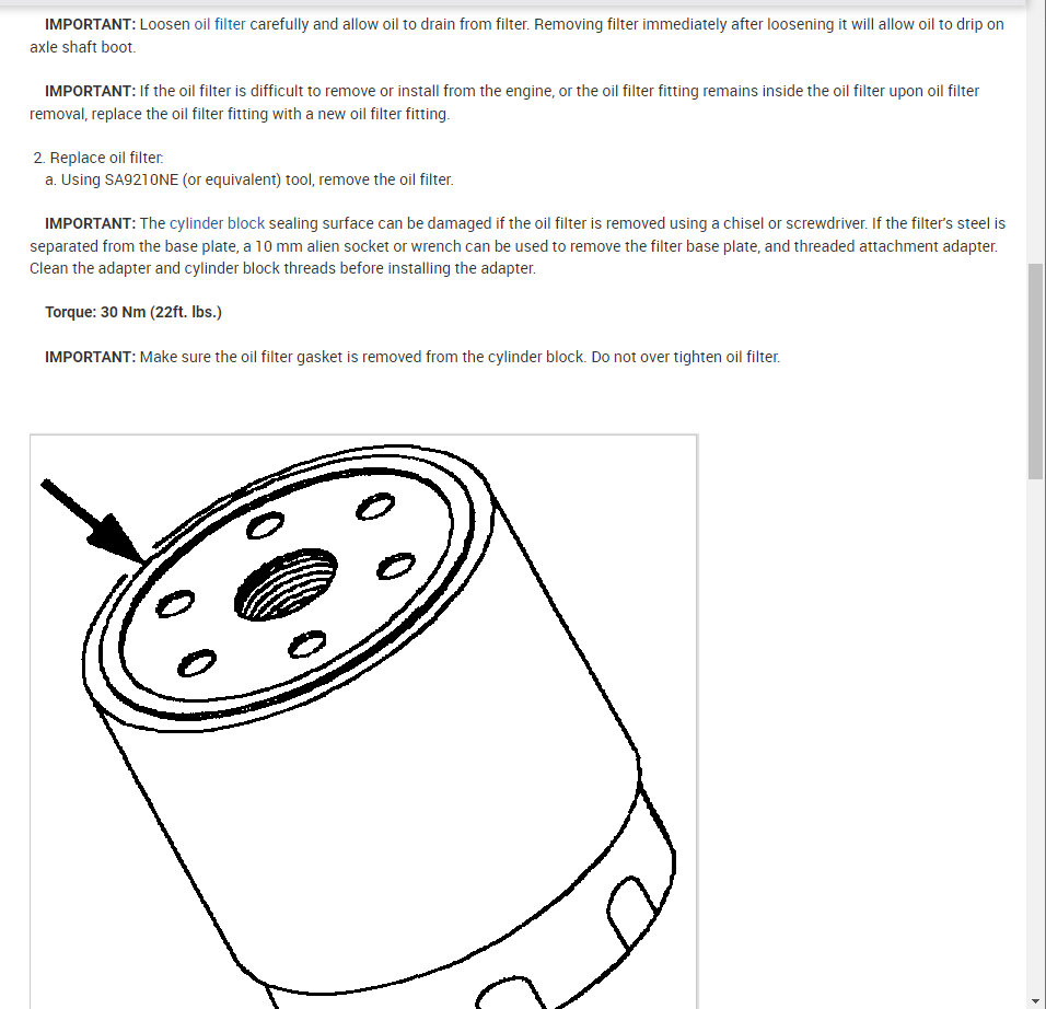

Below is the process from the manual that will give the specifics needed to complete this.
Please let us know if you have other questions. Thanks
